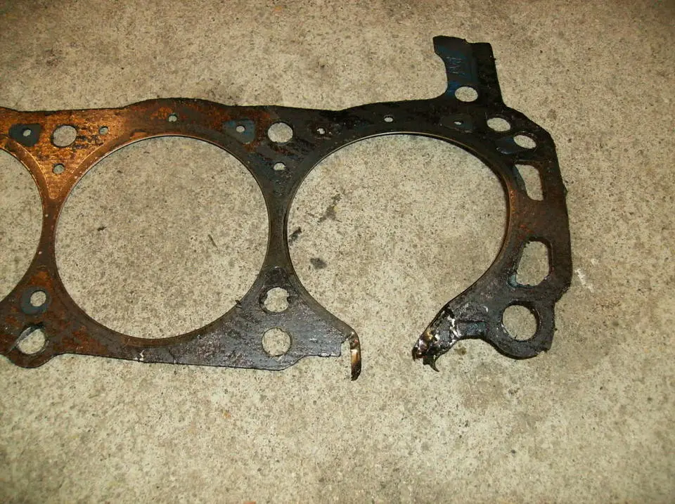

Ripped my head off, surprisingly it all looks good, no visible damage, haven't had it checked for straighteness yet. Weird how the gasket blew, all the arp bolts were torqued. Just gasket failure under boost I guess.
No that gasket is blown from severe detonation. Could the possible root case be a cracked intake causing lean condition to this cylinder? How does a super charged cracked intake cause a lean condition? When fuel is fed to that cylinder by the injector in that port, at the same point the intake cracks causing boost to escape thru the crack causing reversion of the charge in that port that starts to carry fuel the other direction creating a lean condition. Just a thought.

I could see that but everything looked secure when I unbolted the intake and it's just an ear, so I doubt that it caused a leak. It was probably from me lifting off the intake at a weird angle because the ear in question uses a stud not a bolt. There are no signs whatsoever of any type of head damage. Interesting point though.

So whats the plan? MLS head gaskets, studs etc?
Don't plan on running a MLS gasket unless you have your block re-surfaced. They don't take well to a rough or uneven mating surface.
this is true, MLS gaskets require a surface of 50 RA or better to seal right. I used them on my motor without resurfacing it, but that was only because i had other issues with the way my block was o-ringed and the MLS gaskets were my last shot before i went and pulled the motor and had it decked. Luckily the gaskets did the trick.
I think for you MLS gaskets would be a terrible idea, since you had a ton of passes on the car there is obviously some reason you blew the gasket, if you put the MLS gaskets on there and this happens again say 10 passes down the road its not going to be an easy fix, your gonna burn up a piston. You gotta thing of the head gasket like a fuse, I'd rather blow a gasket then burn up a piston.
What was the temperature difference when you dynoed the car and when you blew it up? The air can really mess with the air/fuel ratios and i remember reading about a few guys with lightnings who had thier trucks tuned in the summer, hammer on it for months with no problems, then in the fall when its 50 degrees at night time they hammer on it, it detonates and kicks a rod out of the motor
Also i dont think the cracked intake had anything to do with this problem, if anything it would have caused a vacuum leak
Hmm didnt know that. Dont see why they wouldnt seal though, i thought that was the purpose of a multi layer gasket
The purpose of a MLS gasket is to seal really well, but they require a much better prep in order to do so. Most machine shops want to know ahead of time if you plan to run a MLS gasket, because the "usual" finish they deck a set of heads with isn't good enough.
