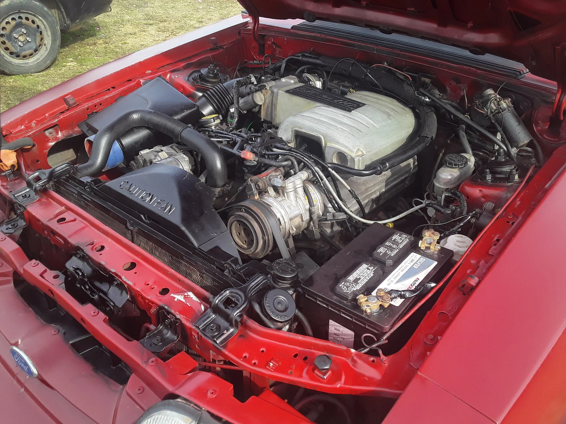

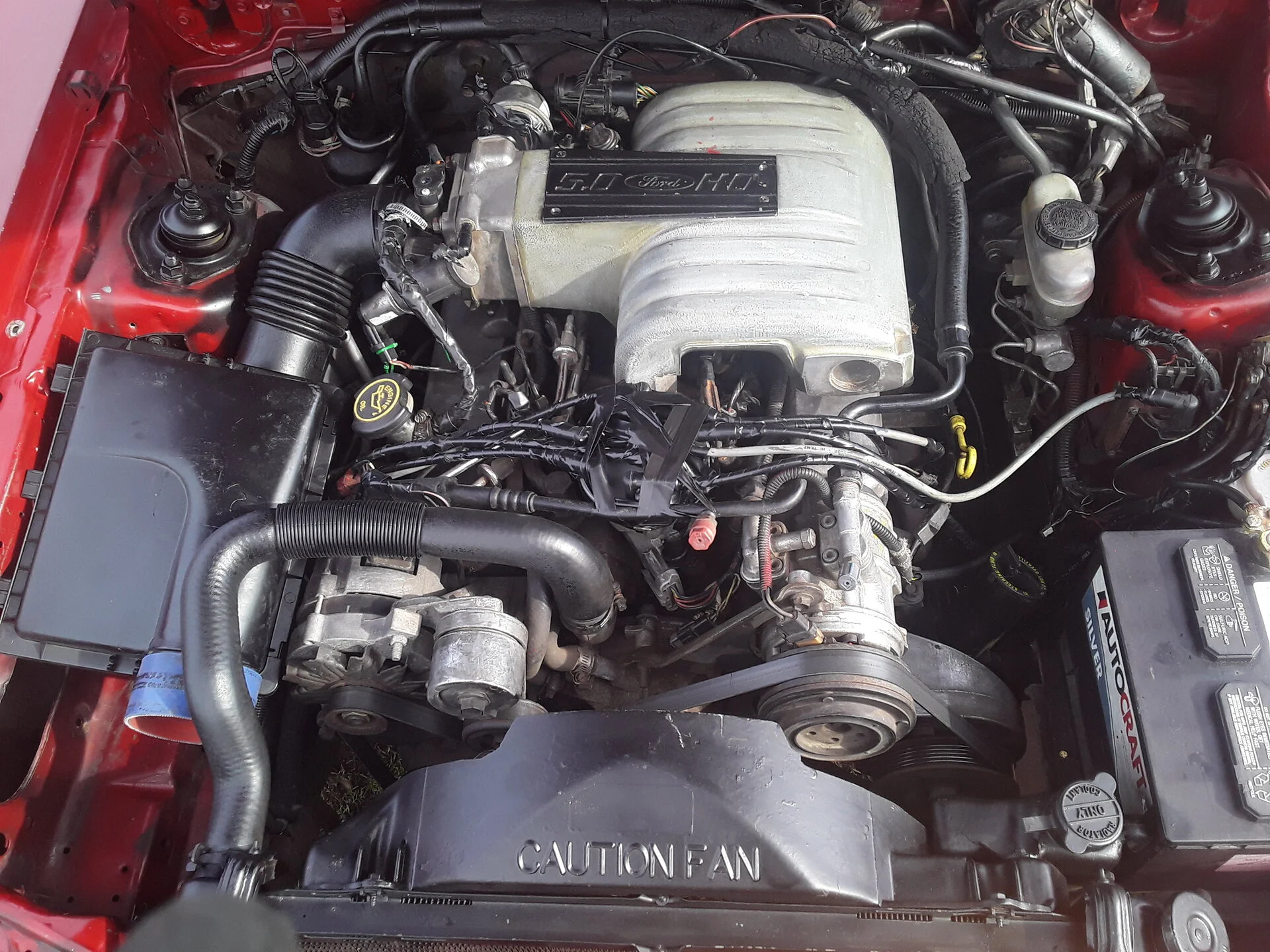

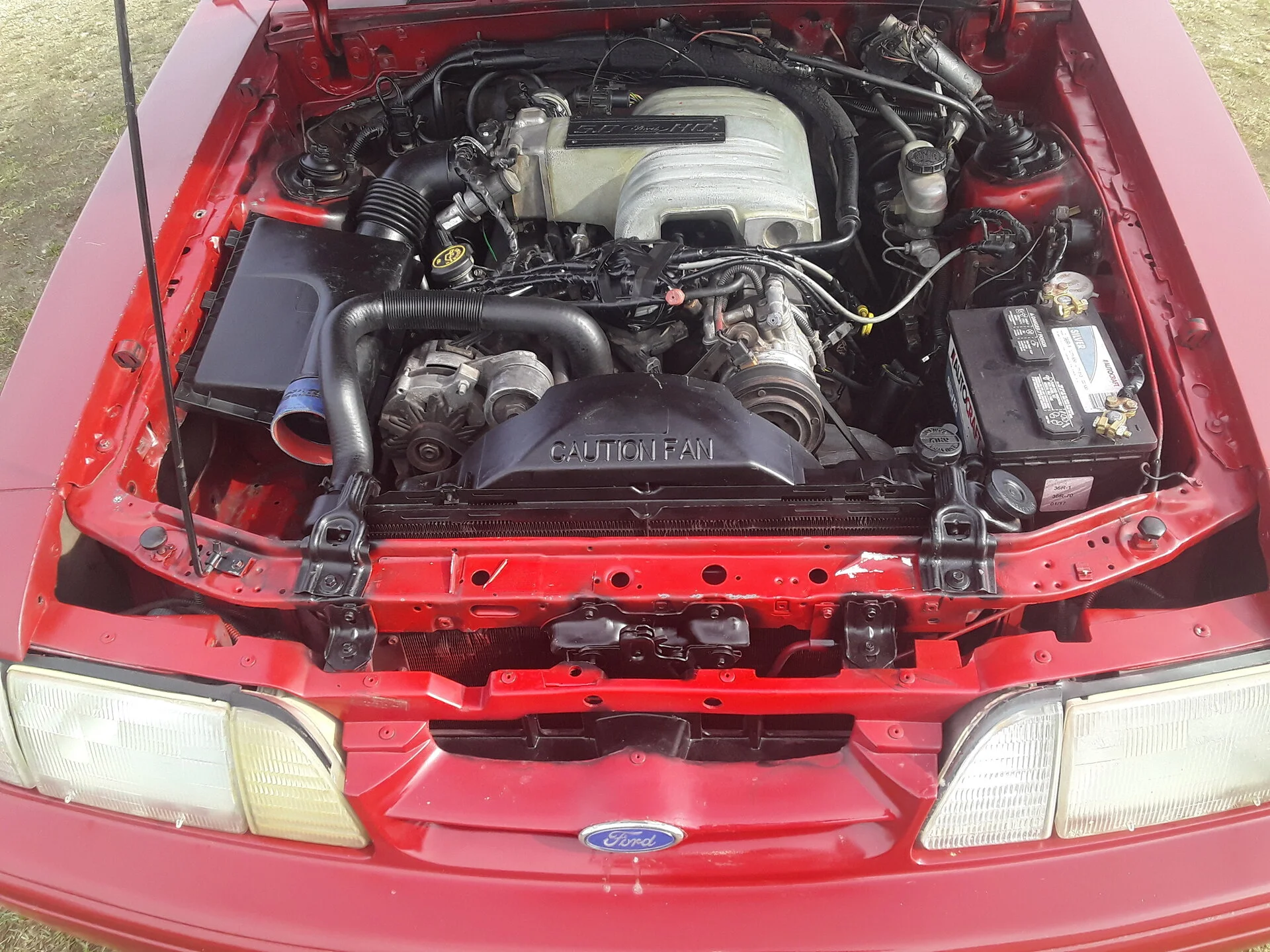

What's the deal with that airbox in the pic?

oof so personal but i have fixed my drivabilty issue... that air box is the facory box acting as an air dam and was my issue the whole time.. no manual will tell you that... and i do research online... every night... and yes sometimes i may ask ehat seems like stupid questions but im not a mechanic.. just a 30 year old guy that needed this car running right.. yes it was a mistake to buy a 30 year old mustang and expect it to not be messed with and thrown together but it was only 1400 and made 500 off of extra parts.. and the 140 mph dash to my knowledge only was made for the 89 gts i believe 87 annd 88 was stock 85 mph.. if you take a 90 to 93 140 mph dash it will work but your guages wont work look up 87 to 89 swap to 90 to 93 on google... btw my block is a roller with flat tappet cam and that was the firing order problem.. look up fixin foxes on youtube i have recorded everything ive fixed got like 15 vids to edit together lol but my car is 110 percent fixed... that being said i have being being more active and will continue to be cuz ngl this is imo the most relieable car i had.. mainly cuz only one i could google and or ask fb or forums whats wrong with my car it go vroom vroom suppose to go vrrrrom vvvrrroooooooom berkkkkkkk lmao i do appreciate everyones help
