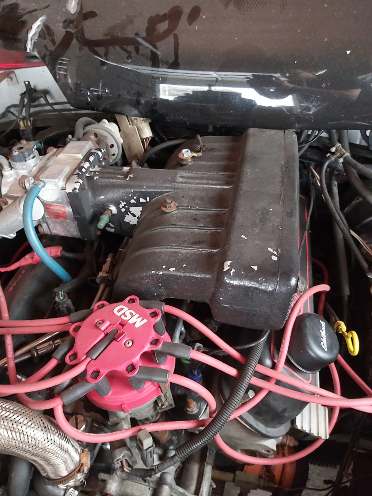

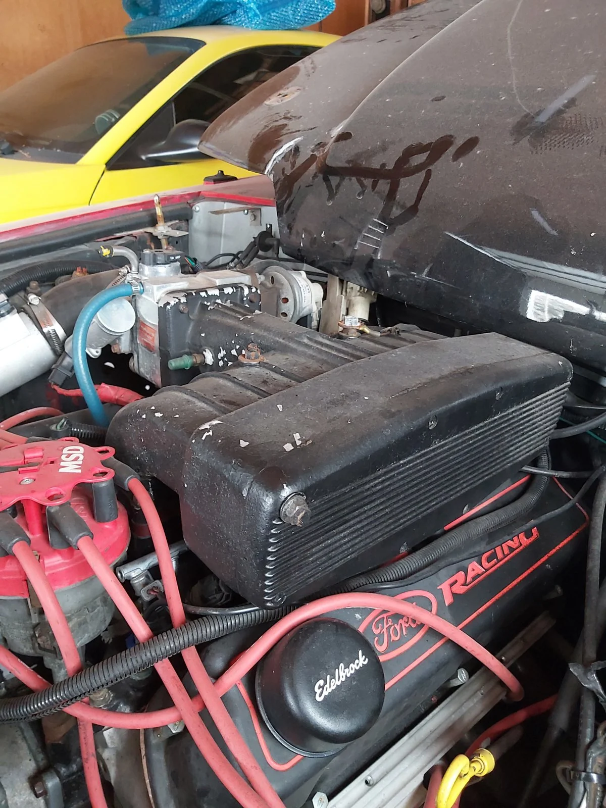

Hey guys i have a 91 fox lx and im trying to decide what intake i should run to get the best results. Its a 306 with full forged bottom end aluminum edelbrock heads b303 cam and a whole bunch of other things. I am running an intercooled p600B procharger on the car also. I have no clue the make of my upper and lower intake or if its been ported at all. What im trying to decide is if i go with a 2 piece upper and lower intake or a 1 piece edelbrock intake with an elbow to give the best and most air flow.
If it's a street car you want a two piece style intake. The intakes with elbows are more for higher rpm track cars. They will work on the street but not as well in my opinion.
No sure the make but i know its not stock
