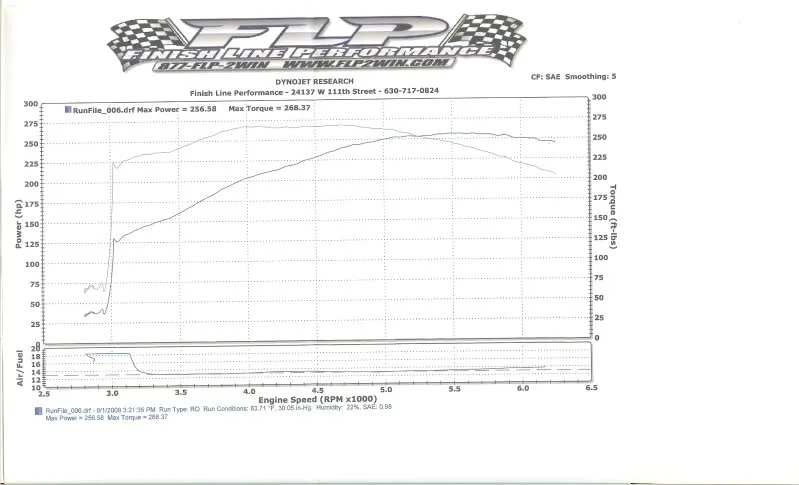

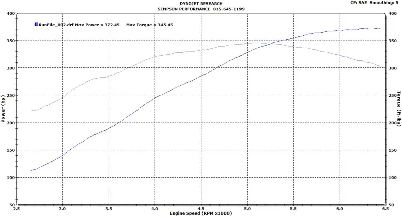

Here's my new dyno numbers. The graph is my new numbers. The only addition was the novi 1000 running an 8lb pulley. The second graph are my numbers minus only the paxton. (however convertor wasn't locked that run so the number is slightly low)

i would like to complain about only having 370hp lol. Do what makes u happy man. best of luck.
not complaining. Just want more and don't want to make a bad decision. Too many times in the past have I haphazardly bought parts one by one to figure out I should of done what I wanted to in the first place and saved myself a ton of $$$. :nice:
so are there hopes of the stock block living with the 480 mark and meth?
