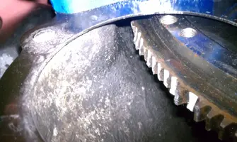

I have just installed a 351w in my 93 former 4 banger. I mated it with a built 92 WC T5. I installed a 157T 28oz Flywheel (because 351w uses 28 not 50 like 5.0). I used the same starter that I had installed when the engine had a C4 auto. My understanding is that the T5 and C4 starters are the same, correct?? The starter blew almost all the teeth off the brand new flywheel. I dont understand why this happened? The measurment from the engine side of the flywheel to the starter is 1". Am I some how using the wrong starter. Obviously this swap has been a nightmare thats going to cause me to get a divorce lol. Not only do I have to drop the trans again, but now I need to drop more $ on a new flywheel. Please help, I cant do this again!

Man that's messed up! (Just looked at pics)
I'd have to try and warranty that.
There is no way a starter should do that.
Are the teeth engaged when the starter is not engaged?
Was there something keeping the engine from spinning?
Even then, the starter shouldn't strip teeth. It would just engage and get hot, maybe groan a little. (At least in my experience)
I have never seen that...
The sad thing is I installed the motor and trans together and put it in the car. Waist of time and effort. The car is still sitting on jack stands, I only started it once. The only noise I heard when first trying to start was the starter gear hitting the flywheel. I tried to shim the starter with washers to try and get it to engage but it didn't work. Finally I rotated the crank a few inches and it engaged and started right up. I set the timing and then tried to start it again and all it did was free spin. I pulled the starter and this is what I seen. Everything is brand new. Starter,flywheel,clutch, rebuilt trans, and motor. This is supposed to be fun.

I pulled the flywheel and half of the teeth were completely gone. I just installed another brand new one. I put everything back together (flywheel, clutch, block plate, trans) and the dam starter still doesn't engage all the time. Sometimes it starts fine and then it sounds like its banging against the flywheel. I even returned the starter for another one. I'm completely lost and frustrated. its starting to not be fun anymore.
I think the best thing to do is call autozone and ask them what exact starter you need. I bet Summit would actually be a better choice because I am sure they have run into that before.
What application is your current starter for? How about the flywheel? Bellhousing? Have you verified alignment between the starter gear and FW?

Went back to autozone. After cursing out manager because he was accusing me of trying to return a starter just because the warranty was almost up, I was told not to come back lol. Went to advance auto, bought the most expensive 5.0 starter they had and guess what, it works like a champ. The autozone by my house is a joke. He took the starter and put it on a tester and said its fine. I told him the gear isn't engaging properly and he just kept rolling his eyes at me like I was some dead beat. It took every ounce in me not to slap the taste out of his mouth. Now I have a starter with a lifetime warranty and not that junk rebuilt crappy. Thank you everyone for the input!
