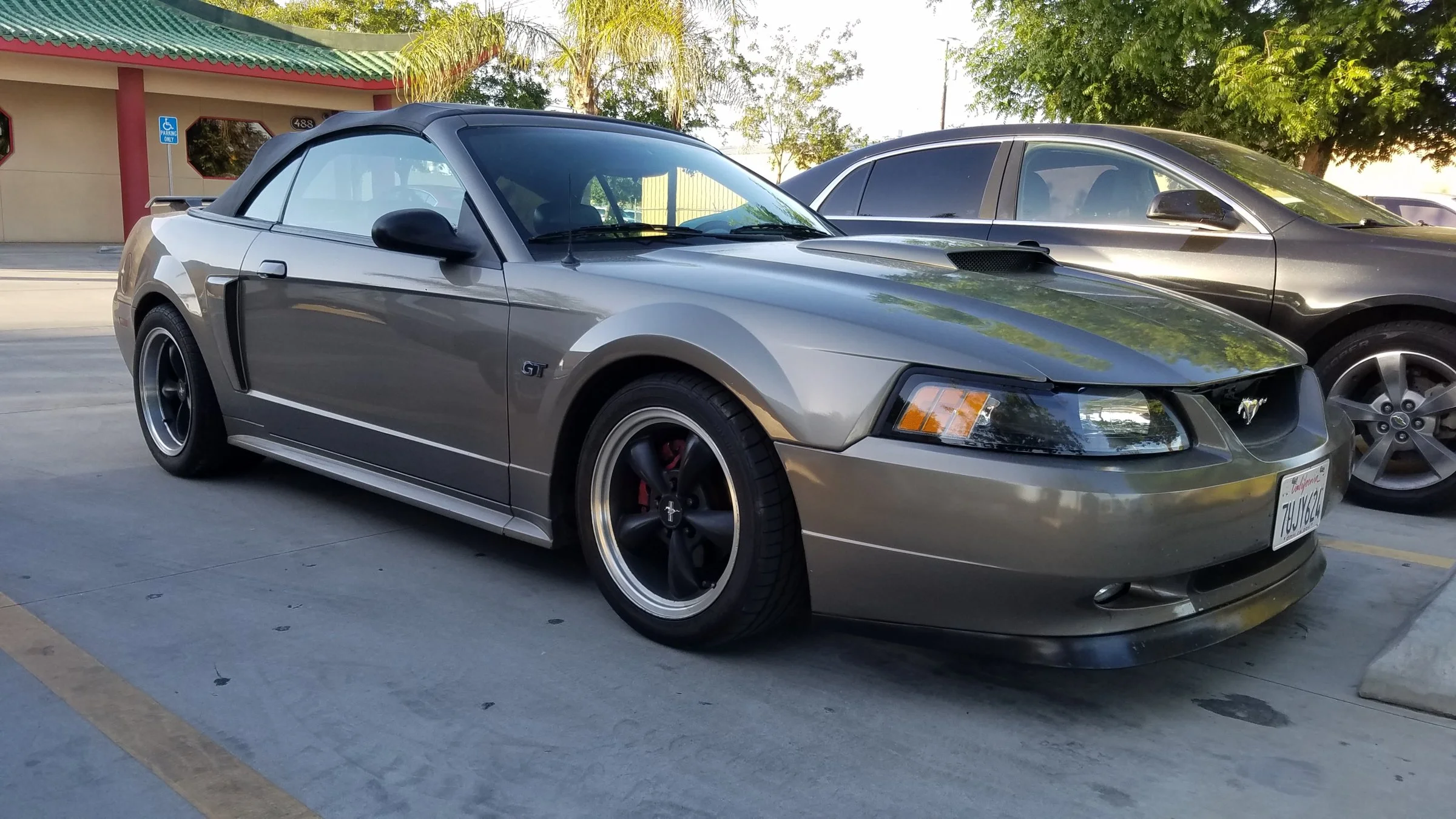

Hey guys and gals. New to the Mustang world. I just traded my daily driven 2007 Crown Vic P71 for a 2002 Mustang GT Convertible with 140k miles. I love the car, definitely a lot different car to drive then the P71 and my 2011 F150 Ecoboost. It has some hiccups (trying to figure out a cylinder 2 misfire code at the moment). But overall it's a very clean car for being 15 years old. Crossing my fingers that it's not something internal, only thing I have left to check out is the injector, looks to have a cheap non OEM replacement and funky connector spliced in.
