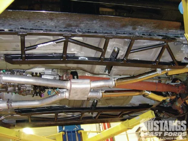

I agree on not worrying about making tons of power. An 11 or even 12 second street car is a lot of fun. In a fox body it doesn't take much more than 300 rwhp to get there and it would keep the car fairly reliable and streetable. If I were on a budget build this is what I would lean towards.
A 351w is a great starting point for a build no doubt. Seems overkill to me for only wanting about 400 hp (I always assume rwhp). Finding a good 351w seems to be difficult these days as there is somebody who keeps finding bad blocks @hoopty5.0 . Since this 85' already has a 351w swapped in it then you're ahead of the game. Make sure the engine is healthy and that the car is straight. Hopefully this car already has full length SFC's (subframe connectors), torque boxes reinforced, etc. Getting a 351w to 400+rwhp is still as much of a task as a 302. You'll still need aluminum heads, cam, intake, and a decent carb (assuming he 85' is not EFI) and more cubes.
The t-top chassis will twist more than a hatch so I suggest through floor SFC's like....
