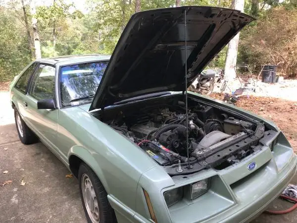

this is the car i did find. Im heading to go look at it after thursday

yea i would be painting it though lol dont really like that color option, but it is unique. But anyways..with all the feedback I've been getting from everyone, I'm going with some of the suggestions of just building a 302 motor around 350-400 which is cheaper than the 351 and build up the suspension and reinforce the undercarriage and brakes

that color is very interesting, "i" would leave it if it's in good shape.
I'd also agree that if it's already got a 351 swap, "I'd" build on that rather than going back to a 302 based motor... unless you are going all out with an R or Dart block and going 363.

So, are you willing to learn about EFI? How much did Pappy teach you about tuning carbs? Working on the car has to cross your mind.
If that 85 came as a carburetor car, (the last year, I think), it is less likely they did a super hack job on the wiring. The 85 GT carb had a dual snorkel filter housing that took air in from both inner fenders. It is a cool system I retrofit on my 79. And it should be there if it was a factory 5.0 with carburetor, or at least the holes and hose hook up holes on both sides.

I'd like to see more pictures of that car. T-tops are cool, especially if they have not been allowed to leak and rust the inside of the car.
