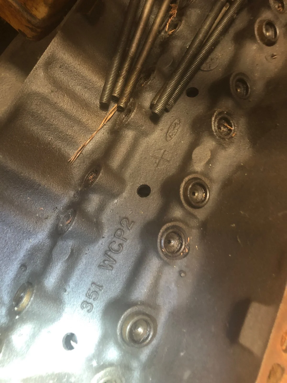

So guys this guys I know is selling a 351w but he sent me a few pics does anyone know what year this block was
I’d personally look for a non roller block and just use retro fit link bar lifters. They’re more expensive, but link bars are The way to go.
The non roller blocks don’t have any issues with cracks around the cam bearings, which is known to happen on roller blocks.
