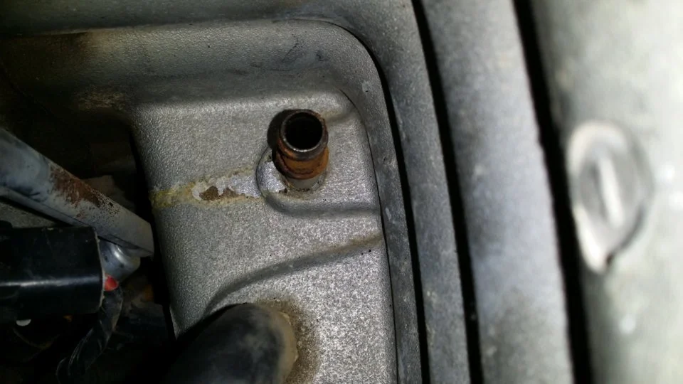

Here... This is the nipple I need to get to...

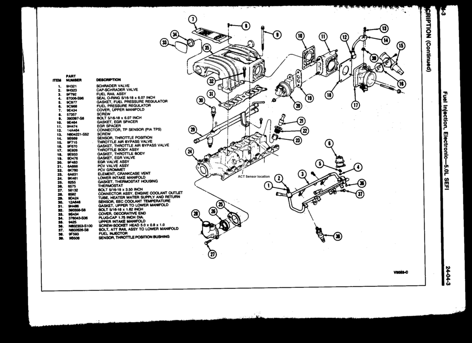

Remove the upper intake manifold - 6 bolts, 2 of which are hidden under the 5.0 cover plate. Then you get to pop off the throttle cable, inlet air duct and some other miscellaneous hoses and electric connections to get the upper intake manifold off.
Seriously, it is time for a Chilton's shop manual...Buy one before you break something expensive.
