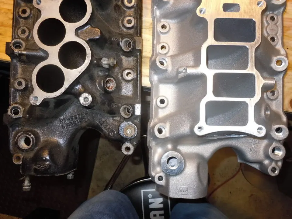

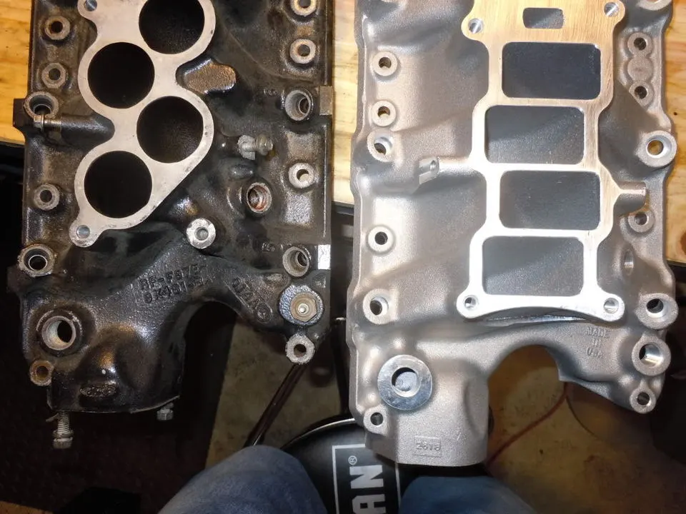

My old GT40 next to my TFS-R. Like a knife at a gun fight lol.
Not saying the right answer for everyone is the TFS-R and that GT40s should be melted down and turned into beer cans... The '40 has its place, and that's usually on mild 302s. But if you're serious about making power, aftermarket intakes are a leg up on the '40 no matter how you slice it.

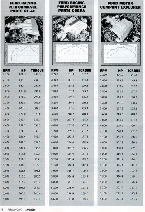

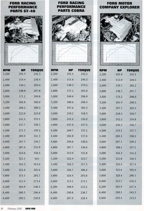

I've got nothing to prove to you and I don't care to get involved in one of your dick-swinging pi ssing matches. My post was simply made to illustrate the significant difference between a GT40 lower and an aftermarket one.
this debate was about flow numbers. i already provided the info that all three intakes were in the same playing field. thanks for your chart. i was asking for ''FLOW #'' not dyno numbers.. i understand it got alittle out of hand. but seems sometimes u need someone to act like a dickhead to get a point across. no need for this guy jared hess to go out spend 500 bucks on a intake and pick up nothing over all.. not fair to him or anyone who doesn't know the difference and listens to this BS and goes out and spends the money..for what??...cause some EXPERT on the internet told him he would pick up hp?? 90% of everyone tellng this guy this BS all have EFI killers that run low 12's with 10 and 9sec parts in them... im sorry but i read some of these ppls profiles and its a joke. the truth hurts.. i am sorry if some of you cant handle it..seems the truth is an issue with society today... anyway like i said.. this debate comes down to.. no reason for a intake change. and there's no reason to listen to the guys making no HP.
lets debate this, just had a car on the dyno 306 tfs heads. had a gt40 and swapped to a professional products. with no other changes the car picked up 18 rwhp.
