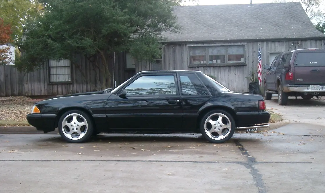

Okay, first off what a f'n clean Coupe!!! I am a little biased as you will see below.
Just me but you might want to look at the H&R Super Sport springs and some Bilsteins vs the other springs and dampers you mentioned. I ran the Super Sports and Tokico Illumina's on my 93 Coupe for about 8 years and it was amazing on handling and rode very well. It was my daily driver like this for about 5 years then I was lucky to change jobs and get a company car. This is what it looked like with that setup back in 2002.
I would go with the MM subframe connectors of the two you mentioned however I run Global West subframe connectors on both my cars. Reason is they install to the outside of the front subframe which keeps the ground clearance. I also run the Griggs Racing upper subframes but they are by no means necessary.
Why do you want to run the 31 spline axles? I have 28 spline Mosers with a 331 that makes 370ish rwhp on Nitto drag radials and have zero issues. Only mention this as you will need to get a 31 spline carrier as well so it can get expensive for what you are gaining and may not need.
I would also so a basic tune up on it if that has not already been done (plugs, cap rotor, plug wires, fuel filter, etc.) You would be amazed how people don't change a fuel filter until the car won't run.
Again, great car and have fun with the build!!!

This is exactly why I joined, to get good firsthand advice. Yes, you are a little biased, lol. Your car looks great btw! With regards to the 31 spline axles, this was my thinking. Since the car is 36 yrs old and I'm doing a gear swap, it would be a good time to throw new seals in the housing. LMR has an axle kit that has the R&P, shim pak, seals, bearings, axle shafts and diff. and you can choose your spline count with minimal cost between the 28 and 31. Probably overkill for my rwhp goal but, the upcharge for the 31-spline seemed like good insurance. And yes, I'll get those wires and plugs changed, they have the 90's date code on them lol...
