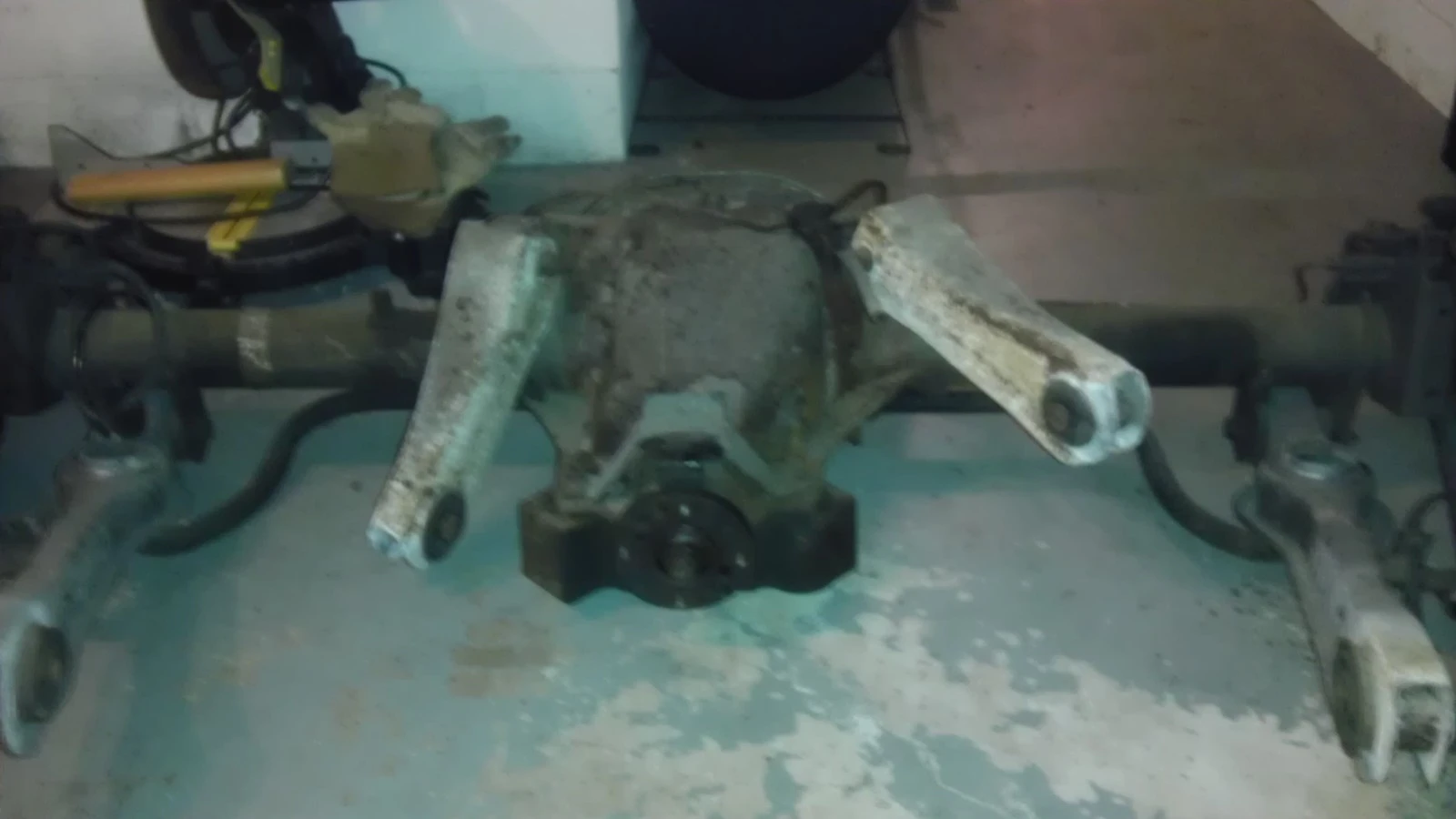

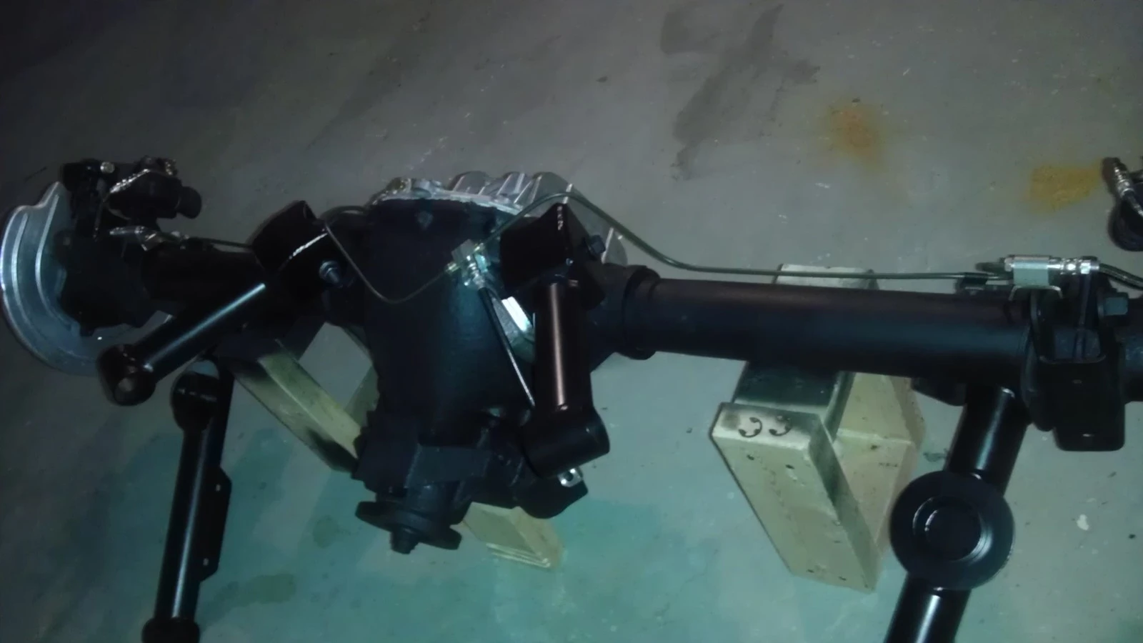

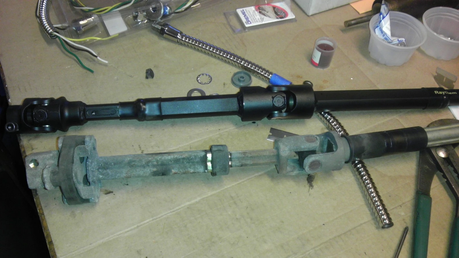

When I was 16 I inherited my parents' 1995 3.8L V6 Mustang. I realize it's probably not the most desirable 'Stang ever produced (and btw why does everyone hate the SN95 cars so much?), but it's a 5-speed and to a 16-year-old kid it was one hell of a nice car. Actually, in some ways it still is. See, I never got rid of it. In fact I've never owned any other car even though I'll be 30 this January; it's still my daily driver. I've decided that rather than finally break down and buy a new car, I'm going to restore this one.
Through the years I've repaired or replaced many of the original Ford parts. The entire stereo system (cables too) was upgraded when I was in college, the entire suspension was replaced recently with a nice Eibach kit complete with lowering springs and sway bars, and I've done countless other things as well such as 17x8" Bullitt wheels, window tint, rear wheel spacers, a Steeda tri-ax shifter, drilled and slotted rotors, Flowmaster H-pipe dual exhaust, a tuner, and some minor engine bolt-ons to keep me happy for now. About 6 weeks ago I got paint, bodywork, headlights, and tail lights to make it look decent again. More recently I swapped in a MM steering shaft and polyurethane steering bushings to improve turn-in response. Just last week I finished up refurbishing an 8.8 rear axle from a '94 GT that already has the 3.73 gearing I want. Of course I added all new bushings, stainless hoses, new hard lines, a Steeda differential cover, and J&M tubular control arms, upper and lower...

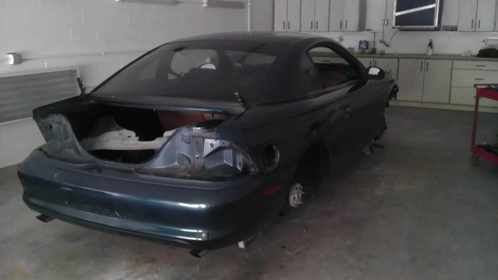

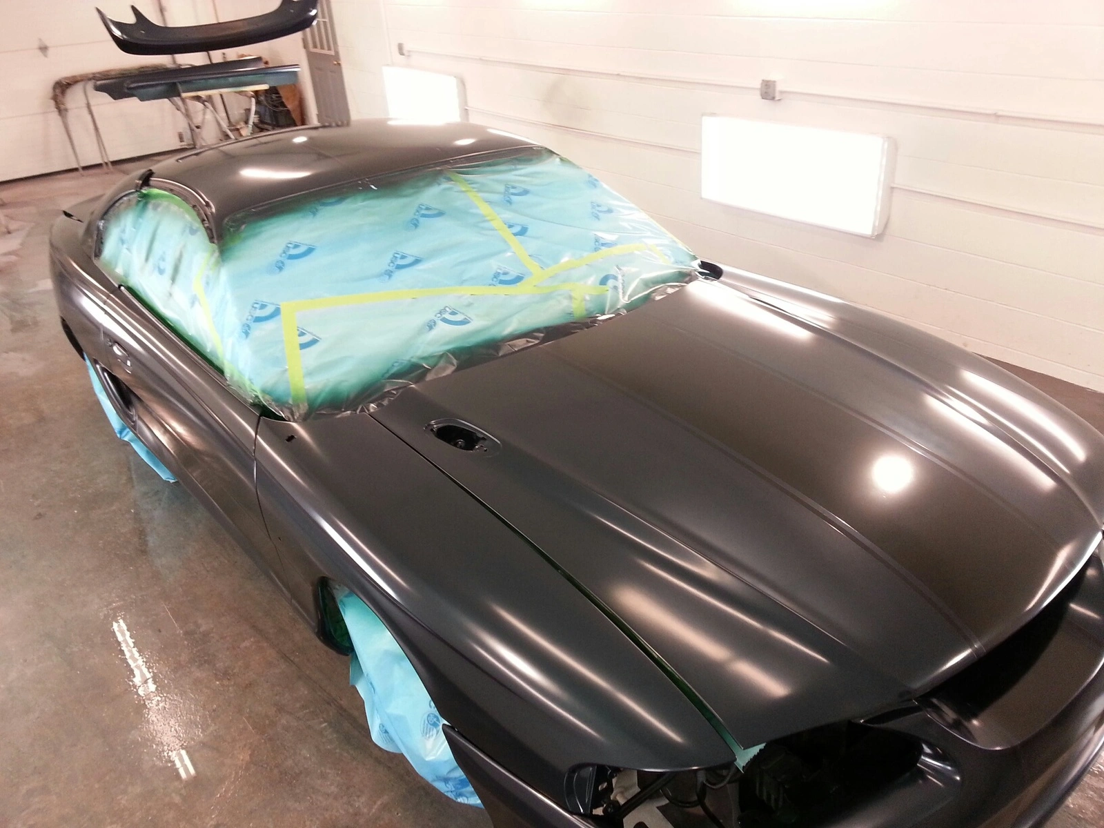

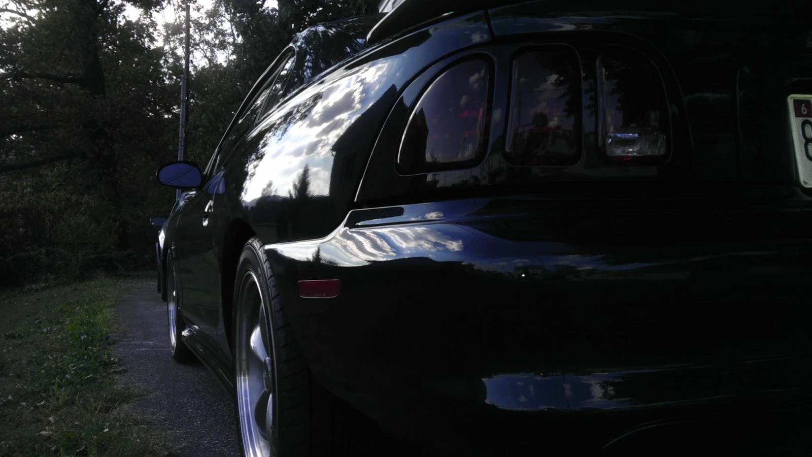

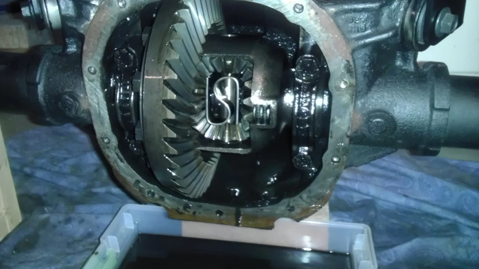

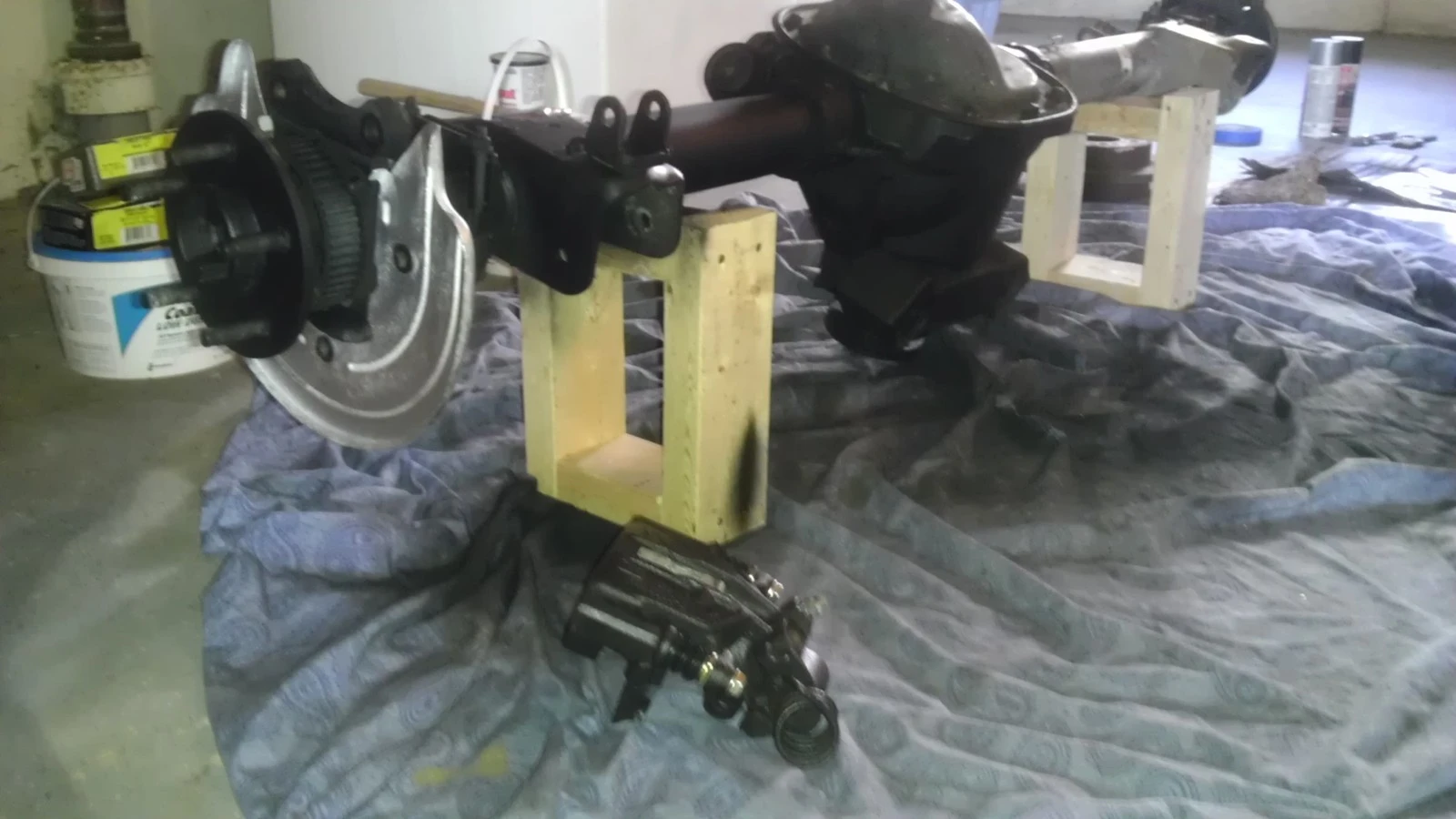

Here are some random pics of what I've been up to over the last few months.

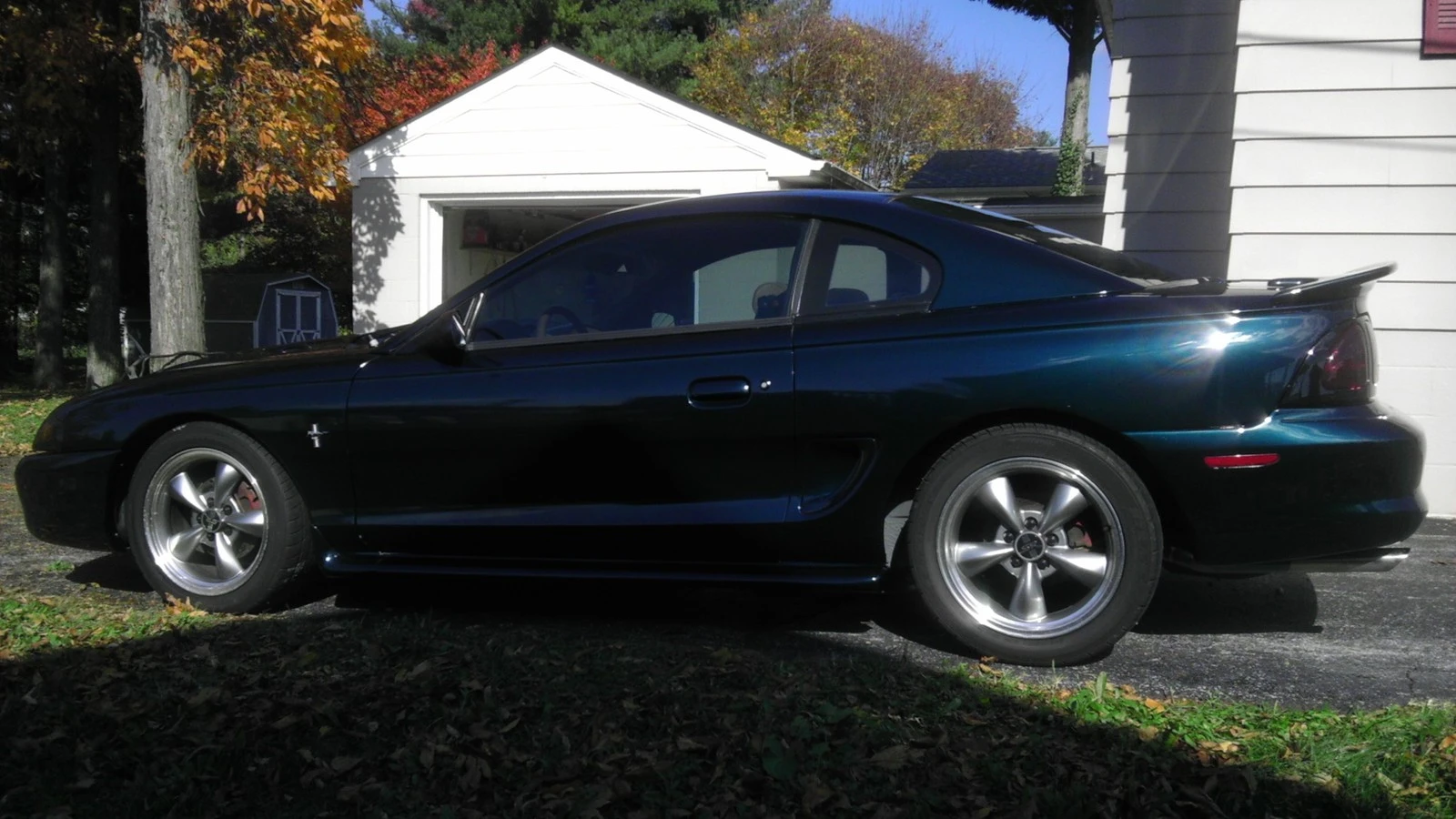

Nice track shot in your avatar btw. I have yet to make it to Summit Point with my bike even though it's relatively close. Here's a shot of my ride with the 'Stang in the background (before paint, tint, and new suspension/lowering).

Good to know. Can you link me to a good 331 kit that will work well with the Trick Flow top end stuff on an otherwise stock engine? I'm hoping that this setup with my new 3.73 LSD axle should make for a fun DD that can hang with most of the highway competition (350Z, G37, WRX, GTI, etc) and also be good for some back road carving and track-day drifting.

Hmmmmm, there's an idea. Any particular year to look for? Are they the same 5.0 as the Mustang? Also, how much cheaper are we talking? I know I can start with an eBay motor out of a 94/95 Mustang that has all the accessories and is guaranteed to run for around $800-900. I was considering that since it would probably be easier for a newb like me to restore something that's already built than to try putting a bunch of new parts together. That's what I did with the axle; I replaced pretty much everything except the gears, but it was helpful to see where it all went beforehand.:D
