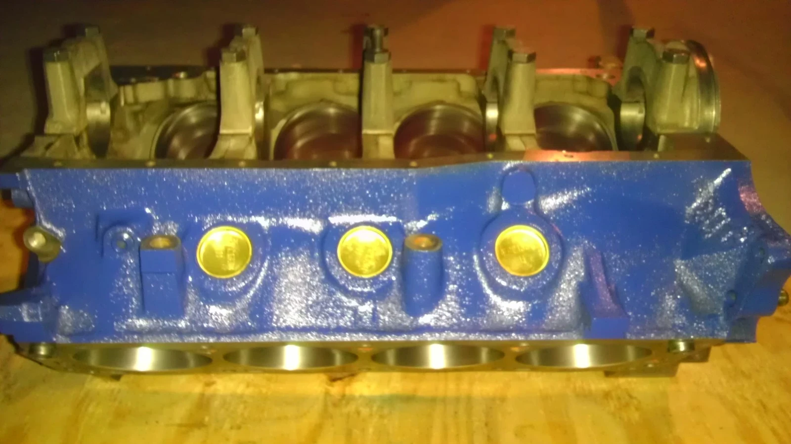

Here's the block back from the machine shop, bored to 4.030 and ready to go. I couldn't resist taping it up and painting it good old Ford Blue (the darker version). It looks somewhat lighter in this pic than it actually is...

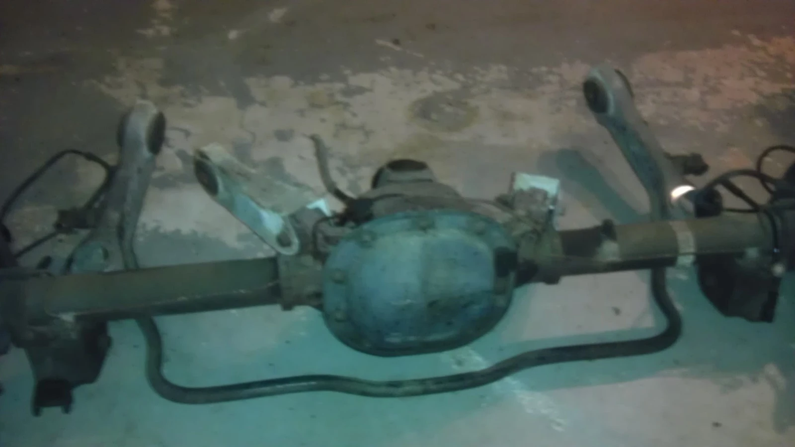

That rear axle looks good!

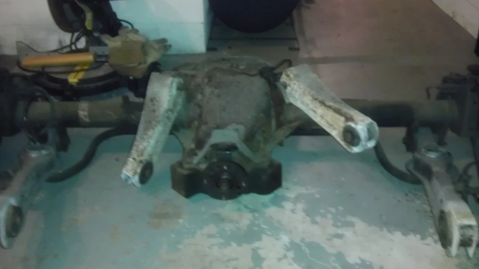

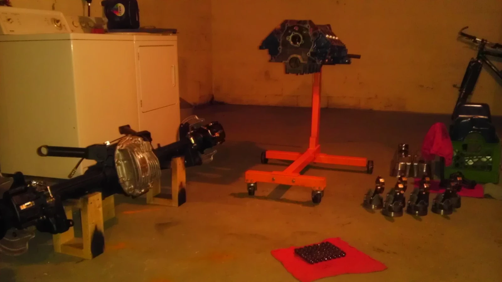

Thanks! It used to look like this... I got the rust off with repeated coat of naval jelly then painted it with matte black Rustoleum, pressed the old upper axle bushings out and replaced them with new ones, replaced all the control arms with J&M tubular steel ones, got all new braided, teflon-coated steel hoses, bent all new coated hard lines (wife helped with that), bent the dust shields back flat, sanded them clean and painted them with metallic 1000-degree heat paint, replaced the caliper brackets with new ones (plus pins and boots), cleaned up the calipers and painted them and the brackets with more heat paint (matte black), drained the old gear oil and replaced it with new, and replaced the stock cover with the aluminum finned one from Steeda. I've got polyurethane isolators and bushings ready to go for when I actually get around to the install, plus a new set of speedo gears. I'll reuse the rotors, pads, rear sway bar, and wheel spacers from my current setup.
Hopefully the engine build goes well too. I'm pretty OCD about details in case nobody noticed...:rolleyes:

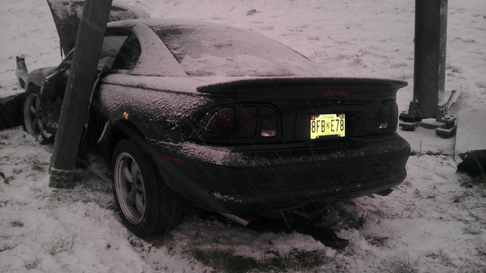

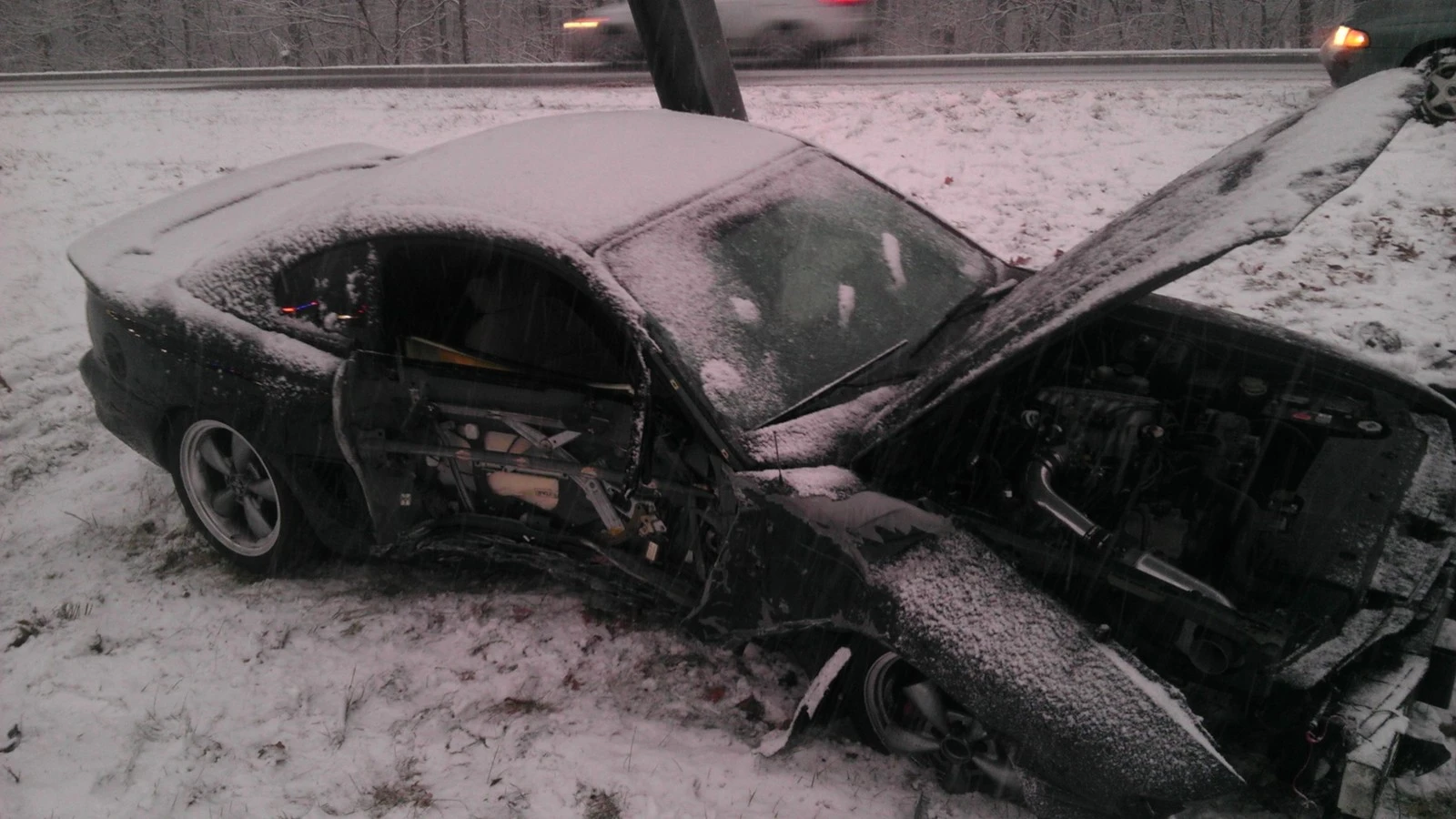

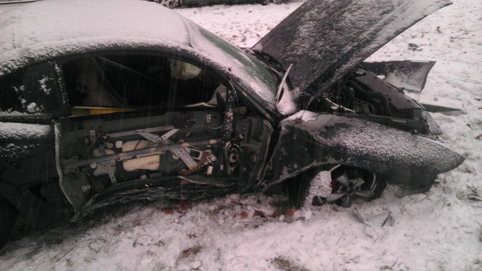

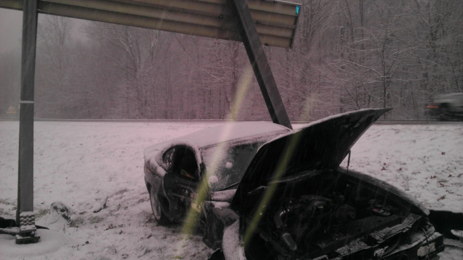

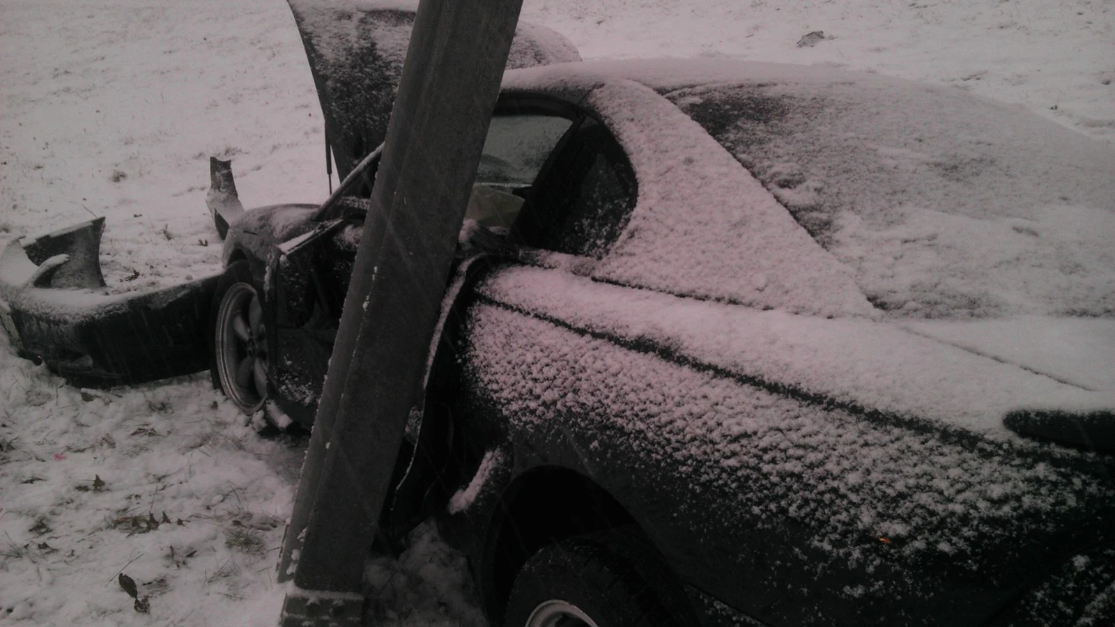

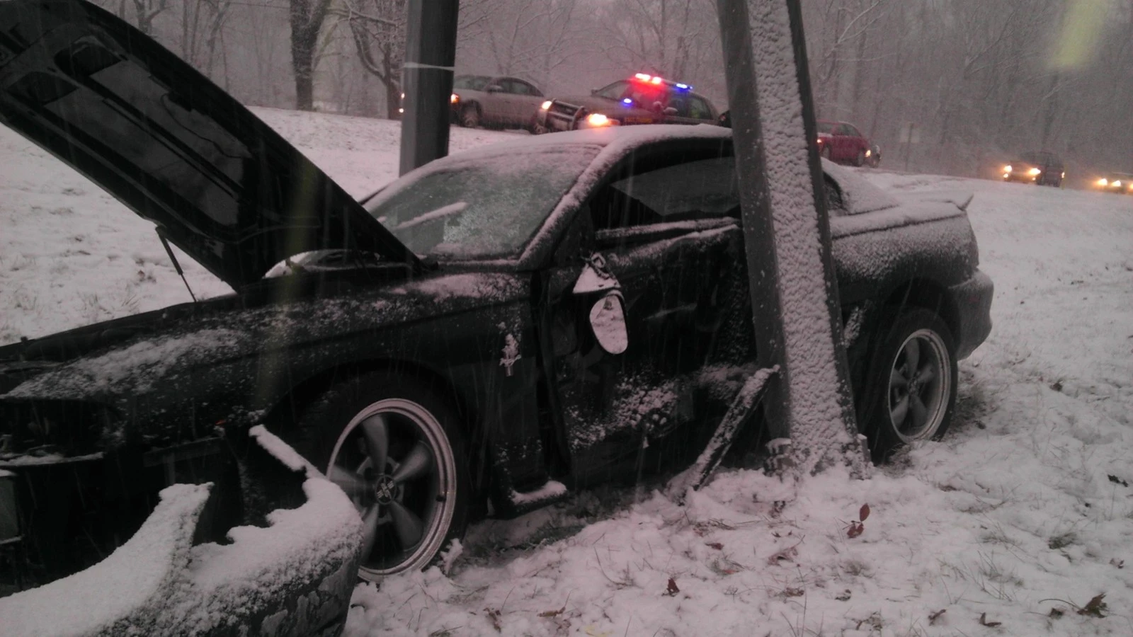

Well, I guess this restoration is over unless I can pick up another 94/95 car, this time a GT... At least I didn't get hurt.

Road went from just wet to slicker than eel $hit in about 1/10 of a second while I was going uphill. I lost the back end and the front simultaneously and went into the median... best I could do was go between the steel supports instead of straight into them.
