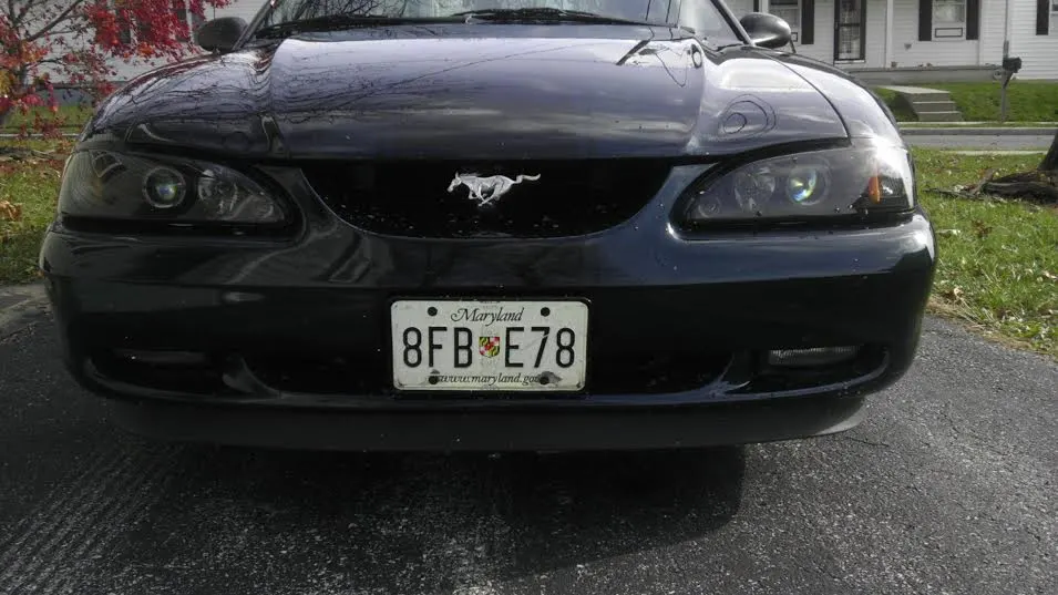

Oh, I found a local guy who installed my chin spoiler, aligned the front bumper cover properly, fixed the headlight fitment, and set the hood spacing... all for $85.:hail: I gave him $100 since I hate doing those sorts of cosmetic things.
