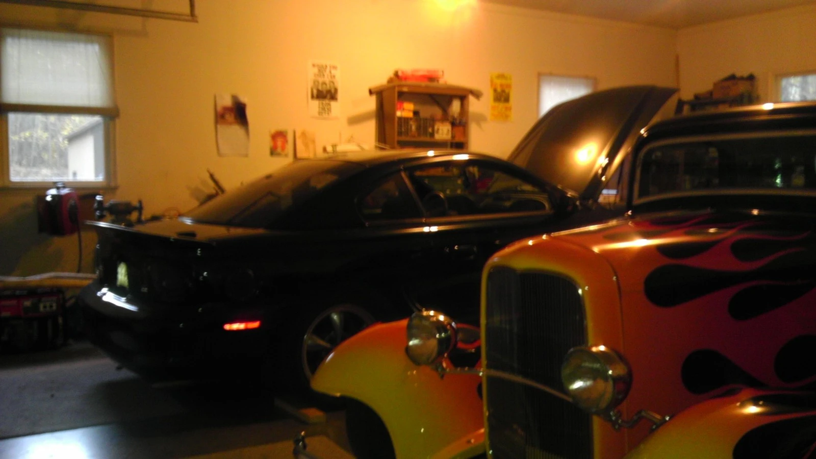

Here are some pics of cars owned by my grandfather, great-grandfather, and great-uncle. This is by no means all of them, but just some of the most interesting. You could say I come from a bit of a car family. I'm not really into the OLD old ones like the model Ts or Model A...

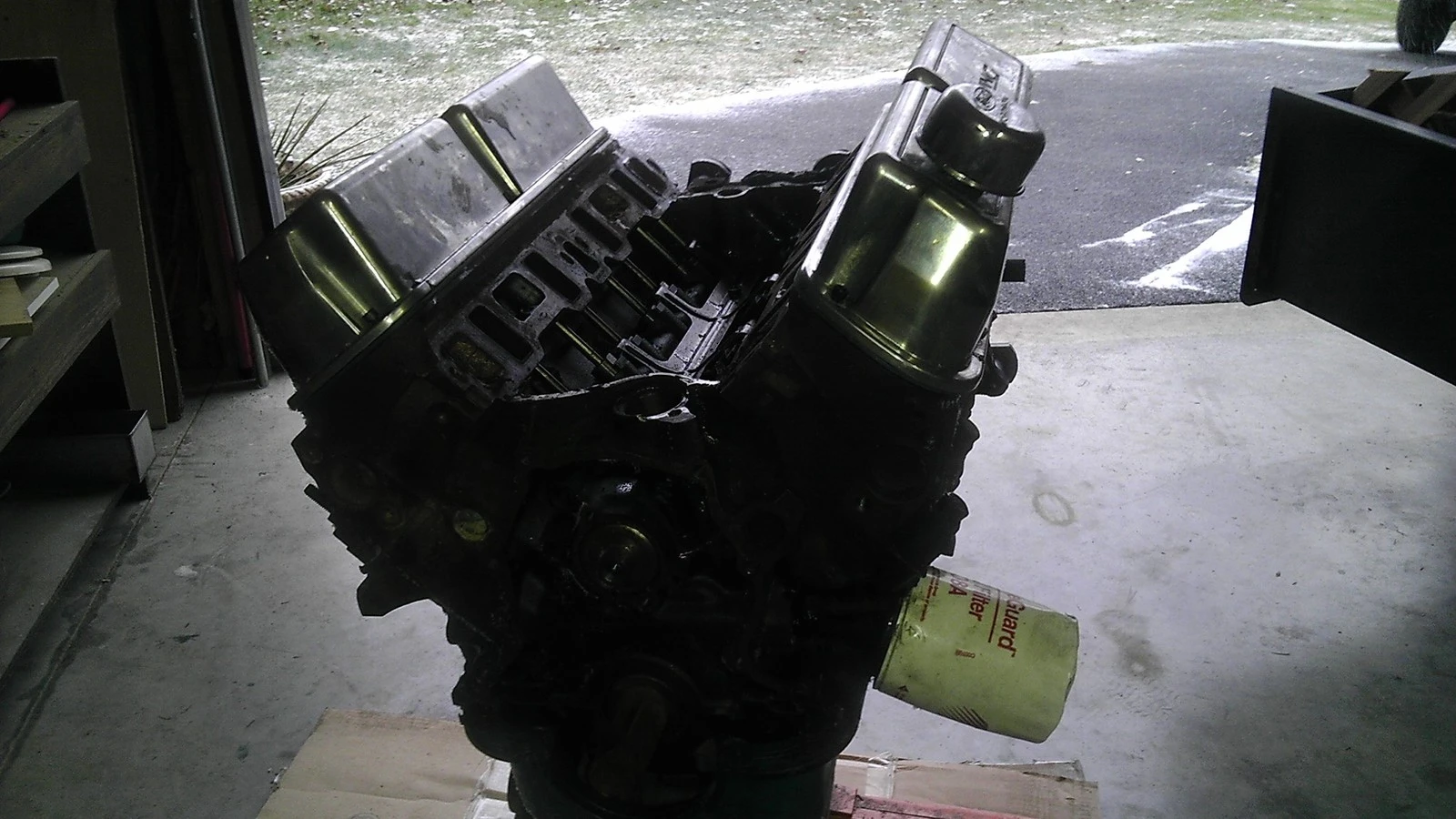

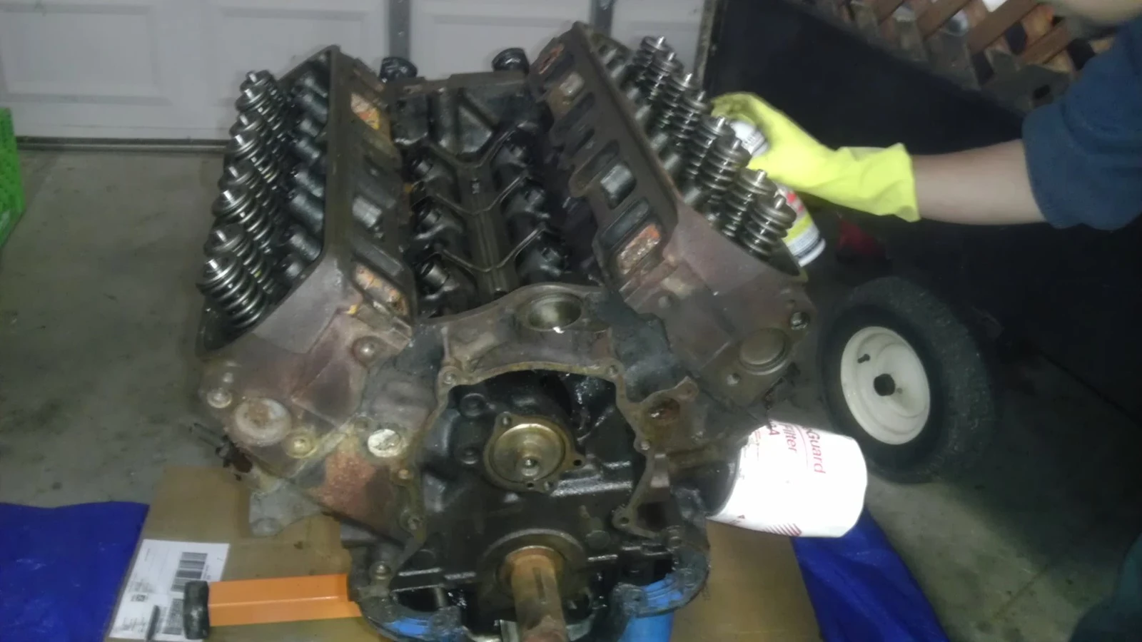

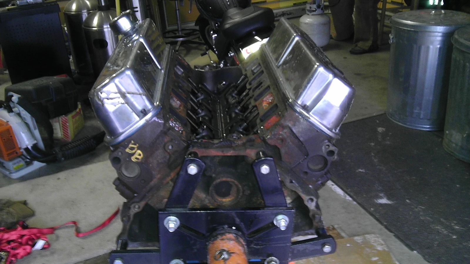

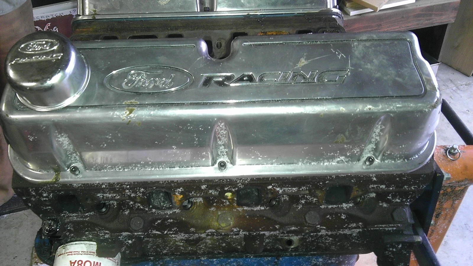

Thanks to Billy being super cool, I now have an engine and stand for $100! It almost killed us lifting it, but now thanks to a little help from a local's front-end loader it's safely in my buddy's steel building awaiting tear-down. I like the valve covers and I'll probably try to reuse them if there's enough clearance.

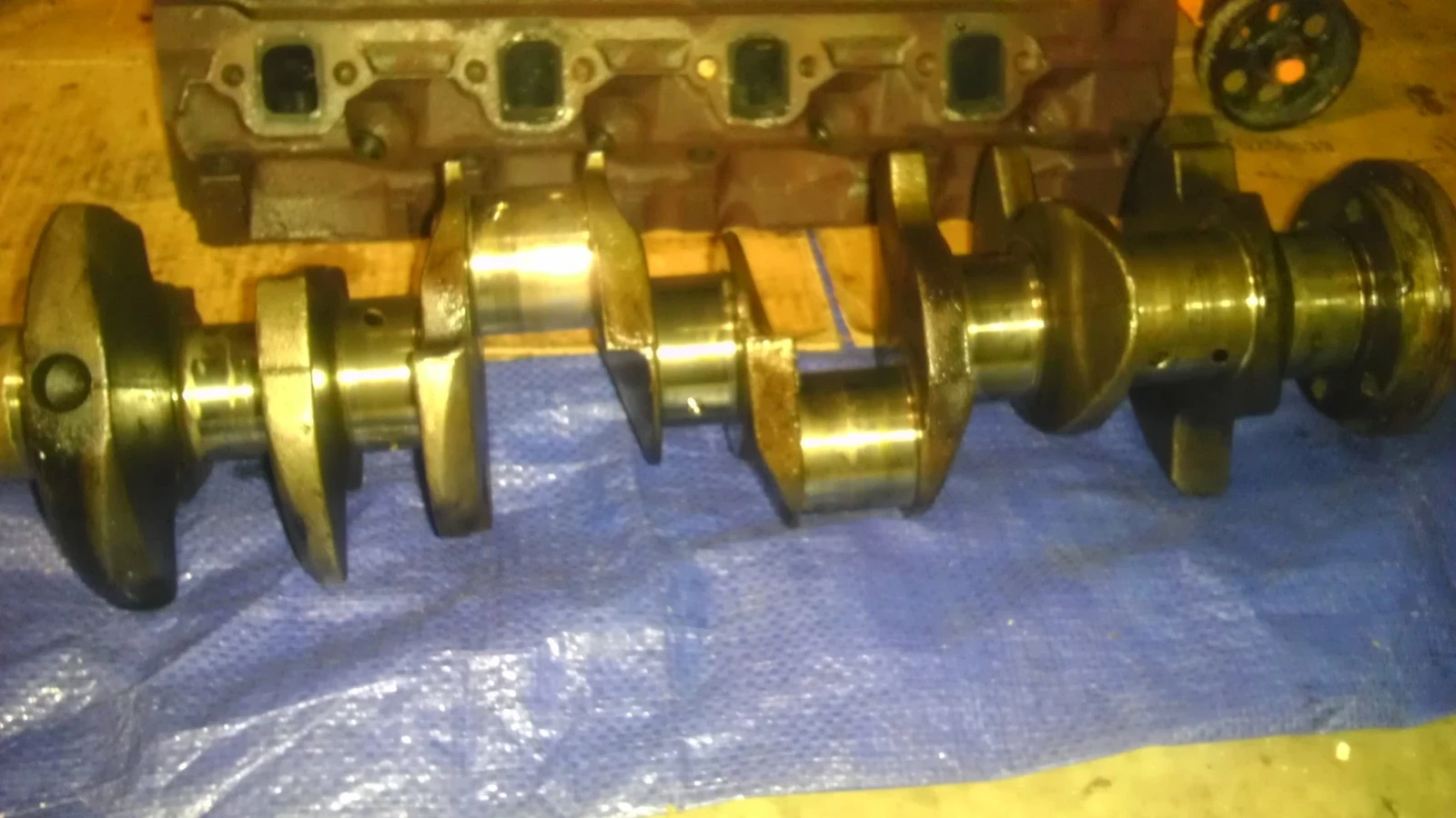

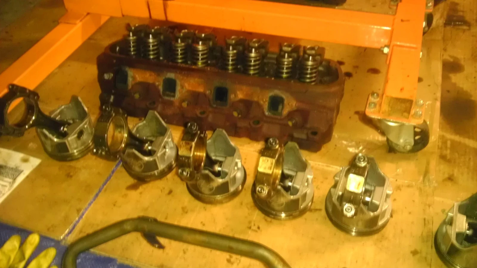

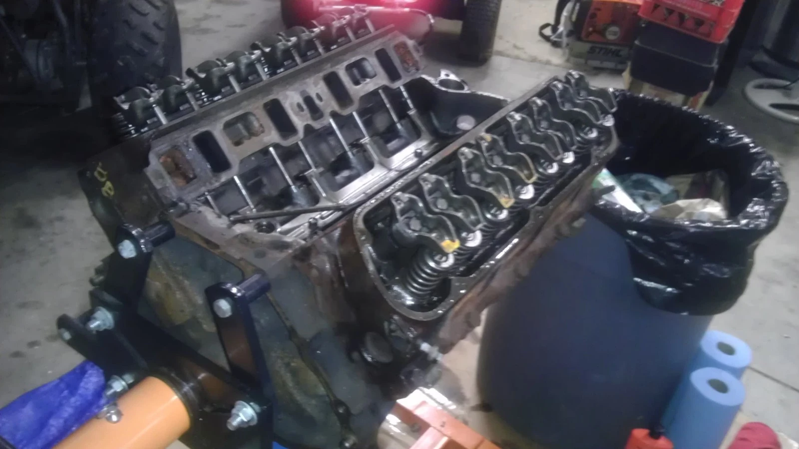

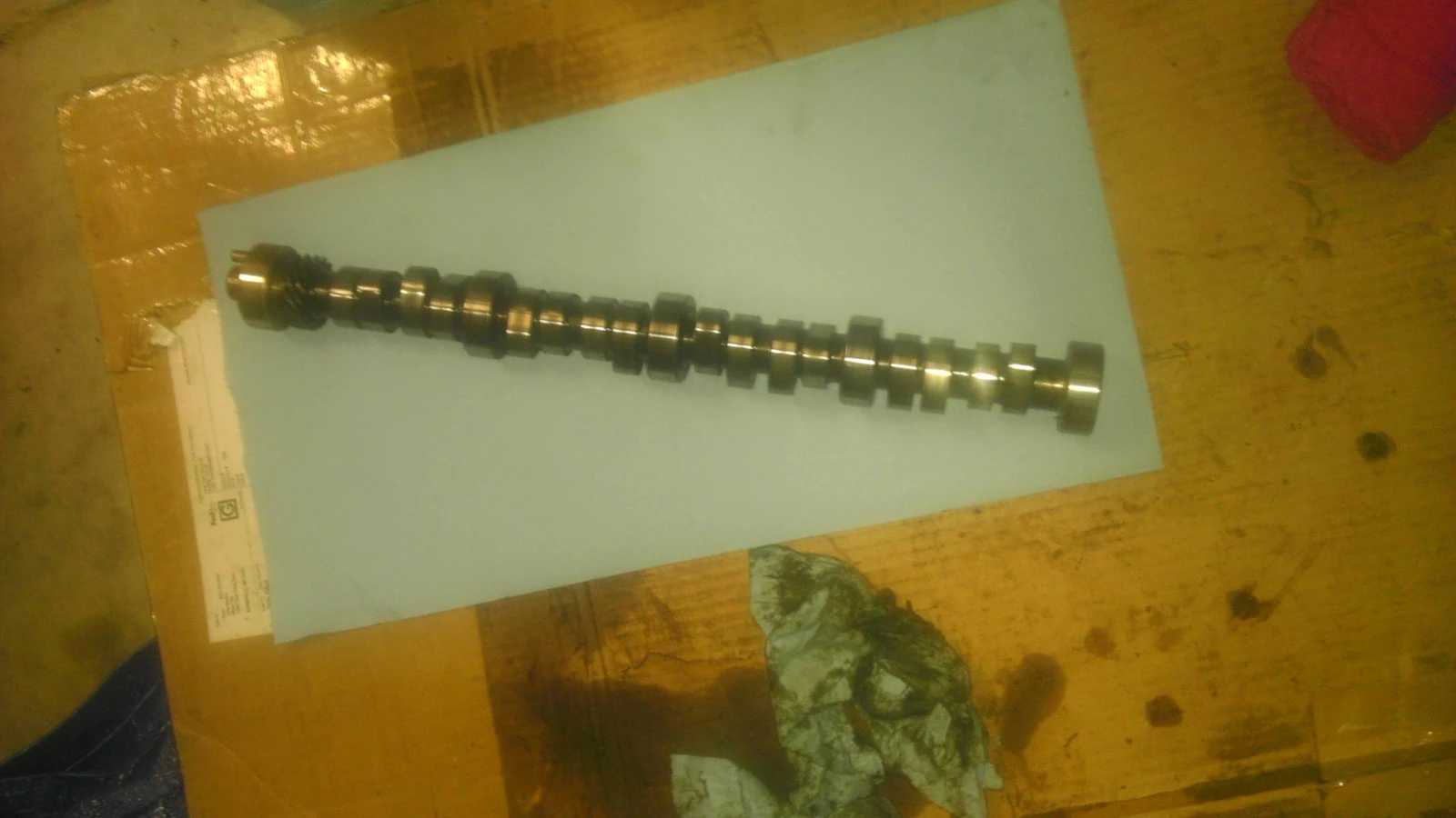

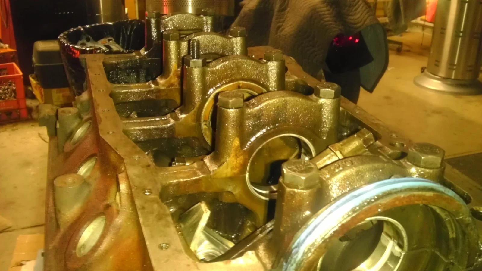

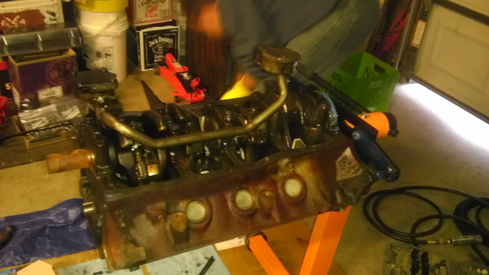

Got it torn down this afternoon thanks to a snow day on base. Only trouble was 2 pistons don't want to slide out due to a bit of rust on the cylinder walls. Rather than force it I think I'll let the machine shop handle that problem.
