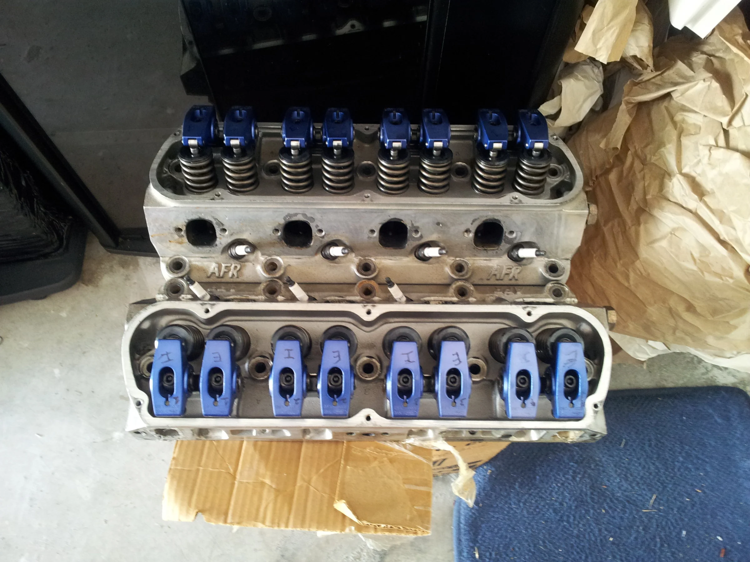

@Mustang5L5
the hole in the back of the head has nothing to do with the EGR. It is for the thermactor tube that goes down to the cats. That is where you will see on my heads I installed the bolt. The EGR port in the head is located in the center of the head on the side facing the intake manifold. Look at the bottom head in the picture. It's ok not to try and respond to every single post. Better to give out proper advice.
To the OP- don't start drilling holes in your heads. If you want emmisions compliant heads then buy them.
Thanks for clearing that up, did you read the post from the begining? From the description at the start I think he is dealing with the thermactor pipes and calling it an egr. My mistake.
Maybe he can post a pic of what he is try'n to do.
Sorry I was thinking it was egr crap.

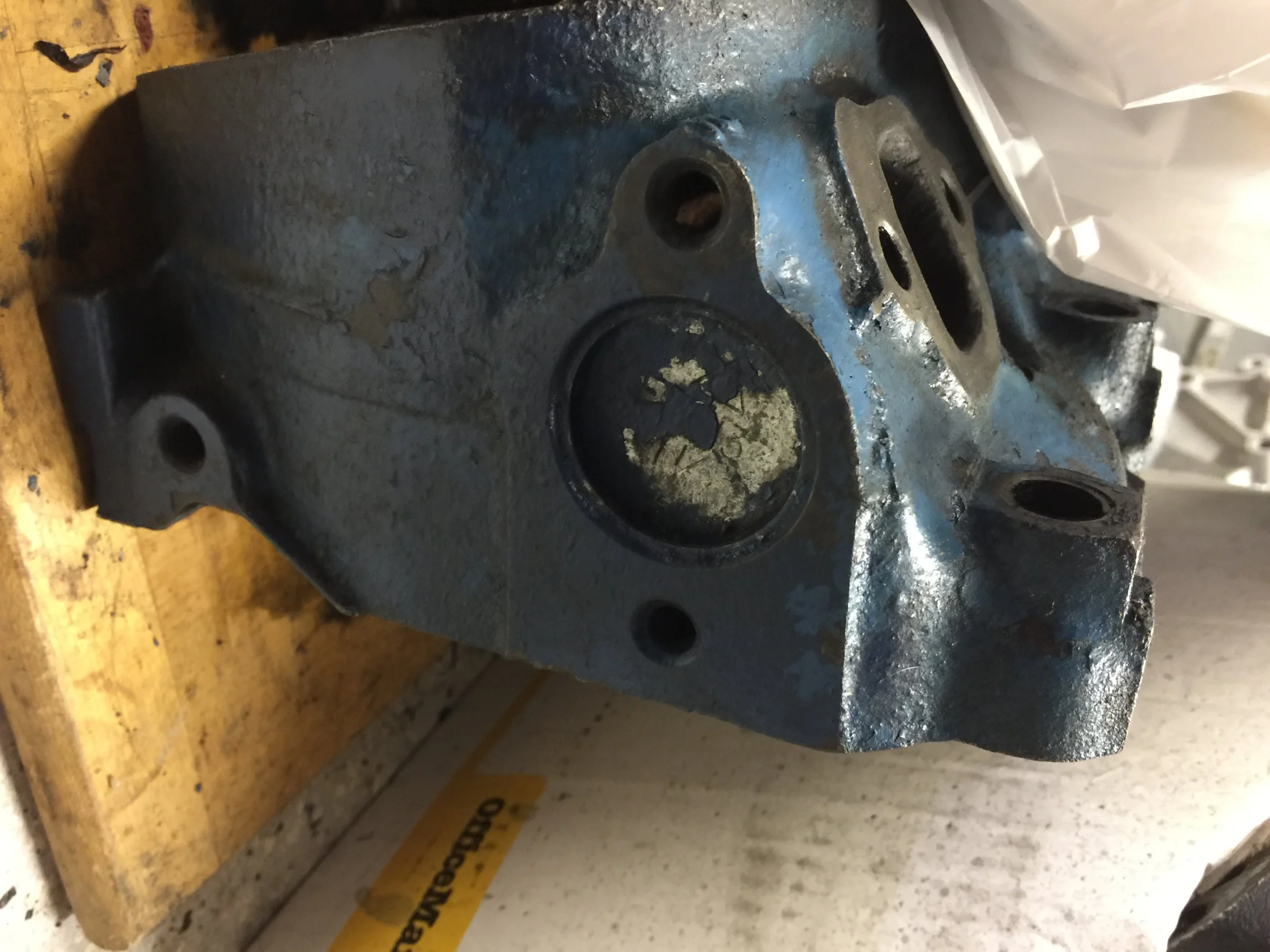

If I tap in thermactor tube holes in the back of my heads to mount the air injector tubes would I hit anything. These are not gt40
If you have those heads there should be provisions for the tubes, I thinking the heads are installed and in the car so stick your fingers behind the head and feel for two holes, one larger than the other. I will try to get a pic
The thermactor tube only pumps air at cold start up to the heads. My opinion is for smog purposes you plug the holes in the back of the head, hook up your smog pump, hoses, etc, and just bypass the thermactor tube with no ill effect other than a code being triggered. If you must pass a visual, you will need to have the head drilled and tapped for the thermactor tube.
