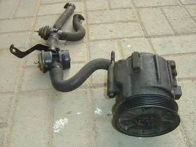

Here's the best way I can describe it.
Here's your smog pump, and the air line coming off it. First valve turns the flow on and off, and the second one diverts the flow to the two various tubes. Top tube runs to the heads, bottom one down to the H-pipe.
SInce you have a 2 cat pipe, and aren't changing that, there's no need to send any airflow to the heads. Simply remove the diverter valve (the rear most valve in the pic) and run a single rubber hose from the first valve, directly to the pipe going to the cats. Now, the car will feed air to the 2 cats constantly.
As for the solenoid controlling that diverter valve. Leave it hooked up and simply cap the vac line
Reactions: 93Vertang
