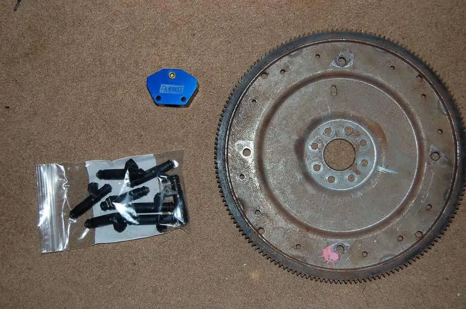

And since I don't like to bump the thread without some tid-bits:
Siemen Deka High Impedance 60lb injectors
The 8 bolt flex plate i bought a while ago
And a Russel y-block to split my -10 to -8 feedlines to the 5/8" rails.

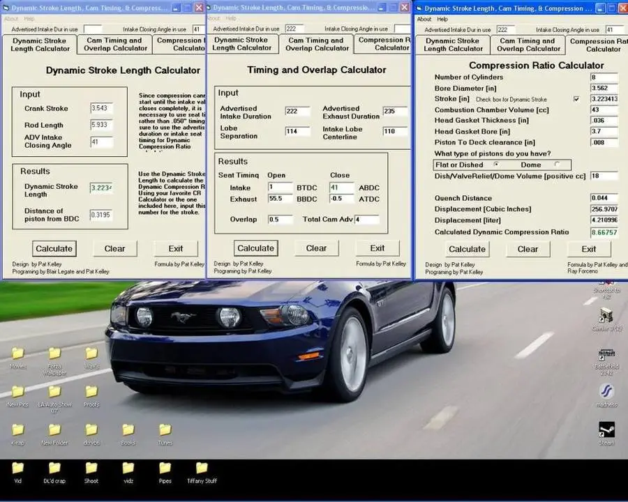

And in case people are curious, my compression is 9.427:1
and dynamic compression is:
8.668, which isn't awesomely low - but lower than it would have been with VT stage 2 blower cams.
I added .5CC in head combustion chamber volume due to porting (stock is 42.44), would have added more if the low rpm emissions ledge was taken off which i still have.

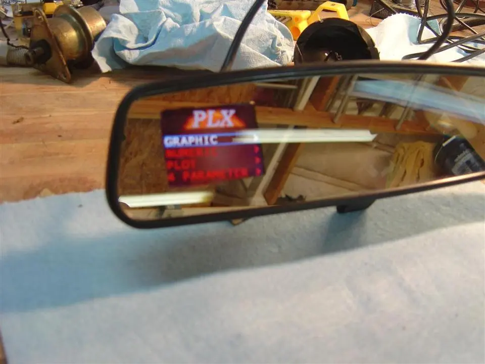

Right, the guy i do tuning with uses that, put it in his rear view:
:shock: I love that! I dont wana hijack your thread man but if you have info on how he did that could you please PM me or something? Thanks! :cheers:

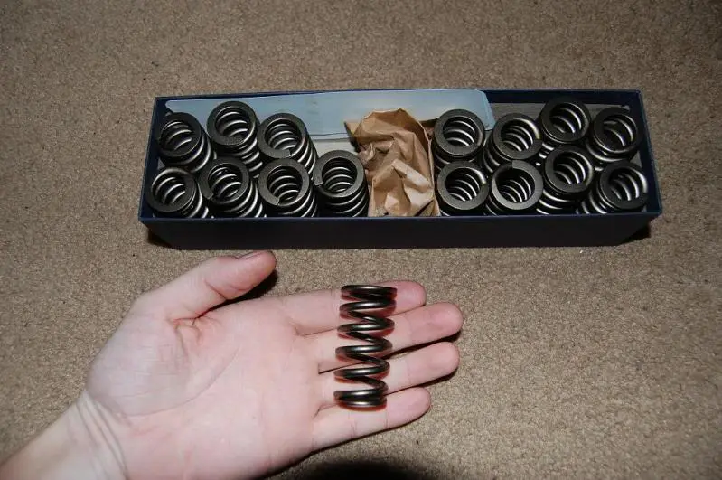

The spring look trick! What are they coated in?
No hijack, it's my thread we can talk about whatever I want:
Go to here: DM-200 pictures
I scraped it with a razor blade. It took about an hour to scrape a decent hole for the gauge using a razor blade i cut in half. That was the hardest part by far and the rest of it took maybe 30 min. I cut the hole with a hot knife and just sealed it back up with hot glue. If i feel like it later, i'll plastic "weld" it back together, but its fine for now. I used wire clippers to remove some of the pcb board that was in the way, but other than that the plx did not need any modifications other than snapping the gauge case off. It turned out pretty sweet and was not nearly as hard as i imagined it was going to be.
