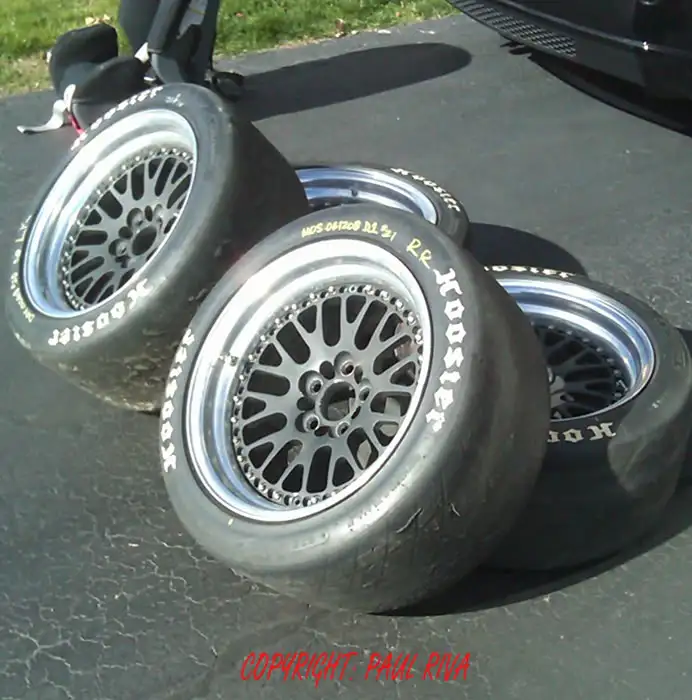

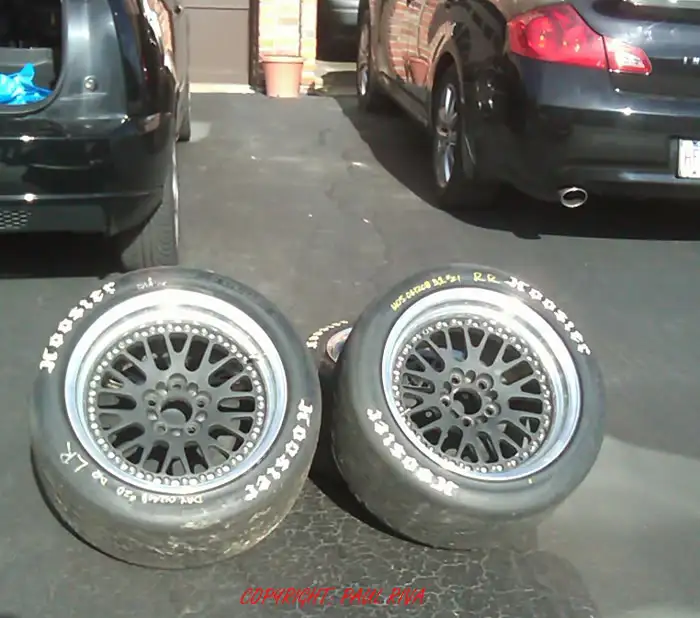

I have wanted a set of these wheels for a LONG time, especially since I got into autocross and luckily I grabbed a set today, complete with a set Hoosier Koni cup tires.
I'll have to wait a few days before I can get pics of them on the car, but for now here's a little taste. These are my new race wheels.

Matt- The tires are actually MINT! These are race tires that come with basically just a shadow of a tread on them. There are wear holes across the face of the tire and they are all there and accounted for. There is a lot of meat left on these tires. The only bad thing is that since they are a road race tire more than likely the compound is too hard for autocross as I'll never get enough heat into them to soften them up.
95BlueStallion- These wheels are lighter and should be stronger than the '03 anniversary wheels, plus these are wider as well. these are a true 3 piece wheel like my bogart RR10's on my 'vert which means that if I ever mess part of the wheel up, or want to change its width I can by adding new halves to it. Also, I hurt the '03 cobra wheels a little this year when they made contact with the A arms. I still raced on them after the mishap, but it was always in the back of my mind as I worried they may fail on me in a high G corner.
blksn955.o- Yes, these are the race version of the CCW classic's. I believe they are 17X10 (they may be 17X9.5), but I won't know for sure until I get the tires off. I'm not too worried about fitment though as they came off of a '96GT and the back spacing is almost spot on with what I have now. Fender clearance shouldn't be an issue either since I have a lot of roll stiffness in the car with my 425lb coil-overs up front. I will obviously need to check everything but I know I can get them to work.

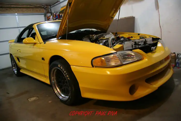

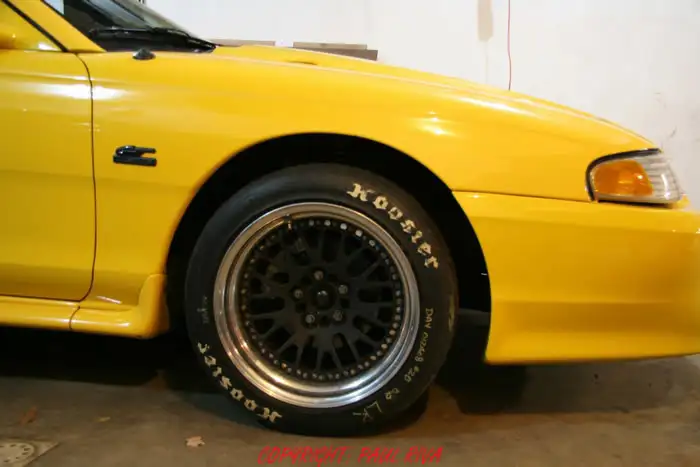

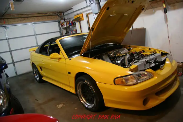

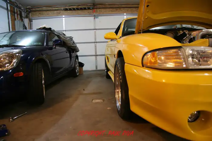

Well, I need longer wheels studs before I can mount them on the Cobra BUT... I do have 3" studs on the '95 up front so here is a few pics:
Ryan- that is a hard one to answer. This kind of racing isn't like drag racing where you can compare times from one outing to the next as the course changes every time, but with this light weight wheel that is wider it should help. I hurt my '03 cobra wheels and that is the main reason I got these. New tires will make the biggest difference and even though these Hoosiers will make a nice HPDE tire, they are no good on the autocross course as they will not have enough time to come up to temp and get sticky.
