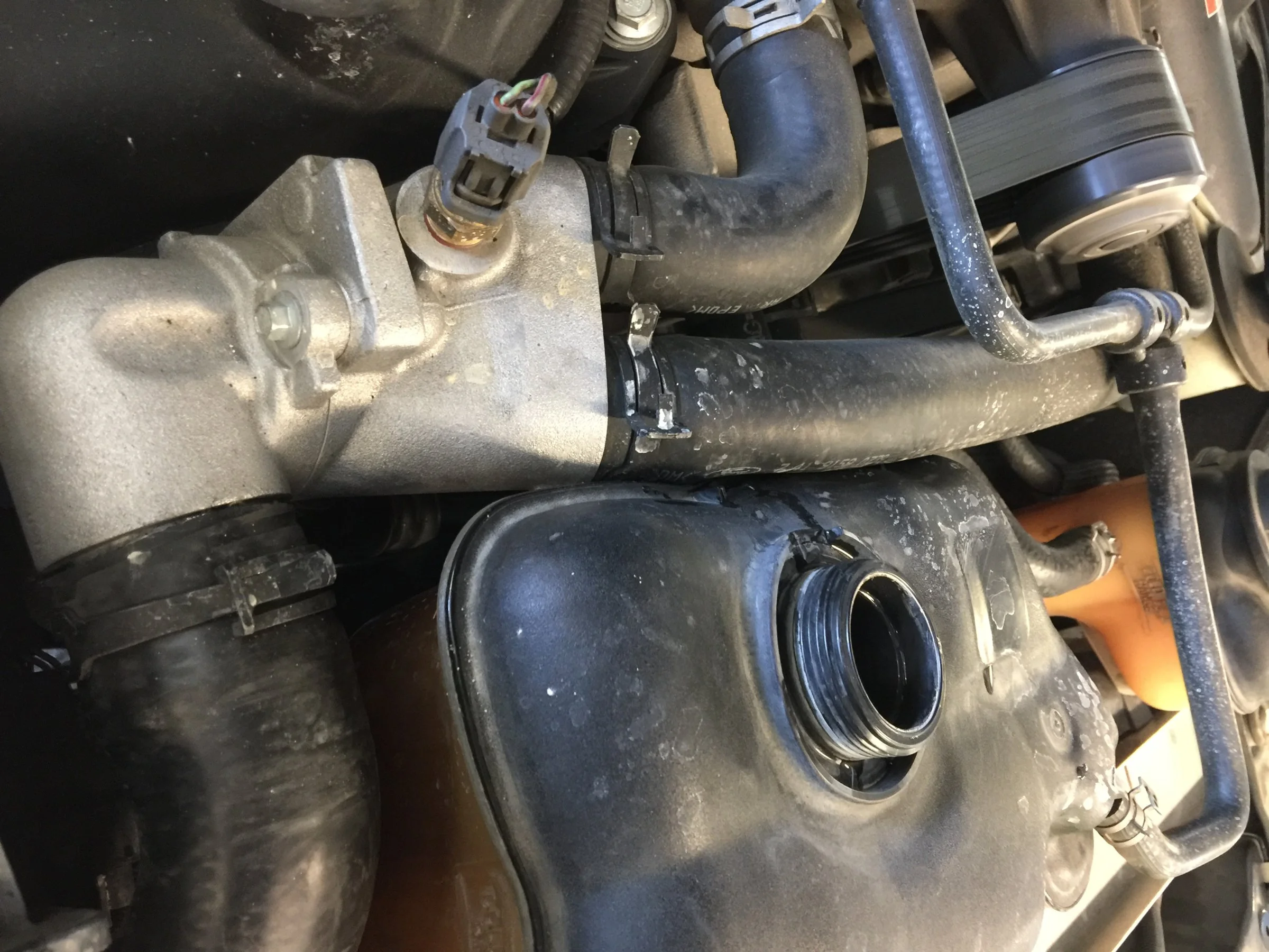

i bought this bad boy nearly a year ago and I've finally installed it!! Install was easy, taking it out was the hardest. The radiator I believe it to be the C&R Racing Ultra High Performance Radiator because I was told so lol. Anyways here it is installed and ready to go!

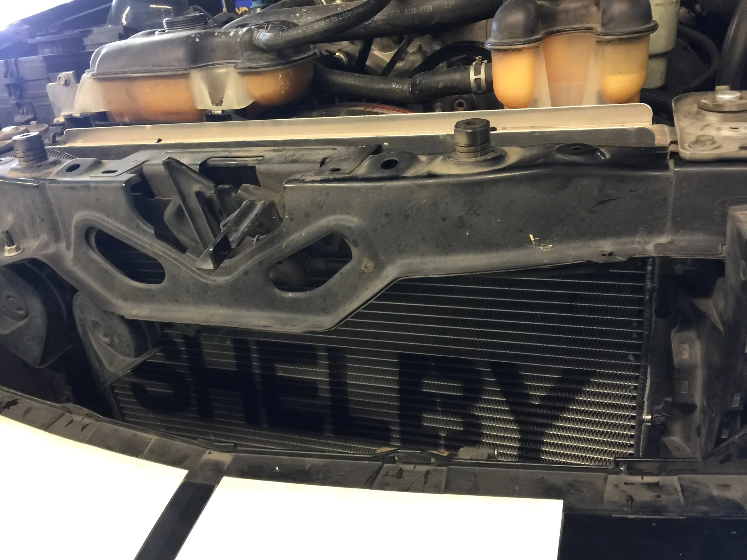

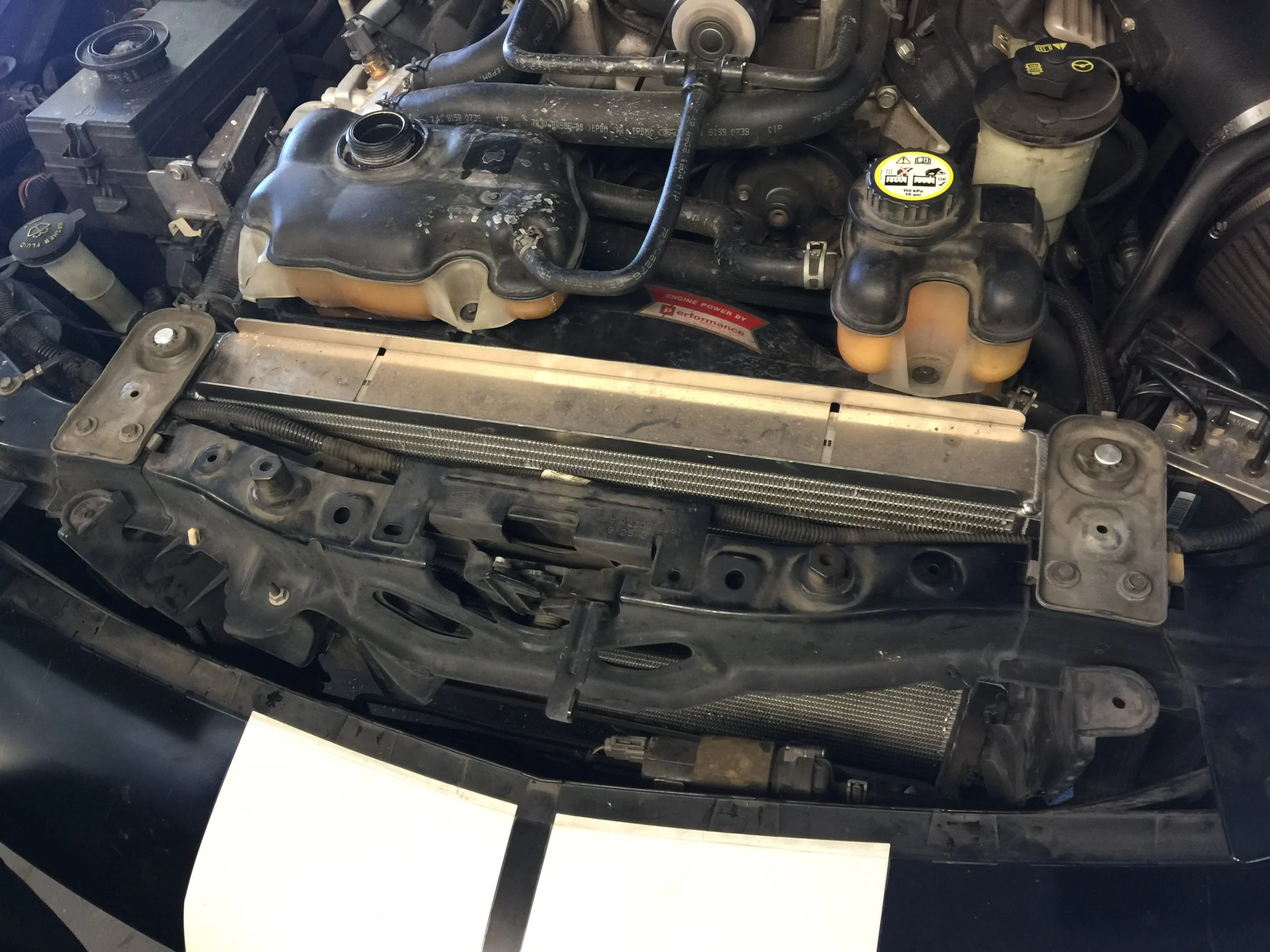

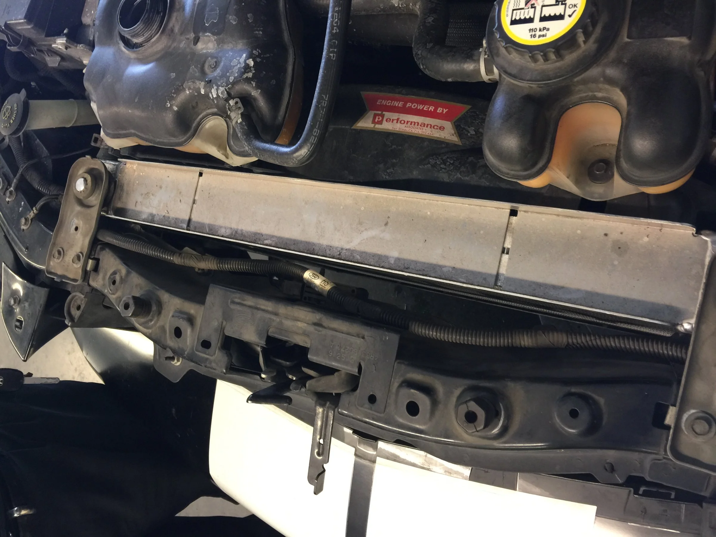

Radiator is completely in, had to remove the fan a bunch of times and modify it just a little bit. Just the fins/over casting on the left side next to ac lines need to be trimmed so the ac lines will clear. FYI remove the studs on the radiator that hold the pws lines and the condenser or else you'll have a hell of a time getting the radiator out with out poking holes and damaging the condenser. You don't have to unbolt the ac lines on the left side if you remove the studs. everything bolts back in despite the radiator being so much thicker. If you replace your condenser like I had to *cough cough* the aftermarket ones from napa are way better quality and looking than the stock unit. Plus you don't have an ac line running across the condenser which saves about a half inch of room which helps a ton. Any questions just ask and I'll answer the best I can

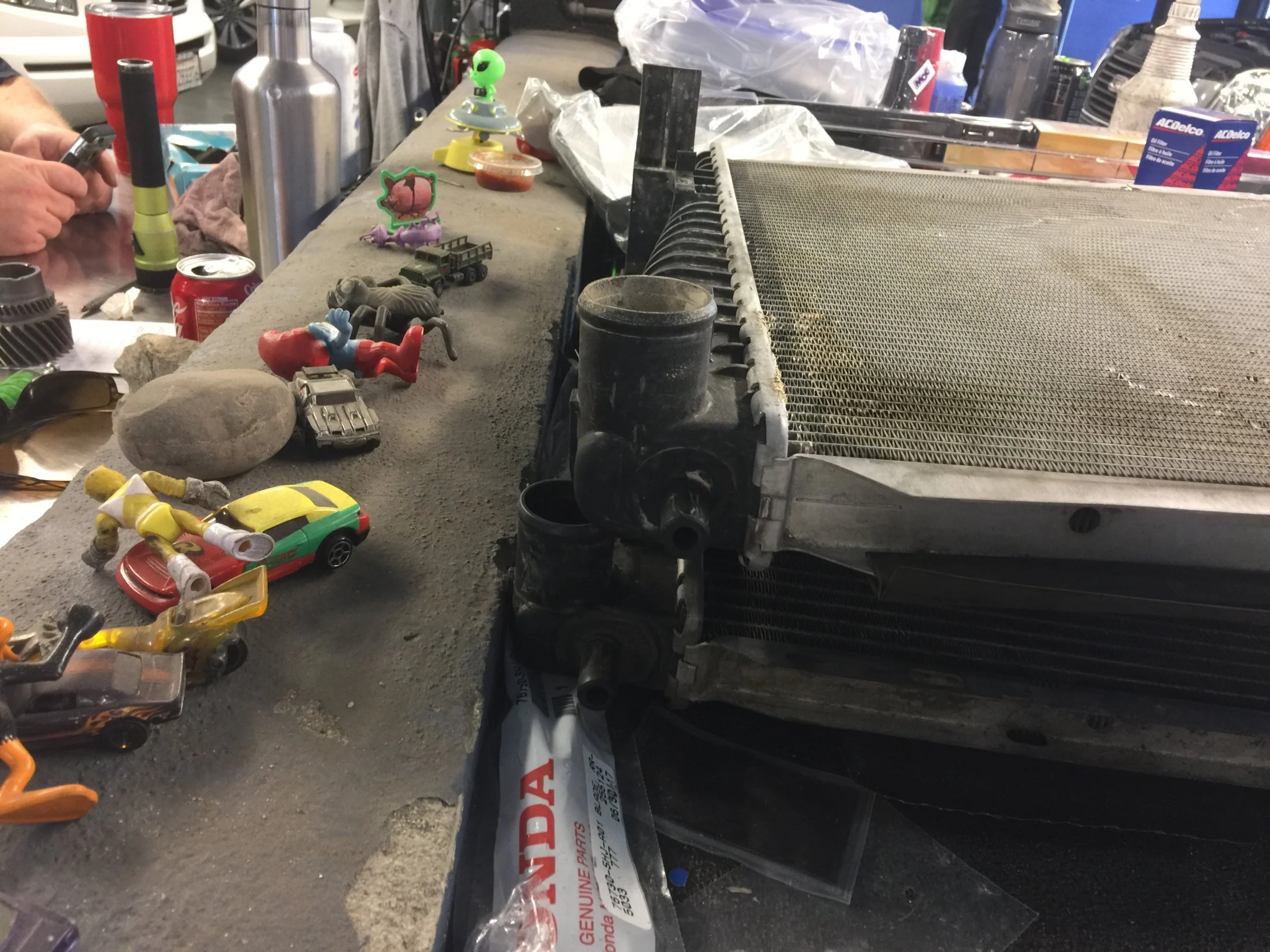

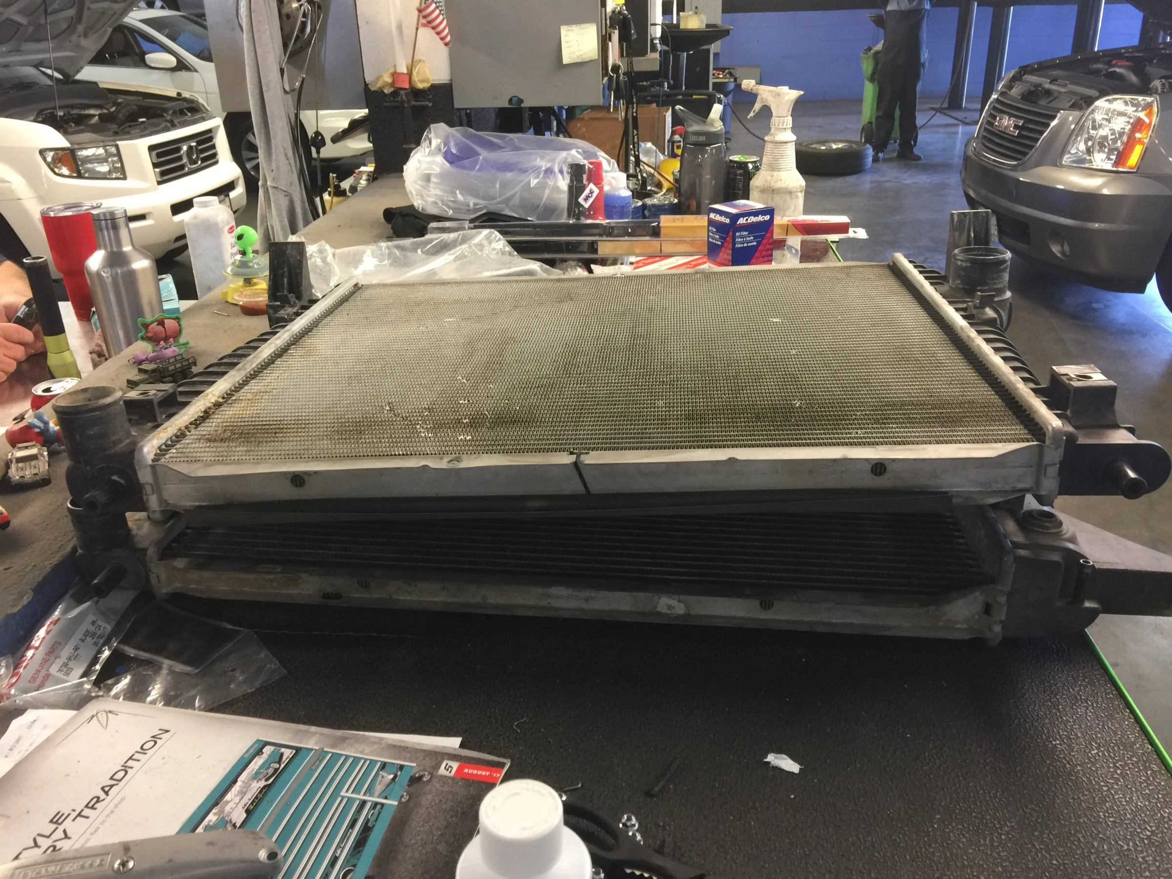

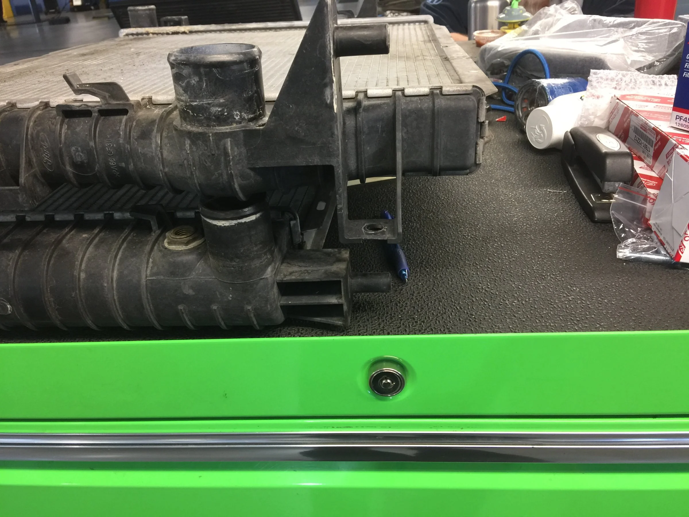

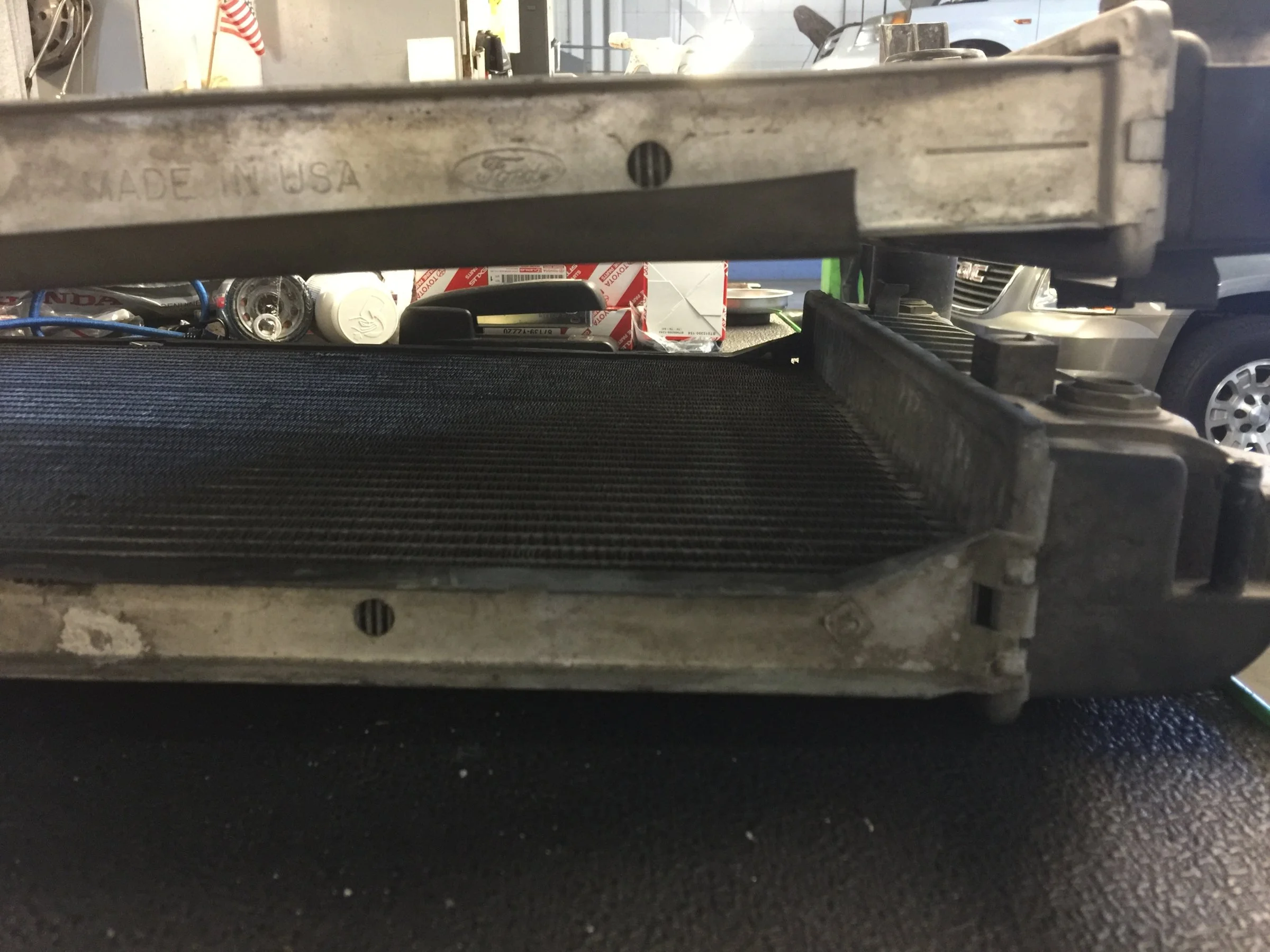

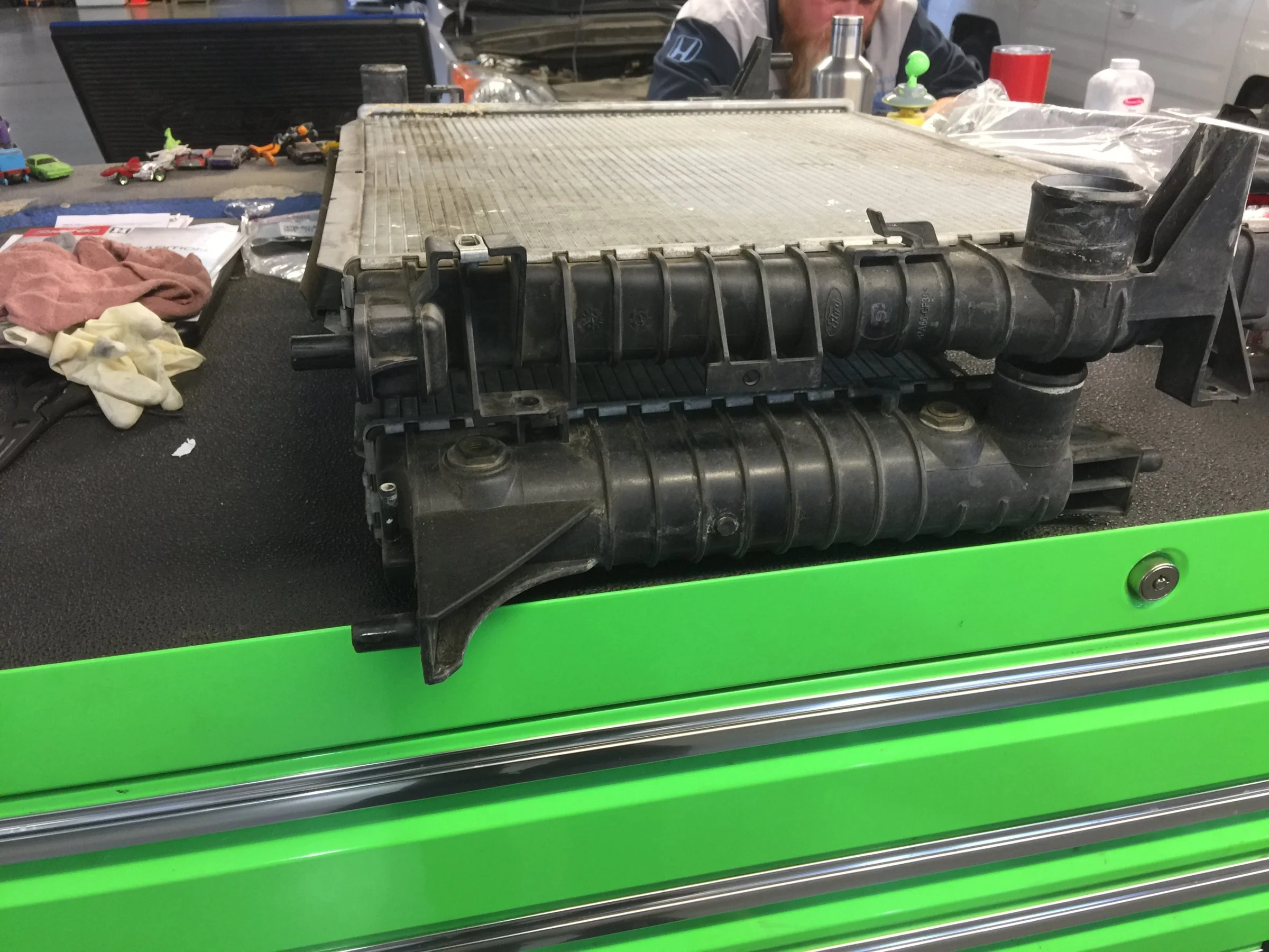

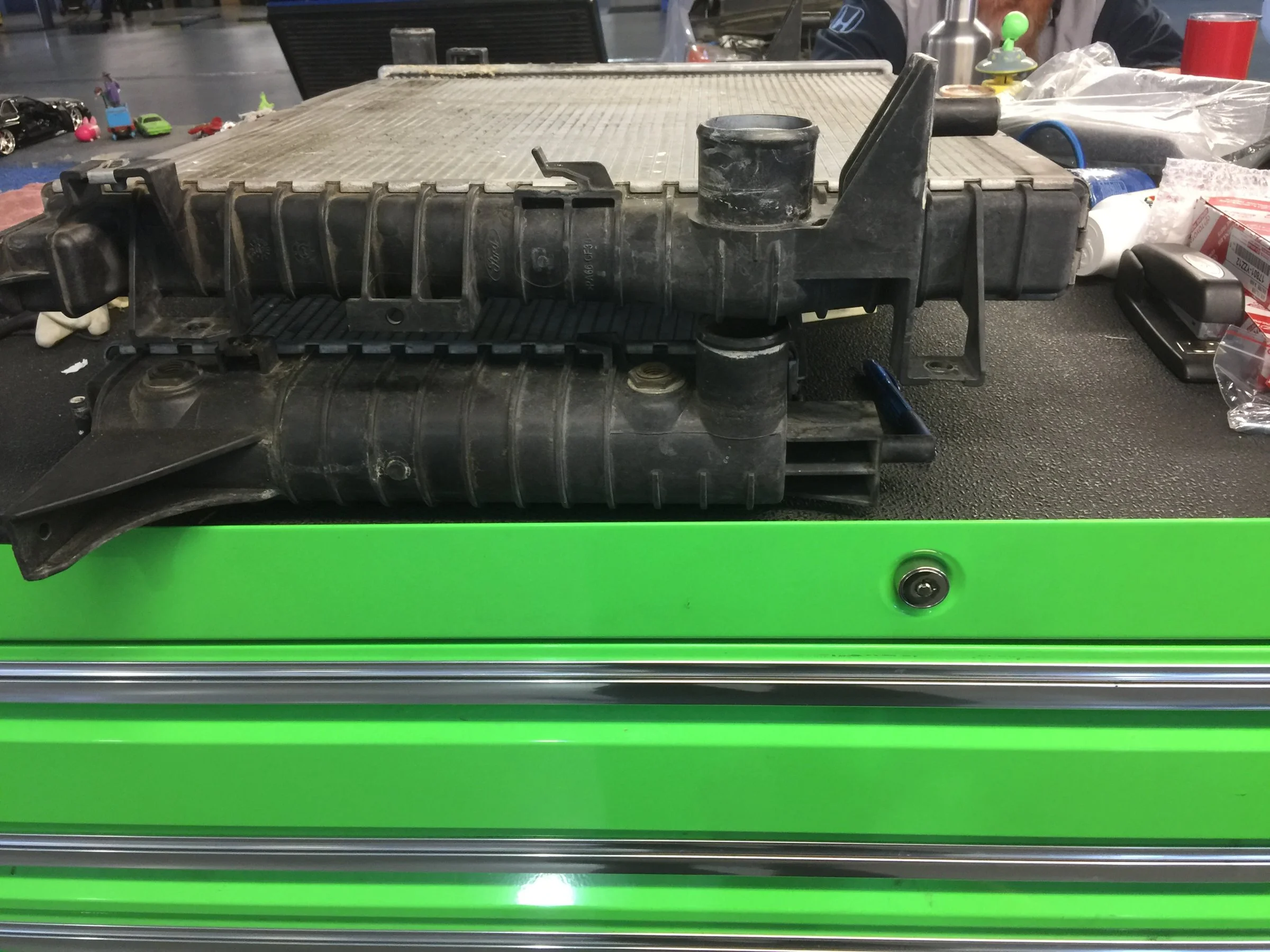

A comparison between the 08 gt500 radiator and a 96 sn95 radiator. The coolant hoses go in the same spot, the mounting points are exactly the same. The difference is the length. The gt500 radiator won't stick up towards the hood, it'll go lower towards the ground, it's possible it could fit but it might hit the bottom the radiator core support. And there is no coolant tank hose on the gt500 radiator, so you'd half to find a way to get a coolant tank to work, maybe tap into the coolant cross over tube on the intake or t tap a coolant hose. The stock radiator thickness is a 1inch, the gt500 is 1.75inches.

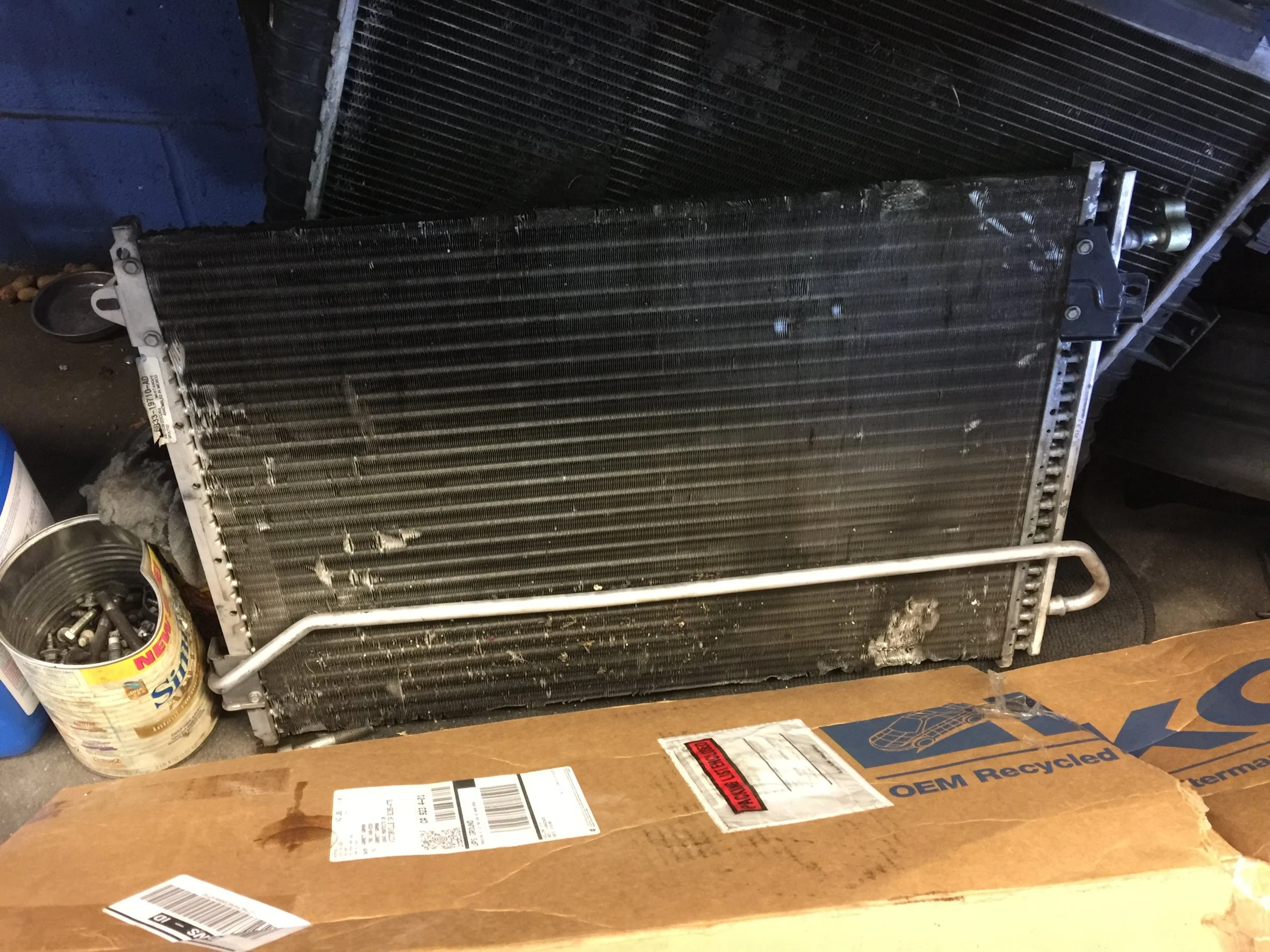

Old condenser is absolutely garbage. I hate that there isn't an edge enclosing the fins for the condenser, and I hate the pipe the runs across the back of it as well. Napa gave me one that was thinner, didn't have that pipe running across the back and the fins on the edges were not exposed. It's not a must to get a new condenser with the thicker radiator but it helped a ton, the pipe was too close to hitting the radiator and made me nervous. Tested the ac out yesterday and it gets ice cold! Had to turn it down after 5min of driving on the freeway on a 98-100 degree day so the thinner condenser did not have any negative affects on the ac performance. My ac is way better now than it was before thanks to the new radiator and condenser
