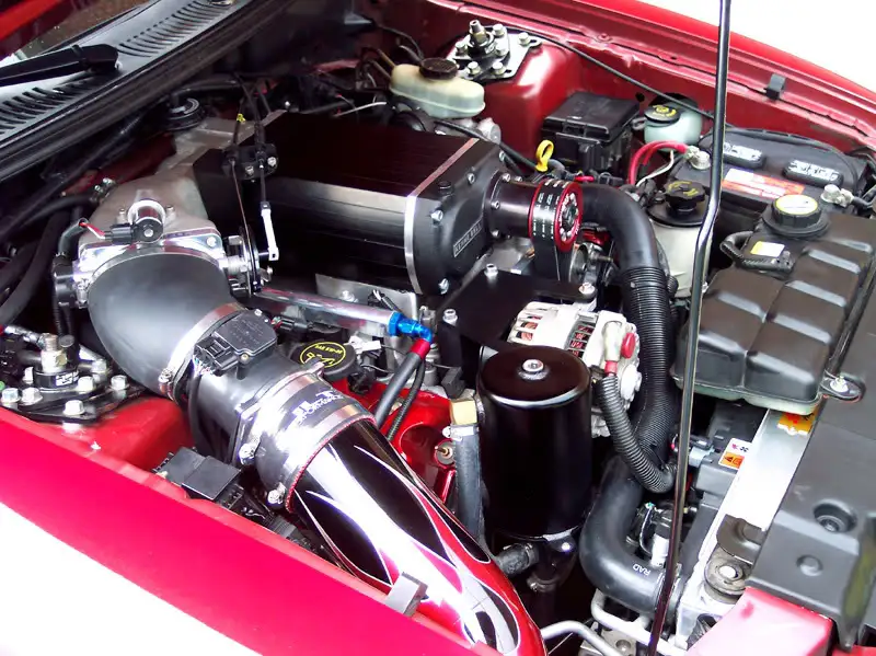

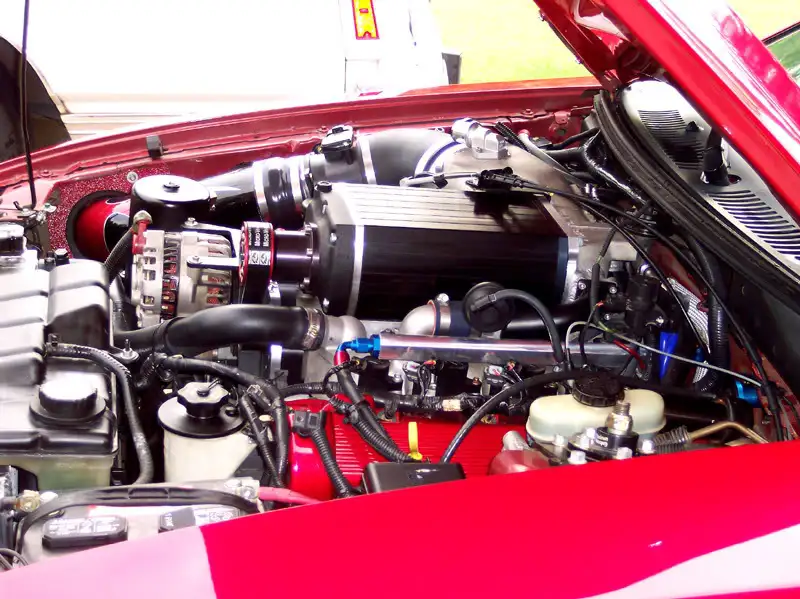

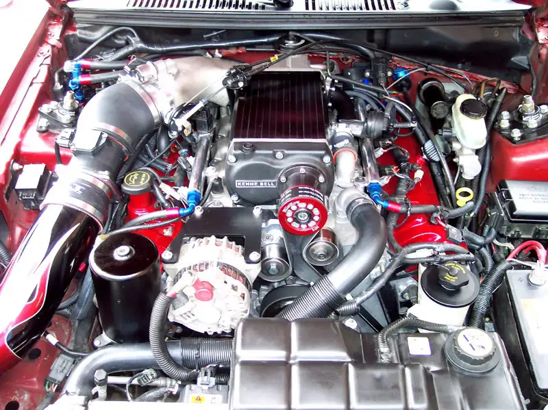

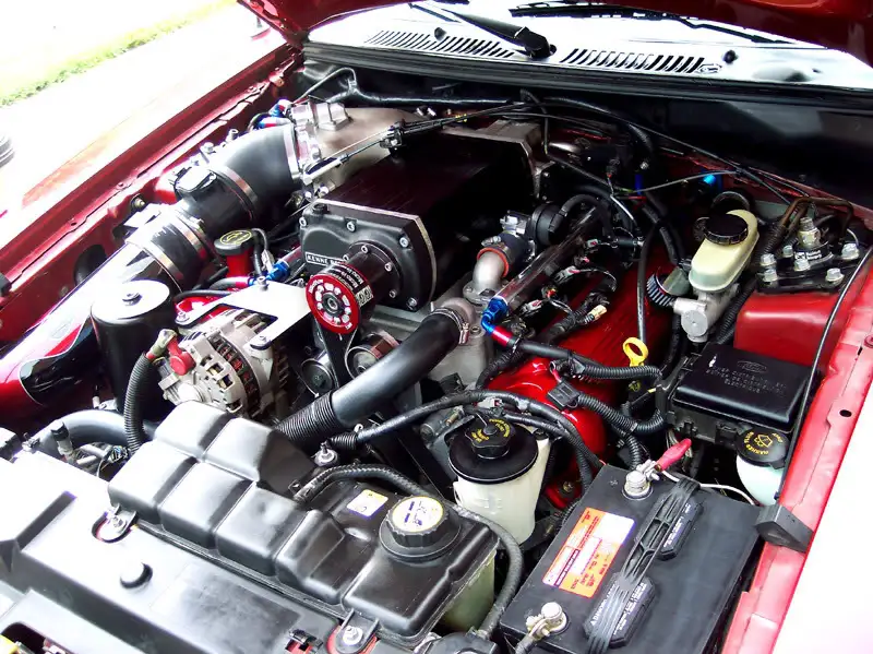

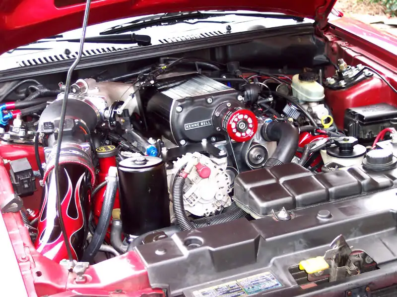

That is down right NASTY. Can you post any more pics/vids of your setup?
here's some pics. I'll try to make some vids soon..
