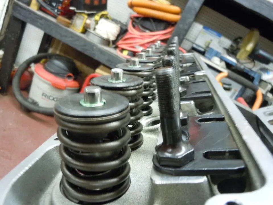

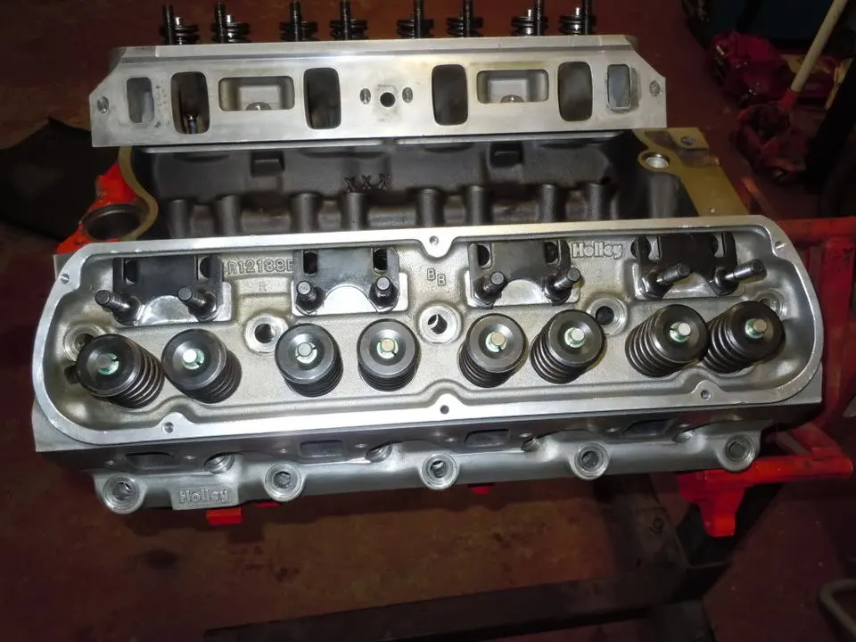

All those entry level heads are basically the same casting with minor tweaks to the port work. It will probably use stock length pushrods. You can check them once you have them installed.

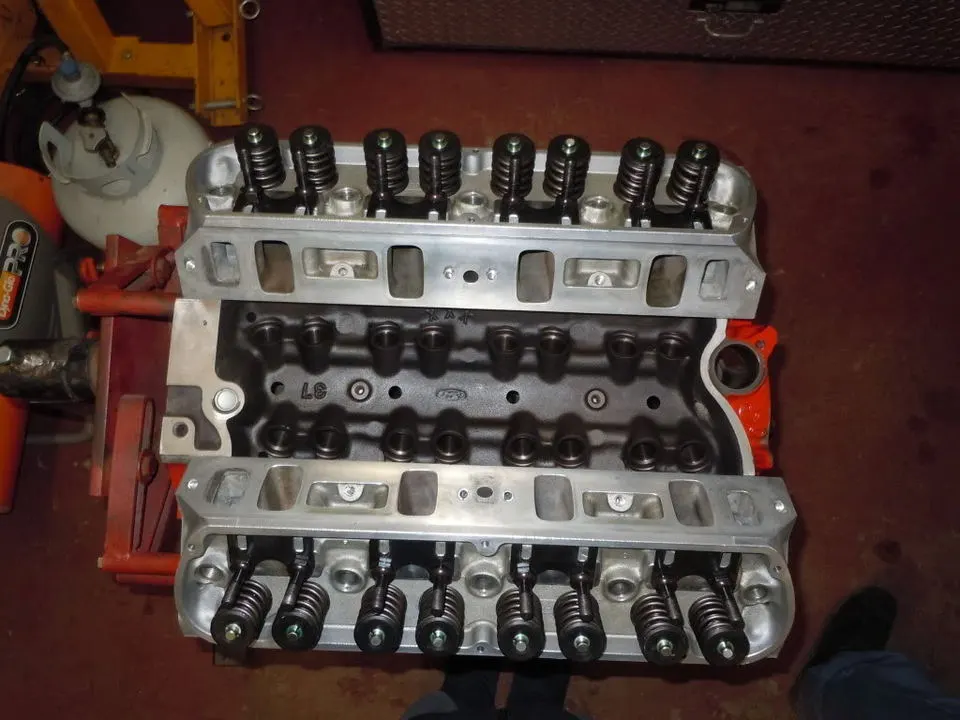

pretty dang happy with them but they will be checked by a machine shop oh and they are the 20deg heads.

While I can not say anything negative about those Holley heads, I will say you made an excellent choice over the E-streets. Not to hijack your thread or anything, here is my results from those heads, particularly with the valvetrain. WARNING: Edelbrock E-Street Heads - Ford Mustang Forums : Corral.net Mustang Forum The casting of the E-streets are a bit rough; but the flow numbers are comparable with AFR 165's, TW 170cc, etc.

Rockers: 1.6 Harland Sharp or Scorpion. Stay away from the el-cheapo Proforms. They are small, noisy and cheaply made.
Like everyone has said, it would be wise to check for pushrod length. Chances are, the rods will be a 6.27(unless you have the TF heads or one with the canted valves, which the Holley's might be).

No not at all ill take all the info i can get. And I already ordered a cam I went with the 281HR magnum Wish you would have posted earlier lol. I think i did pretty good with the heads they go to the machine shop tommarow to be checked out.
Just got a quick titbit of information on those Holley Heads while looking through Corral. Woody of Ford Strokers says that the valve guides on them are junk, and that's why the burn oil. Valve guides are inexpensive, and if they are as bad as he says they are, this is a good time to change them. I trust Woody's expertise.

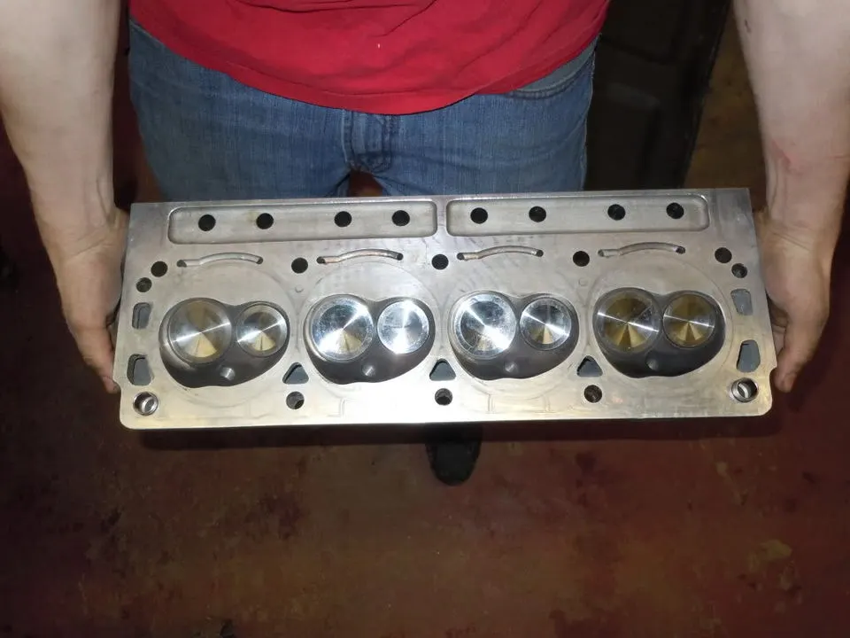

well they are completly rebuilt with good stuff. Oh and good news I took them to the machine shop today the guy had them for 3 hrs or so. He said they where a very nice set of heads and he could not find a single thing wrong with them.:D That was a huge relief.
