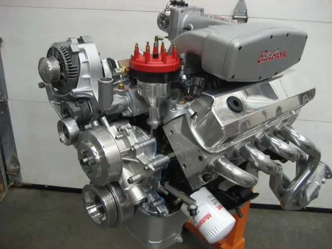

The block color gets kinda muted out on our motors to me...we have so much peripheral crap you really dont see much...I choose Black as it's easy to touch up. Depends on your choice of intake/VC color and such... I went with mostly Aluminum colors on my parts. Alot of the block is gone once you add your front brackets/accessories. Bout the only area that shows is under your heads...unless your gonna do a wire hiding job and maybe have no AC ???
For example here's mine all built...you see jack once the AC bracket goes on...
