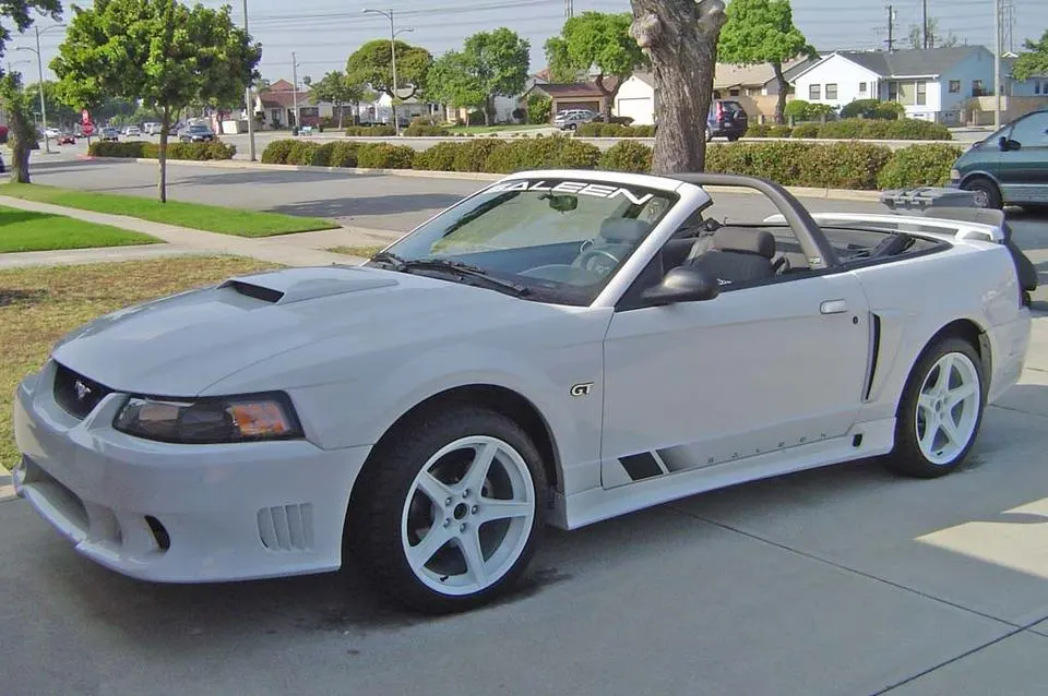

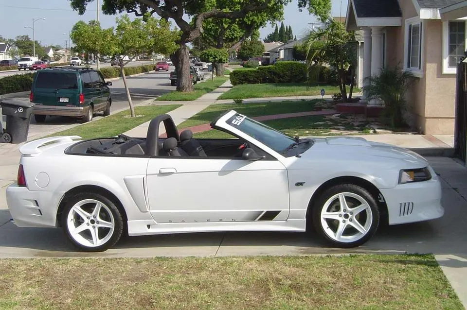

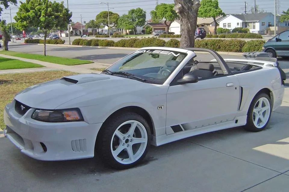

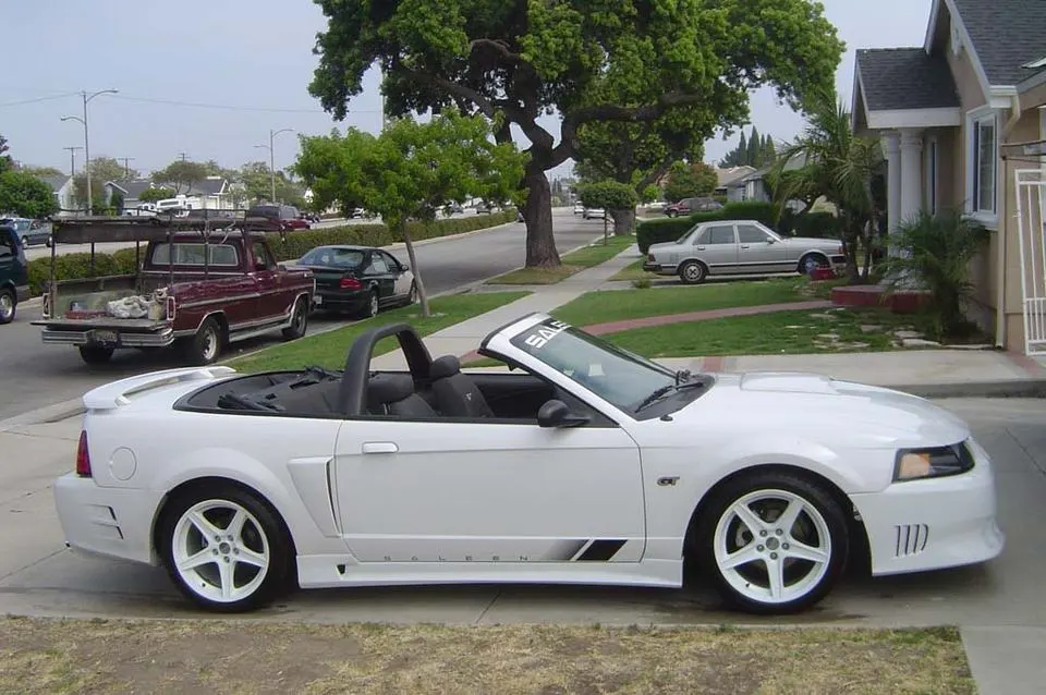

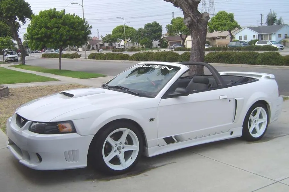

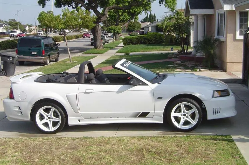

I just got my H&R Super Sport springs, caster/camber plates, and Bilstein struts/shocks installed today at Chicane Sport Tuning, what do you guys think of the drop? I feel some difference in handling, do you guys recommend anything else for a close-to-Mercedes like handling?
Before (stock springs):
After (with H&R Super Sport springs):
