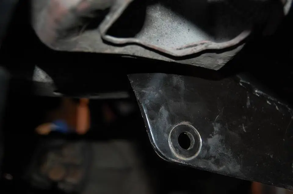

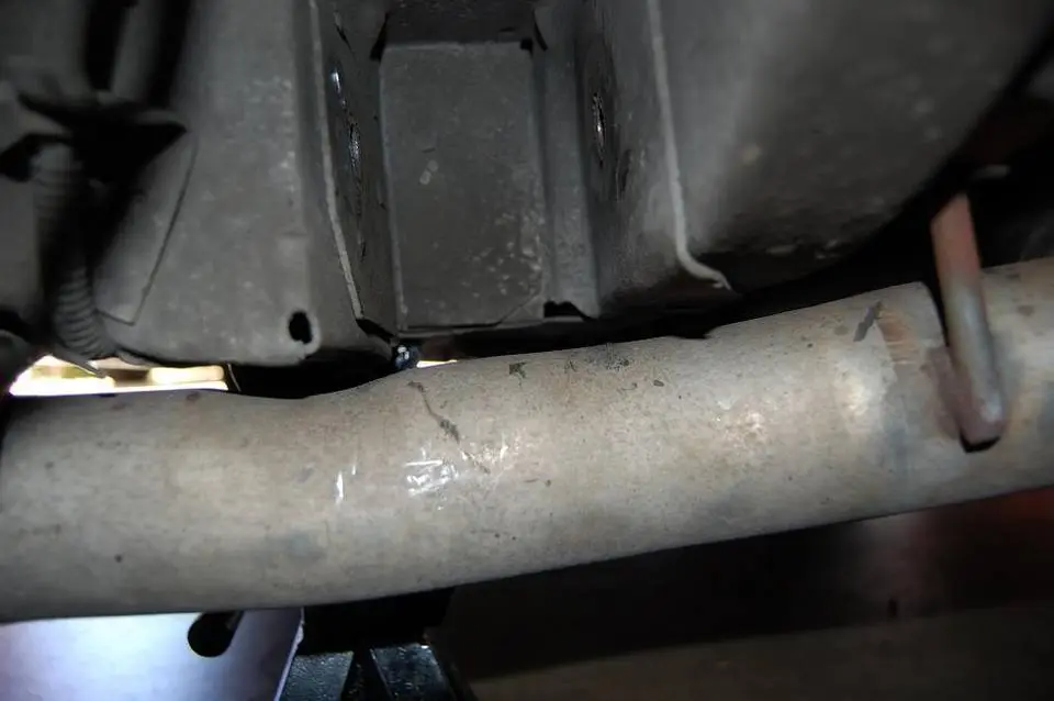

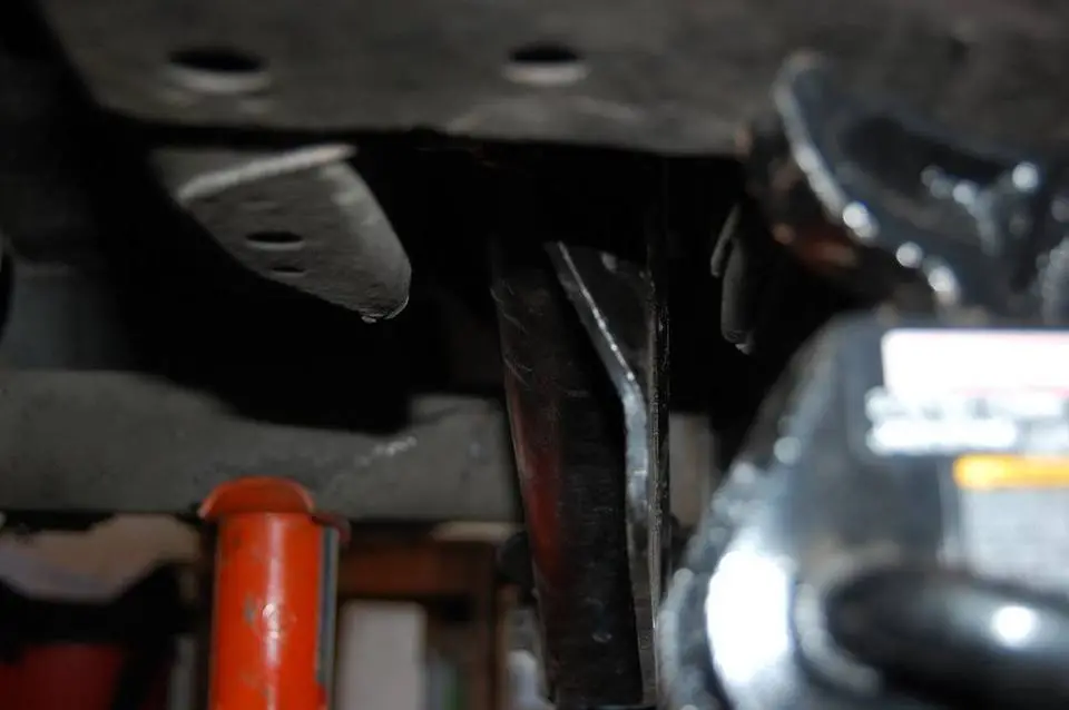

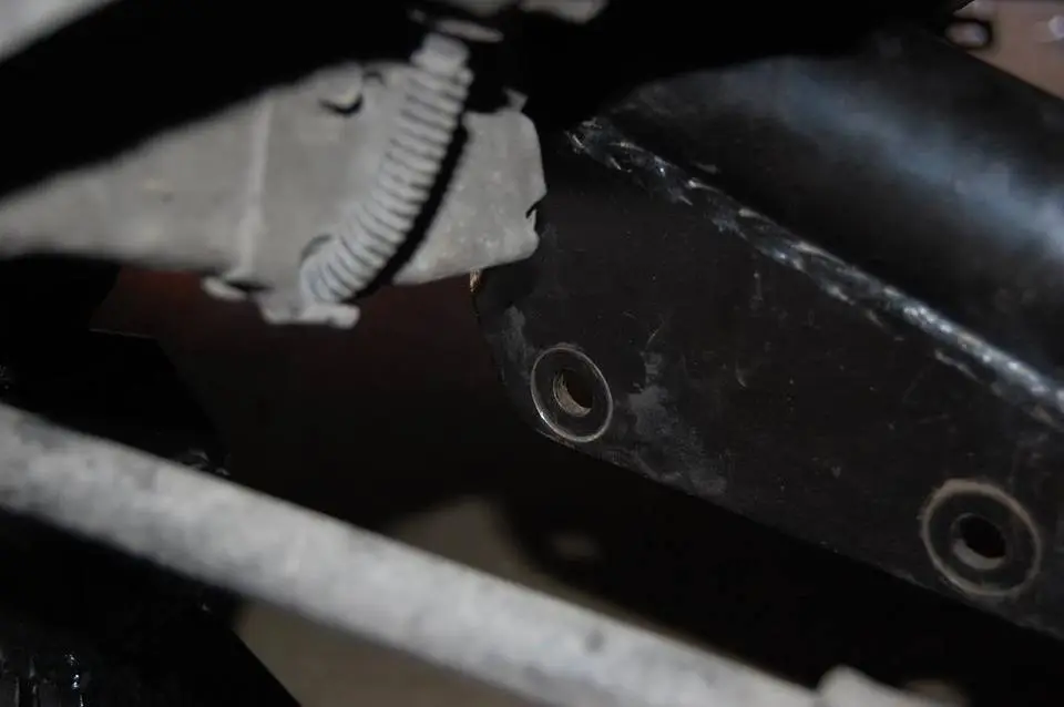

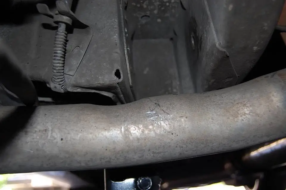

The sway bar mounts on the MM adjustable LCA's i just put in sit about 4 inches lower than stock and therfore slide in the control arm nook/recess a lot lower and hit my side pipes really quickly - like it's not even about to go in with this thing there.
So lose the side exhaust and go dumps? Or have some place work around it somehow?
Anyone have straight through mufflers I can buy off them to make dumps? I'd prefer to sell the side pipes as a useable kit.
You can see the scrape marks where it hit the pipe before sliding int far enough:
From frot of car back looking at it installed w/out pipes in.

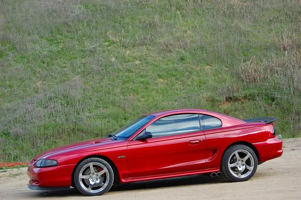

How it looks with side exit pipes (both sides):

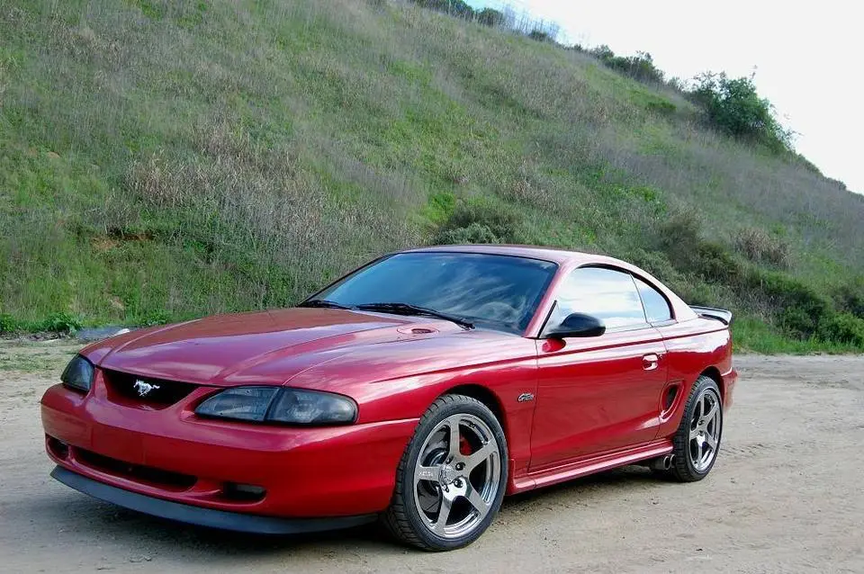

I'd have to say it makes the car much more docile at idle, but WAY louder with the pedal down. You guys are lucky with that body style because your rear bumper doesn't have the cutouts. Personally I would run dumps on that beast, but that's my biased opinion. Either way, the car looks abaolutely AMAZING. Those wheels are :jaw:
Can't be worse than it is now with no mufflers being dumped due to the LCA's:
YouTube - Mustang after new suspension
Not so calm at WOT.
And thanks, the wheels are Roush forged RR03's for 05+ stangs:
http://i219.photobucket.com/albums/cc118/CobraRed_96_GT/Picture001-4.jpg
Man when I think of side exit i always think of your car. I love how you fabbed that exhaust together. Since your stang is an aero(obviously) and dont have tailpipe cutouts dumps would "look" natural. I am getting a bit tired of my exhaust setup(dumped), but it does sound great. I also agree about getting FLSFC's so dumps sound like a good idea.
Chris, as much as I think your side exits are sweet, & original, I am about suspension 1st, so I vote that you either take them off, or get them fabbed to work. Subframes & LCA's are very important mods, especially when A LOT of power comes into play. I prefer rear exit tailpipes though personally & I think some nice polished Flowmaster tails would be my choice over dumps...
