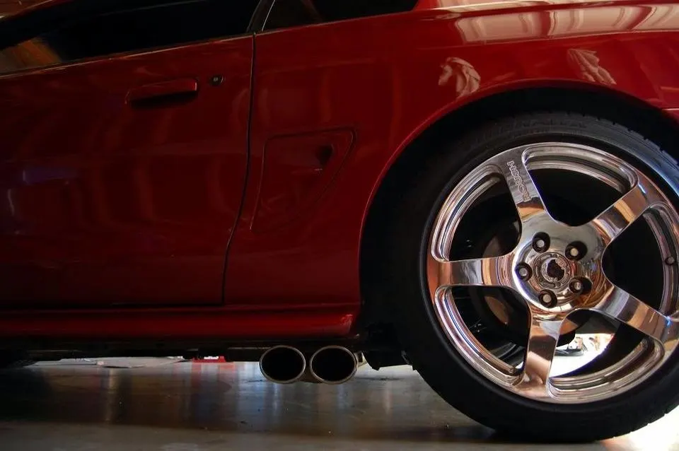

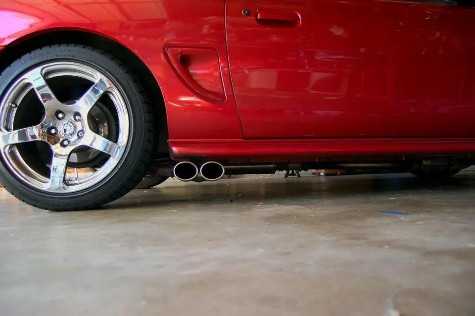

I'm trying not to mess up the side-exit kit as two people are already asking me if im going to sell it.
That's my #1 prefrence. But i cant find borla stingers ANYWHERE and I work at a mustang parts place.Why not just sell the whole catback as a kit, & get a custom Borla stinger catback made with dumps?

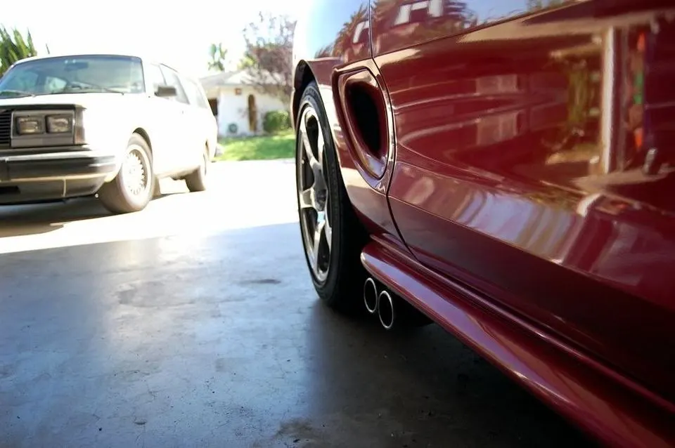

How would that help with clearance?Chris, couldnt you do fabricate something like this. I think it would look real nice on your car.
and go to GTR High Performance Mustangs, talk to Gonzalo or Eli. Im 90% sure they stock borla mufflers, along with every other types.

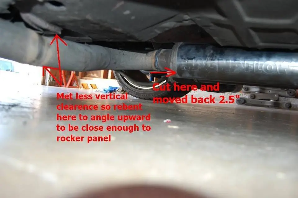

oo i didnt realize u didnt have subframes. i was thinking you couldnt go forward because of subframes.The problem isn't up and down (well maybe for sub frames) it needs to go forward to clear the LCA's. Also, in that pic those are just the tips, the pipes arent that shape.
Note updated postJust go to a decent exhaust shop. They can take care of that easy. It needs to be a good place though. Ask around for someone that does custom exhaust work and that'll be a breeze.
I can fit Spintech subframes in there - it just wont be l33t. And it probably sounded better because it was exiting so much closerBoo, no subframes
