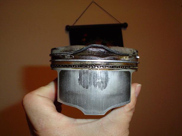

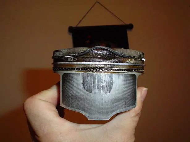

Most of the failures are due to heat issues. There is an issue with coolant flow in the drivers side head. Also, Ford made the piston clearances too tight, so during long WOT pulls, heat causes the pistons to expand too far and in some cases they actually seize in the bore and scuff the piston skirts, crack ring lands, and such. If you are using the car for a fun daily driver, you should be fine. Most failures I have seen come from beating the ever living crap out of the cars.

EXAMPLE....
