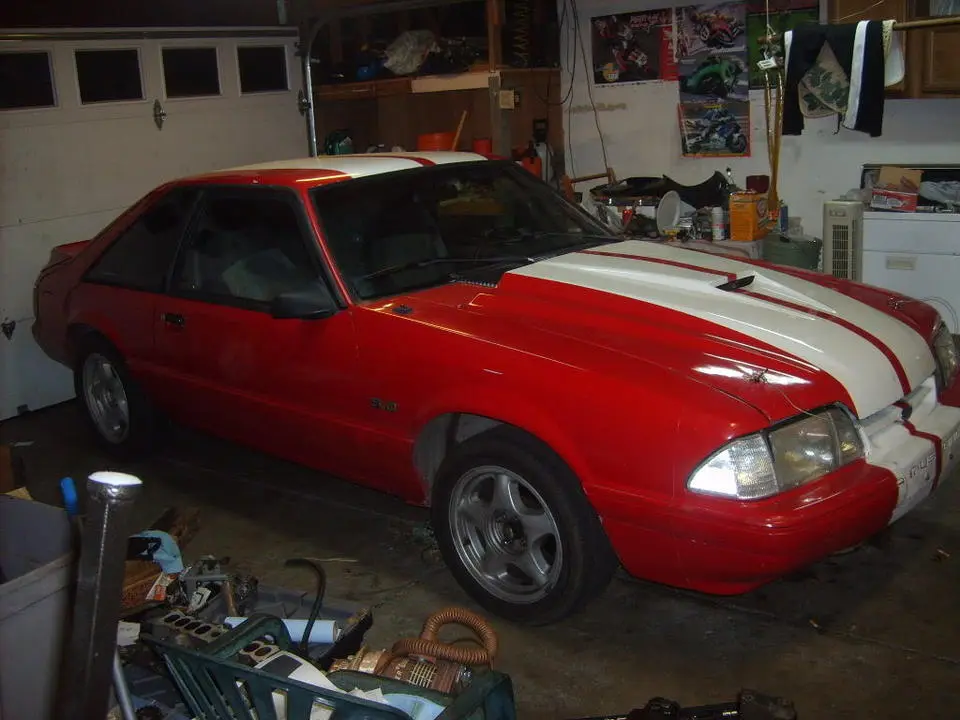

How about a couple pics of the car and maybe an under hood shot.

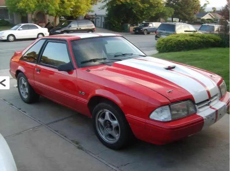

Well call me whatever, but....you sure you don't own a Honda and wanna get a rise out of some stang owners? NAWS? Post a picture or two and then we can get started.........
I hope that these will work, I dont know what you need pictures to see, but ok.

I know this car! Were you banned before? I know earlier this year or at the end of last year you posted this car and had all kinds of problems. What was your old user name? :scratch:
Ive never been on here before.
For someone who knows nothing about modifying Fords you seem to have a 302 intake lower sitting next to the green chair!!! :eek:
I personally call BS at this point. But out of boredom ill entertain it. :rolleyes:
Chris
It came with the car.
