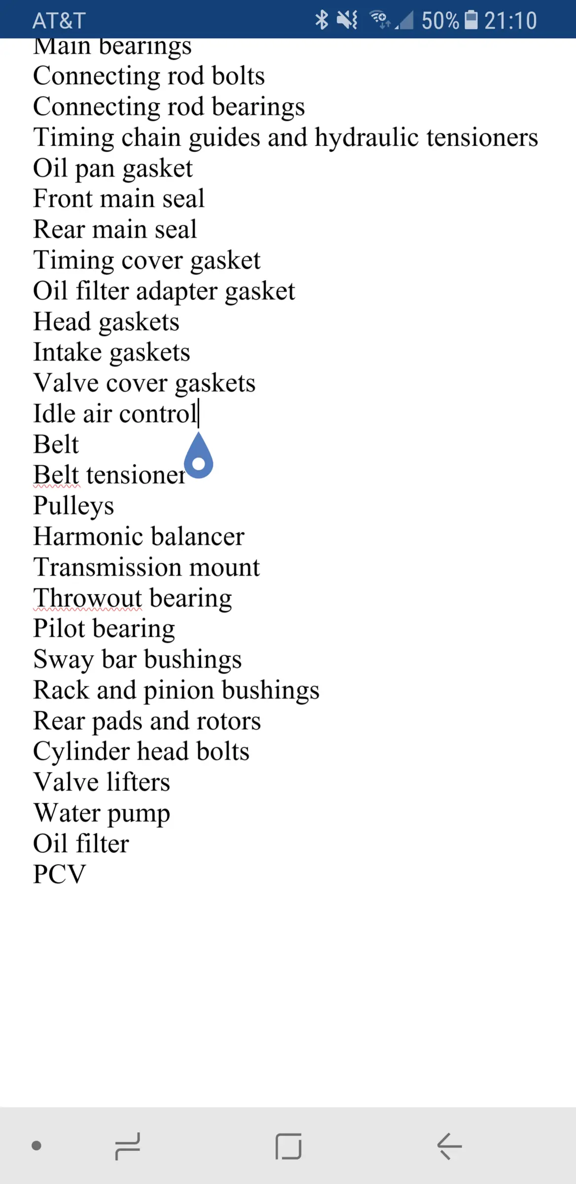

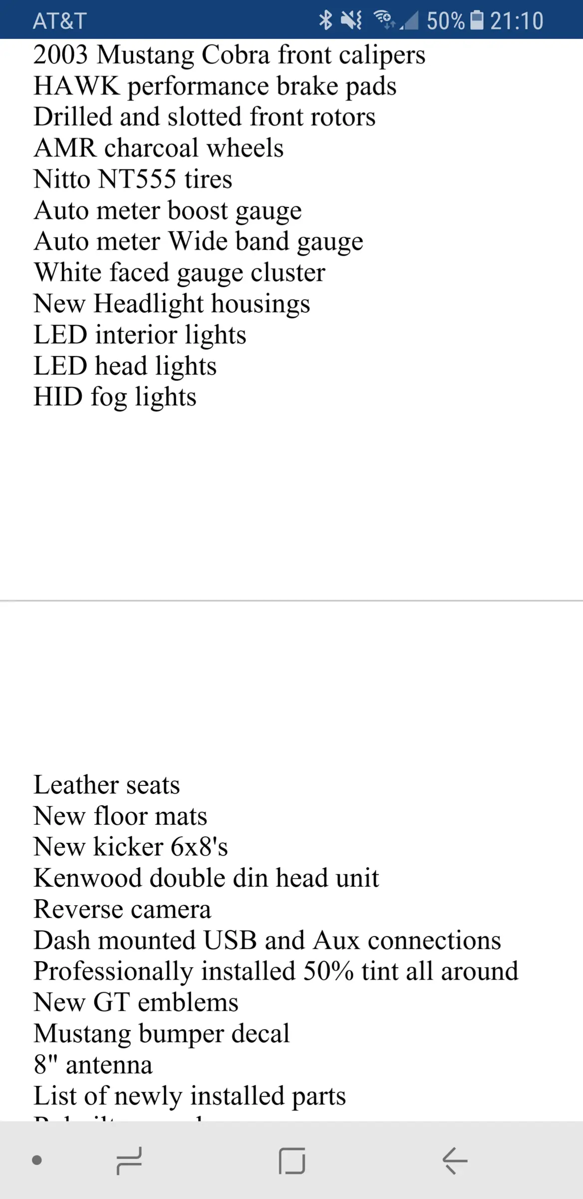

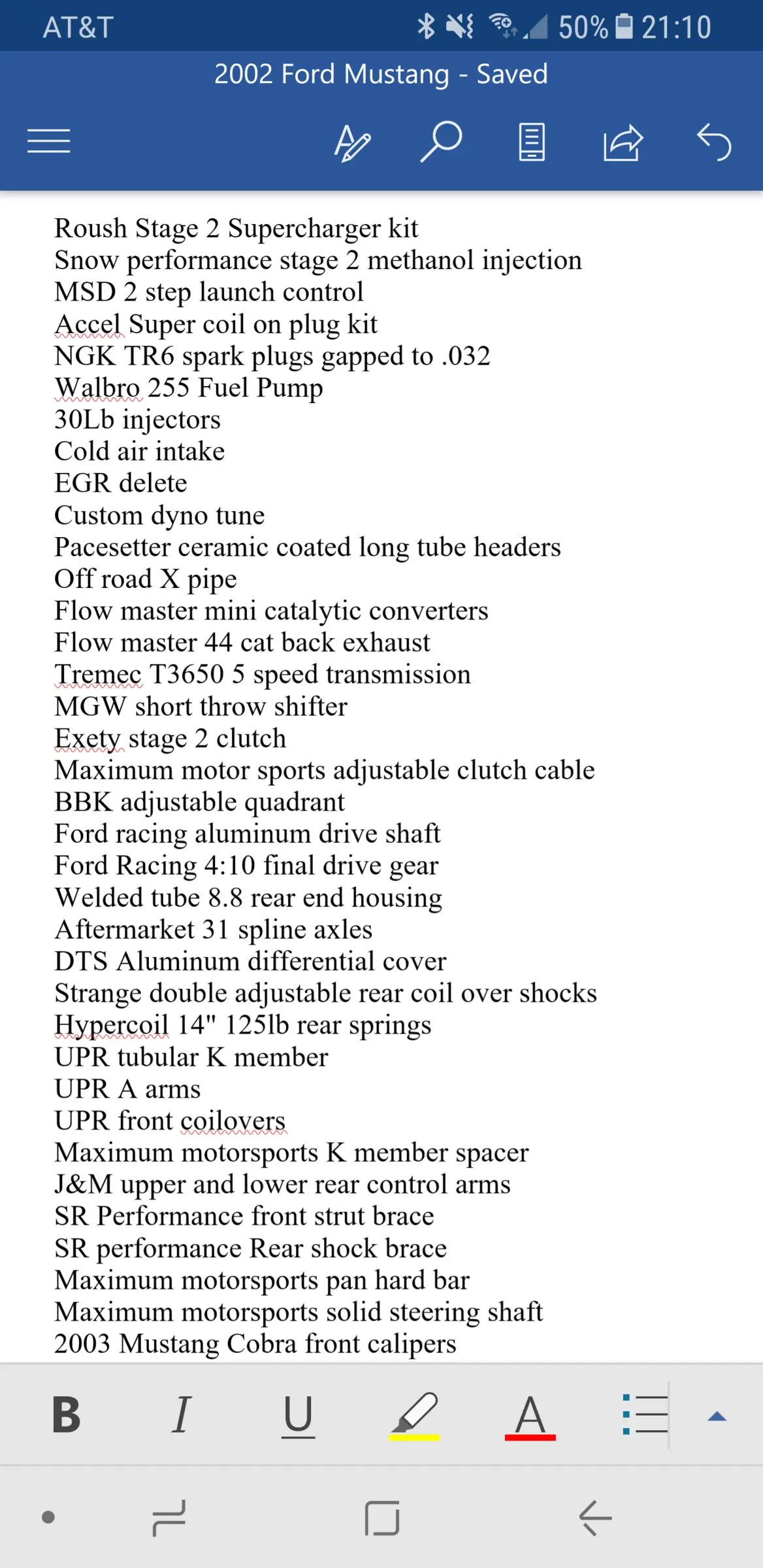

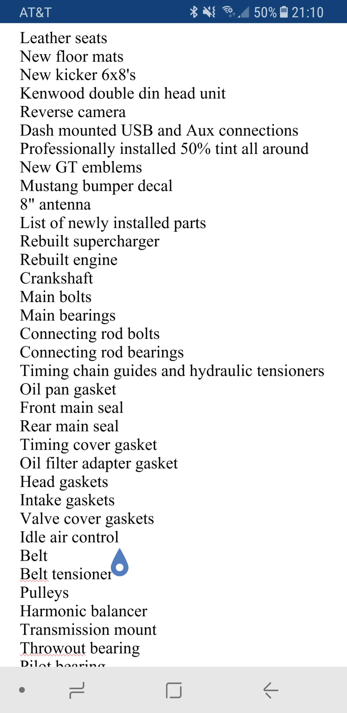

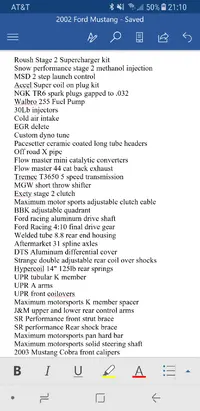

I have a 2002 ford mustang gt 5 speed. I bought her rebuilt with alot of mods. I will attach the mod list so yall can take a look at it.
Recently, i have had the infamous 2-3 gear grind due to the synchros goin out. I have looked into the kit (thanks to yall on here) for the fix and between the kit and the labor id be lookin around 12-1500. Currently, she still has the 5 speed transmission with a 4:10 final drive gear as listed in the mods list.
With that said; with the mods on the stang already, should i just do the kit and fix whats broke or should i go with a swap and do a 6 speed transmission? And if i were to do the 6 speed, what transmission and gear ratio should i be in the market for? Also keep in mind i will be bringing this to a shop to do, not doin it myself i dont mess with transmissions.

Taxes due then R/R your 5 speed. The 6 speed has an extra OD which might be nice with your 4.10's and if you get the right one it can handle more power. But you will pay dearly for it. The T56 is heavier but shifts real nice(the ones I have driven anyway). Unless you are going to buy a new T56 you will have to have your used one rebuilt unless you want to take a chance on a used low mileage one that may need rebuilding sooner rather than later. Since you cannot do the work its all about money.
I noticed they did not forge that engine so I would be real careful about increasing the pressure( a tune is mandatory of course) or you maybe getting rid of the car much sooner than planned.
Instead of the exra OD for better mileage from the T56, if you are hoping for some, I would drop down to 3.55 in the rear since traction is the real problem with this power.
