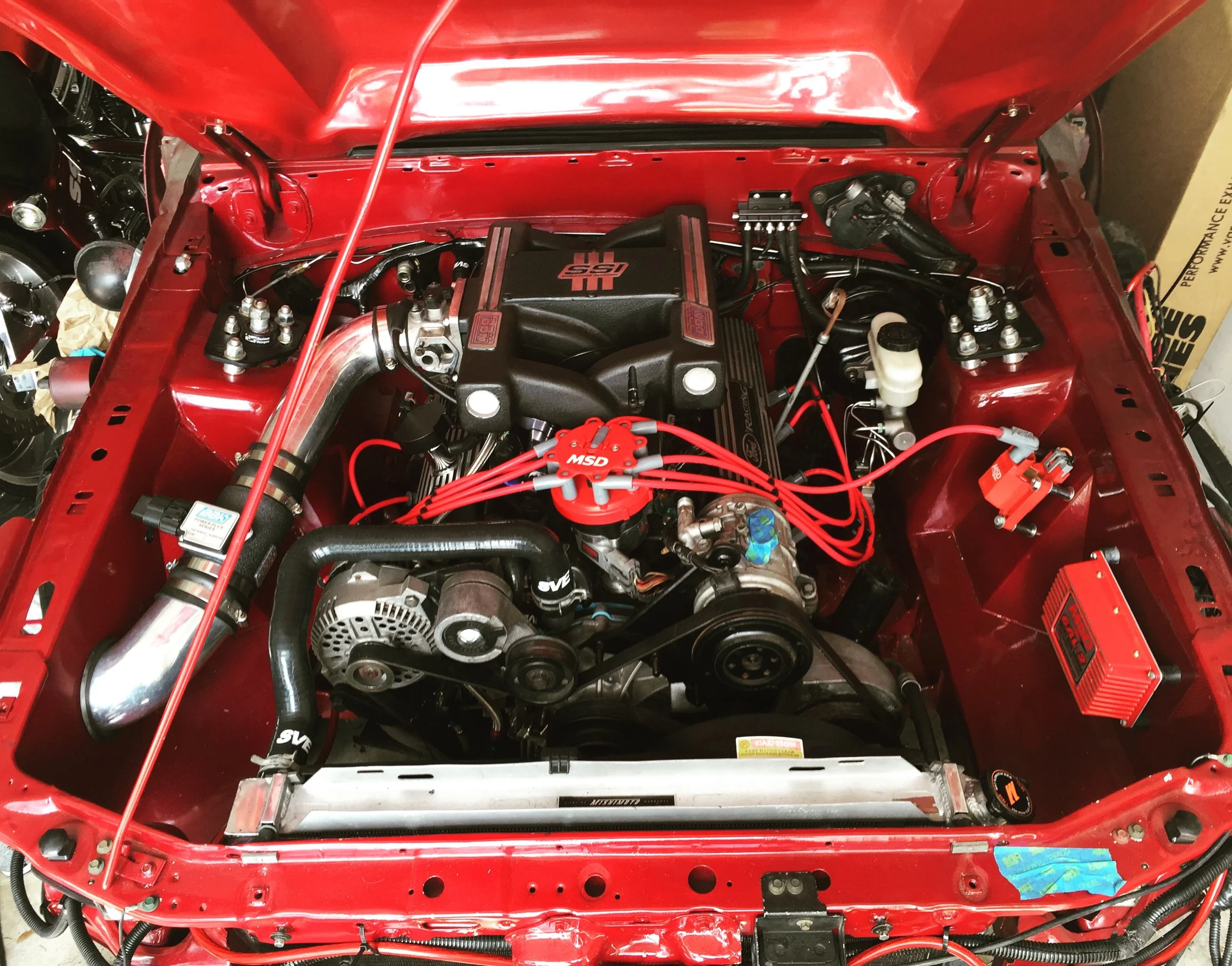

Welcome and that is a very nice fox you have! Great work on the engine compartment.. I do have a few questions though and I am not trying to bash your ride.
  • a 28 oz flexplate is not stock. did you balance the motor to 28oz and use a 28oz harmonic balancer?
  • a b cam is not a good choice for a 347 motor. It's not even a good choice for a 302 honestly.
  • SVE heads? are they 1.90 intake 1.60 exhaust? Again way to small a head for that motor
  • BBK intake- those are known to have gas and oil leaks and uneven distribution
  • IAC- where is yours
  • 2200 stall converter- way too low a stall with that motor. should be at least a 2800-3000
  • Do you have a trans cooler?
Again, your car is very very nice and I applaud your work. Wish I had your engine bay..lol.. however, to be honest the combo is a bunch of mismatched parts and you are leaving a lot of power on the table...

@mikestang63 I appreciate your feedback, I'm all ears when it comes to improving my car. I purchased this car bone stock, was my daily driver for a while, a fun daily:nice: but in regards to the mis match parts you've mentioned I am not well versed to the best combo of parts and went off suggestion of an old buddy who used to work on mustangs of sorts back in the day. He's pretty old school as you can tell from the b303 cam suggestion, mentioned it was the bees knees cam back in the day but of course with today's technology modern day grinds of new cams for this era of cars are a lot better. At the time school and work budget wasn't the best so hot rodding on a budget it was:rolleyes:. A couple bolt ons from the stock motor config I used here with my new engine build. I know I know the BBK SSI gets a lot of flak for leaks of sorts and I can attest to them, but once you know where all the trouble spots are and deal with those area's with extra care its not a bad intake plus its ported:nice:. The only bolts on I had on the stock motor before this major build was:
-bbk ssi instak
-70mm tb
-b303
-shift kit with aod and 2200 stall
she ran pretty good.
IAC:thinking:? Ahh no wonder the car won't idle right its missing, I kidd this picture was right before I was finalize her first start up and the 28oz flex plate + balancer are called for this particular Scat 347 stroker kit. The trans cooler is still the one built in with the Mishimoto radiator.
SVE heads flow similar to the Trickflow twisted wedge heads
Intake Valve Diameter (in): 2.020 in.
Exhaust Valve Diameter (in): 1.600 in.
Not sure if that is sufficient for the 347?
Mike I am having an issue getting the car to idle normally like before with the previous set up, based on the set up parts I have now would that cause the idle issue and what are your suggestions on the correct combo of parts for my 347? Thanks in advance
