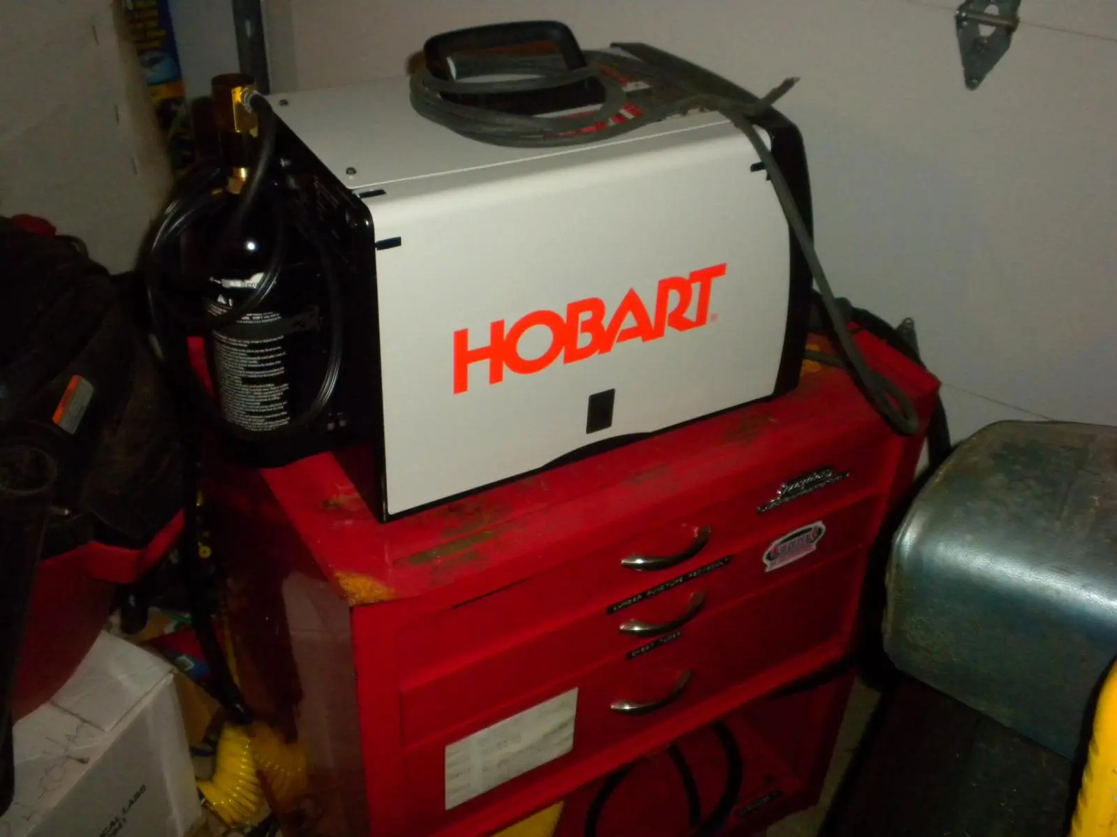

bought a Hobart handler 140. I have been wanting one for several years, but was either short on cash, or room to use it.
I was going to go for 220. But I pretty much will only use it for sheet metal.
Unfortunantly the welder did not come with tips, or a bolt to hold the clamp onto the ground.
I called Hobart and they are shipping one to me.
I also have to drive 30 minutes one way to get the bottle filled. Does anyone know how long a small bottle of argon will last? I believe it a 20 oz bottle.
The tool chest is the old trauma cart from my work. I revamped the crash carts and they no longer needed this one. It seems to work well to hold the welder and other bits.

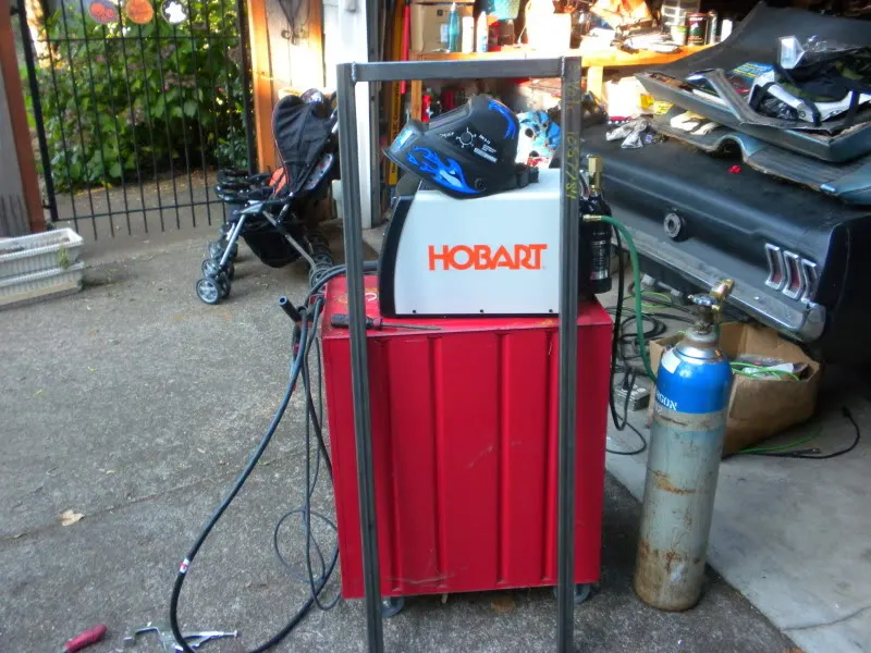

I went and bought a 92 CF tank today with 75/25 mix of CO2/Argon. I was going to pick up a sheet of 18 guage sheetmetal and some 1" tubing for a different project. Unfortunantly the bulk steel place was closed when I got there (At 4:30 in the afternoon:mad:)
The reason I went with a big tank was the cost was only $40 more. But the price to fill the bigger tank is only $9 more per fill. So $29 for the 92, and $20 for the smaller tanks. It made sense to go big and not worry about it as often, then fill up will eventually offset the cost of the tank. Plus It is a 1 hour round trip for a fill. I hate driving up to Eugene, and that in itself made it worth the extra cost.
However, I am sorely dissapointed with the Hobarts gas system. It came with a hose and regulator and the little co2 tank. Except the hose and regulators fittings will only mate with the little tank. So I have to buy them seperatly for the bigger tank. If the welder had not gone on sale, I would be returning it. After the refund, the gas kit was at a cost of $20.
The original price for the welder with the gas system was $130 more. If I had just bought the regular welder for the cheaper price, It would of only been $20 to $30 more for a bigger tank.

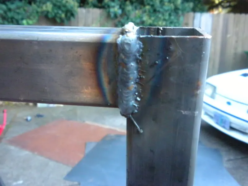

went out and played today.
This is non stang related. Its 1.5" square tubing. I should be fixing my floor pan in the next couple of weeks. I will post some pics.
