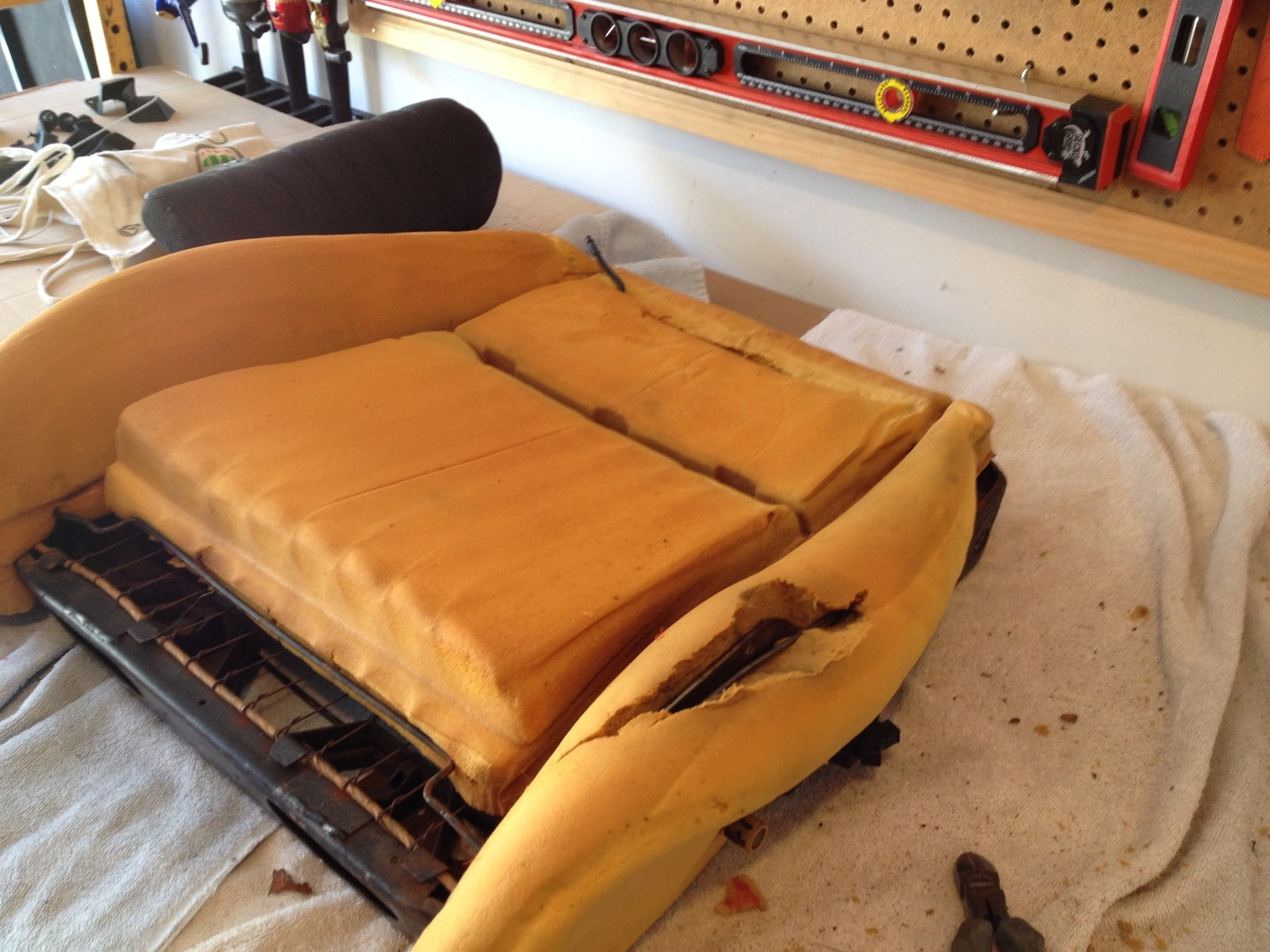

I did mine and installed new foam in the driver side I highly recommend doing that if it's in your budget the only thing is mine were fabric so I think they may be a little more forgiving then leather

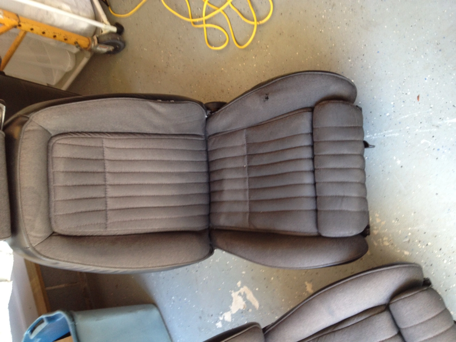

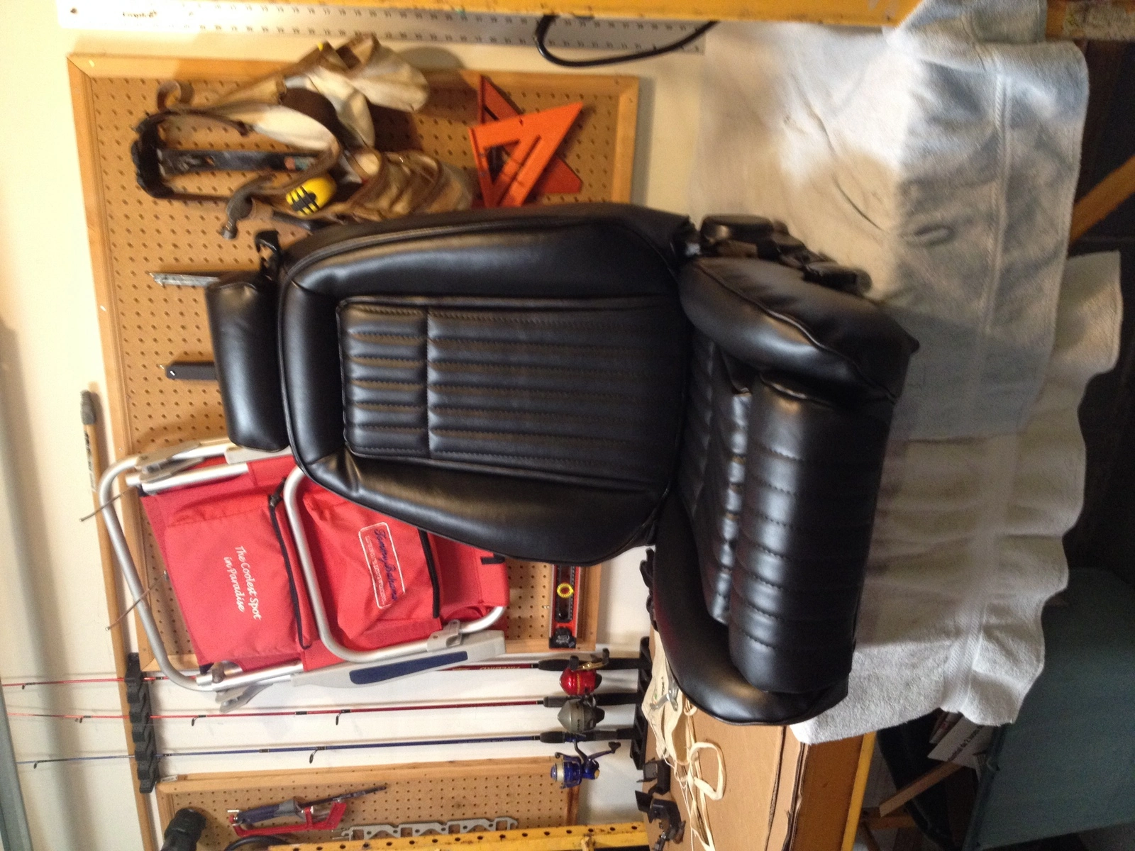

I just did mine a couple of weekends ago. I'm one of the links posted above by dnbonds. It was very straight forward.
Just follow along to the LMR video, take your time, and you'll be fine. I also replaced the padding on the drivers seat. The old foam was pretty much gone. I had cloth but went with the vinyl. I used a heat gun to make the vinyl a little softer and easier to stretch over the foam/frame. I noticed you were going with the leather upholstery. I had originally thought about it until I read the fine print in the description. "The upholstery features vinyl back & sides with a leather seating surface." I couldn't justify the cost difference for one strip of leather. Just an FYI. Good luck

I thought it was well made and it fit the stock frames with no issues. It really made a difference in the feel of the seat.
I really had no choice regardless. My original drivers seat foam was beyond worn out. I've seen some people complain that it's too thick and make you sit higher in the car. I did notice that as well but I chalked up to new versus 20+ year old foam, Besides, I'm short so it worked to my advantage.:)
