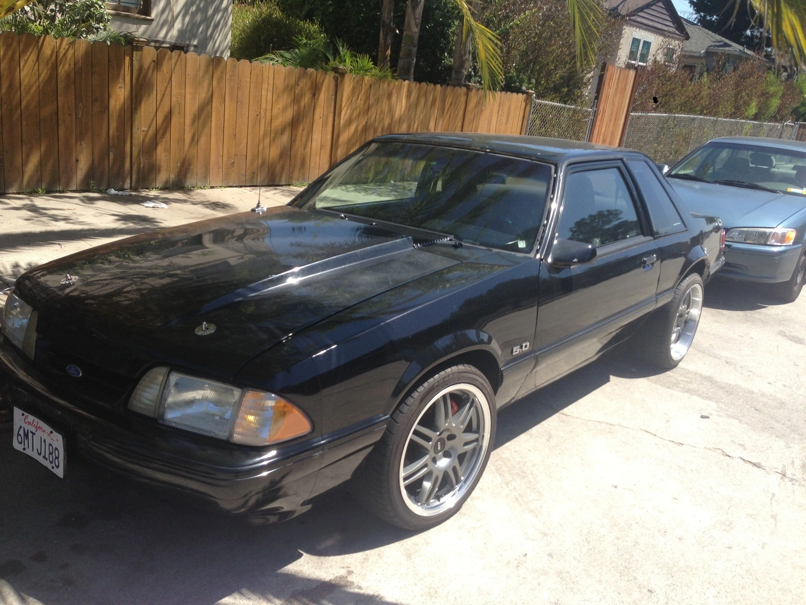

Here is a crapy phone pic. I'll get som more later
Oh and thanks 2000, forgot to add I have 24 lb injectors as well

Looks pretty clean to me.
Do you have a MAF that's calibrated for the 24# injectors? A MAF that's programmed for 19# injectors will not run right if your using a different size injector.
Good looking car, nice starting point compared to most people that join the fox game these days.

Thanks 2000! These cars are getting shoddier with age, it's sad. It's photogenic, but up close you can see it's not perfect. A few dings here and there on the roof, and needs a fresh coat of black paint at some point. It is a true ssp though, so I'm happy about that :)
