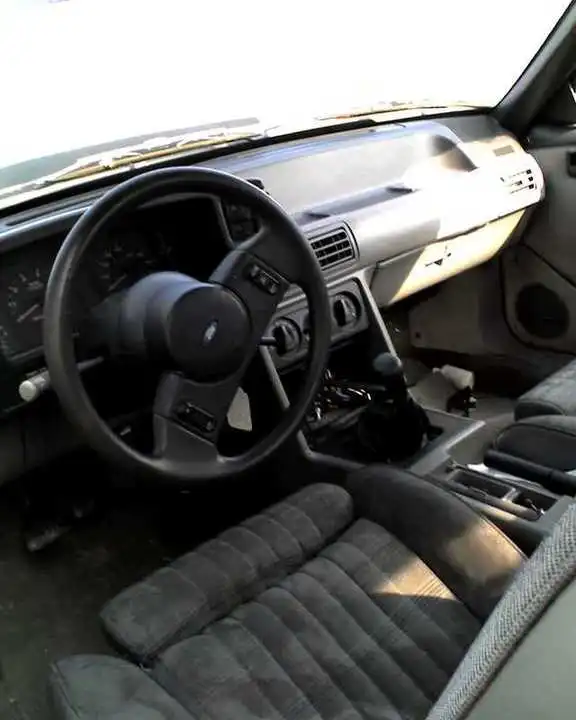

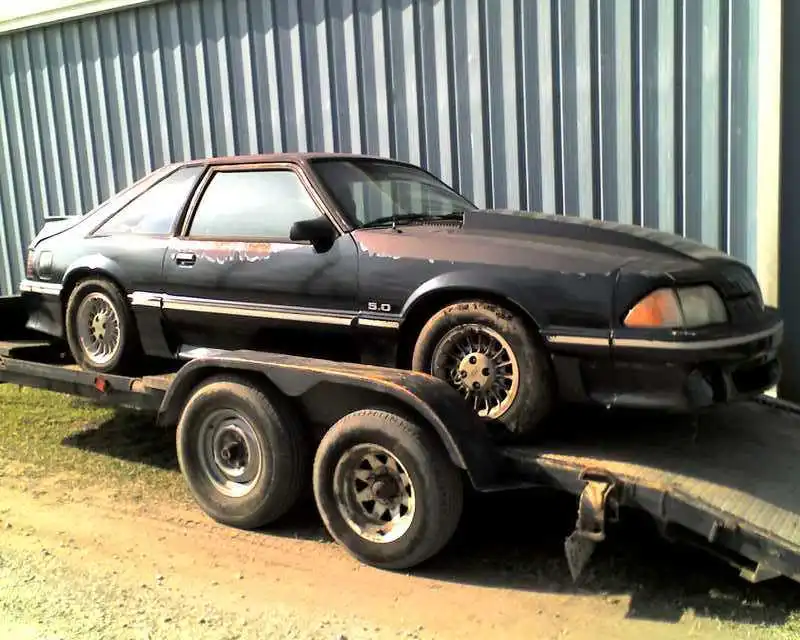

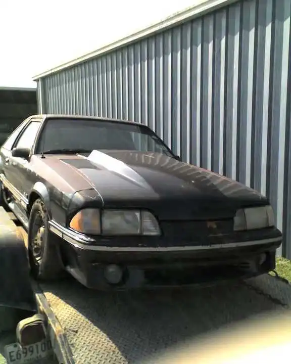

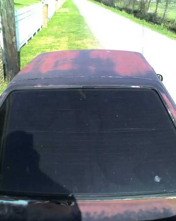

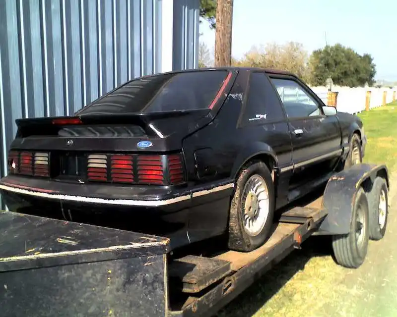

Hello all! I just bought an `88 5.0 GT. I was looking for a beater, to allow me not to have to use my regular car (`01 Z28) when I have to be somewhere for work, when my dad told me about a Mustang I could pick up for $700. Didn' t know much at the time, except it had a V8 and a cowl hood. I was also told that it did not run, and had been sitting for about 5 years. A few days later a deal was struck and the car was bought for $500. This past Saturday, my dad and uncle picked it up for me, and we' ll start trouble shooting to find out why it doesn' t run this week. It has a few dents, needs a front bumper, all new lighting, and a coat of paint, and it will make a damn nice driver for $500! :nice: Here' s what it looked like Sunday morning:
Well, there' s my background. I' ll be :nice: looking around, and researching as time progresses. I' m sure I' ll find plenty of information here. I do have one question though. Doesn' t anyone sell original GT taillights for restoration? I can' t find any new ones anywhere! :shrug:

looks like a good deal on the car, the body is a little rough cosmetically but its all there. the interior also looks be complete and in good shape.
should clean up nice. good luck with it
