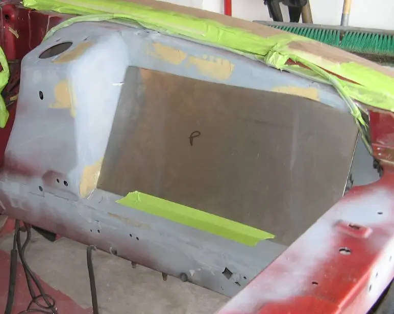

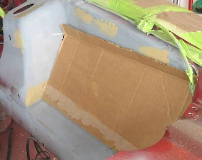

OPTION 2 WINS:
Cut Pass Side....I decided instead of cutting all of it out, to cut a "window" and then drop a diagonal, leaving the front open a bit.
Here is a dry fit with the cardboard. I think when I get done with this stage I will be happy that we back-tracked
Thanks again for pointing that out Adam!

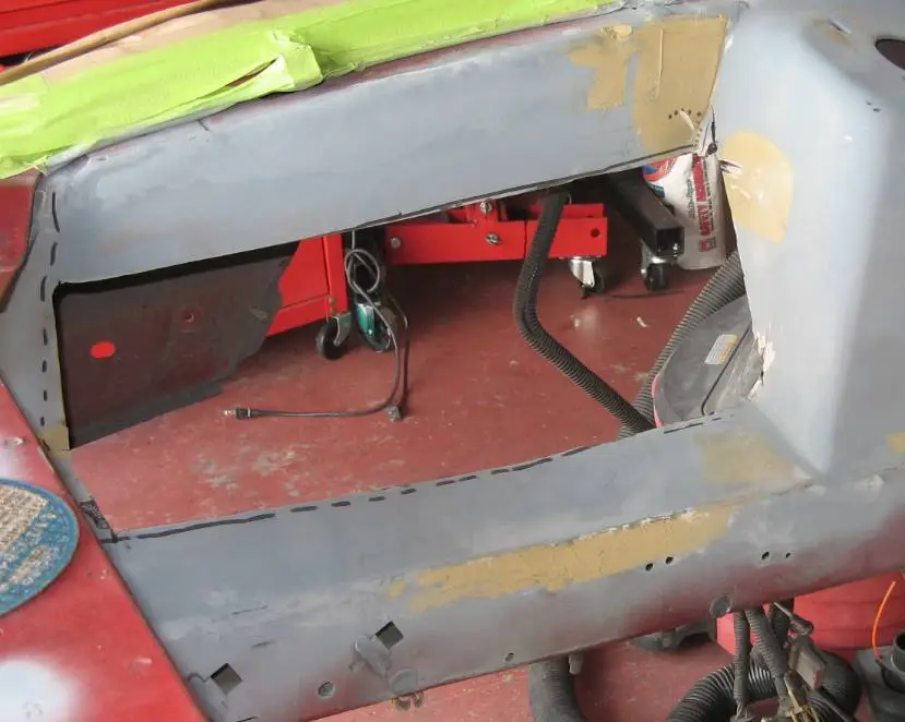

94GTLaserRC said:
Im wondering if we only need to do the pass side. The driver's side had the battery, which means there was more room to begin with. Ill do some fitting today and see.
Yobi: will be working on the yard after 11am, so give me a call before that if you want the TB.
RC
The section where the battery is won't be a problem, but IIRC there was a bulge next to the shock tower which probably was for tire clearance. To answer your pm, I just welded my plates over top of the factory sheet metal so tire clearance wasn't a problem on my car.
I COULD get to my headlight bulbs very easily by going between the radiator support and the back of the headlights. But I installed one of those UPR radiator covers, so now I have to remove it to change the bulbs.

Thanks...If I knew the "straight down" cuts wouldnt work, I would have left the stock metal there also. Since we went straight down, our stock metal came out.
Now that we're back-tracking, how do you think it will work with the way the last photo shows?
1....the cutout as seen in photo one "should" leave enough clearance?
2....the cardboard cutout piece should be at the correct angle?
Thanks

did you fit the tire again?
We shouldnt need to, judging by old sheet metal left behind and where cuts were made, but we can check before the next welding stage.. Going to get the metal today and some extra cutting wheels.
Thanks
RC
Looks good to me.
Maybe you could put your inner liner back in and see how close it is? If it fits, then you shouldn't have any problems with the tires fitting.

the cuts look better.

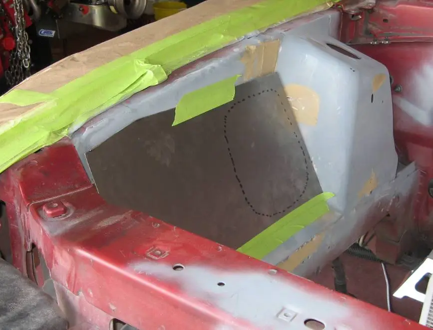

Is the line you made on the pass side the line for the power pipe? If it is, it seems too big.
Yes....I think we should try to cut it first.
ill be doing that to mine too... you need some room for when the motor torques, but not that big... right now i have the whole fender cut out for that doesnt look pretty at all
Id like to get some rubber trim to go around the hole so it doesnt scratch up the pipe too
