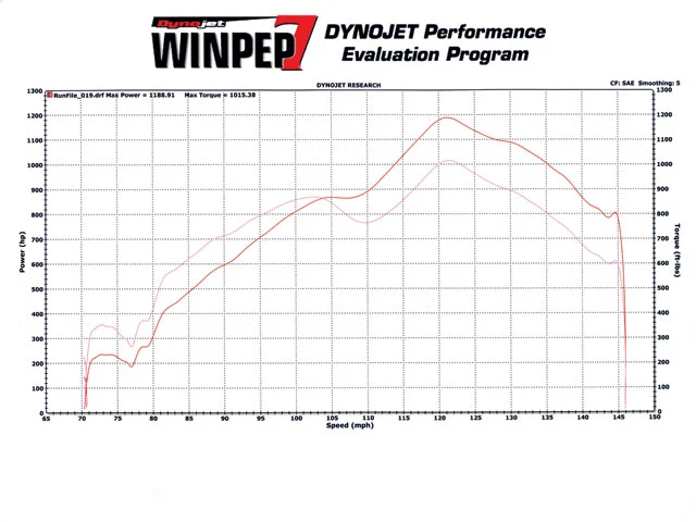

Now here's the dyno graph for a nearly 1,200hp Compound Cobra...
Don't see any power spikes, or lag in the power band at all, do you? And those dips you see every once and a while....that's where the rear wheels broke loose on the dyno.
Bad ass....sure, unstreetable...not at all. You can wreck a 500hp Cobra as easy as you can a 1,000hp Cobra. If you're not smart enough to control your urge to drive it with your foot in the oil pan all the time, then you probably shouldn't be behind the wheel in the first place.
