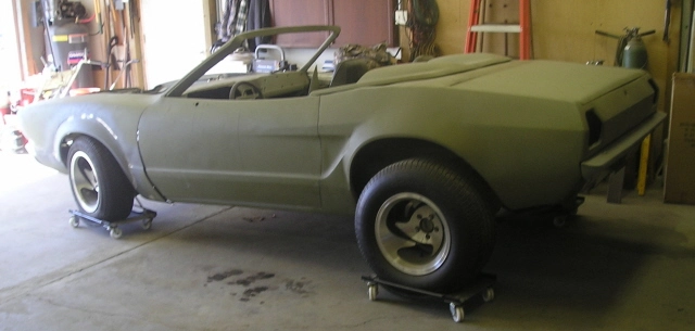

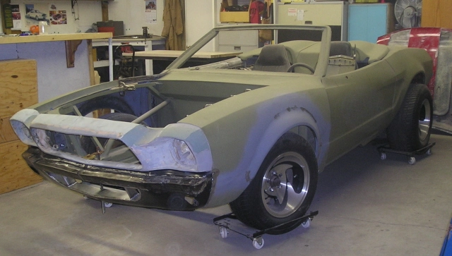

I like the whole thought process, no roof, raised & flared wheelwells, thinner bumpers, reworked nose...I'm only planning 15" wheels though.
RII
front flares are cut out of late 80's escort fenders and most of the back flares are cut out of 80 something AMC eagle fenders. All's been but welded together.
The back flares are the second set on it, I cut the first hand formed ones off because they just looked too big.
What was done to the flares in the photo shop pic is about the right size for the wheels in my eye. Now if we could only do something about the bumpers.
