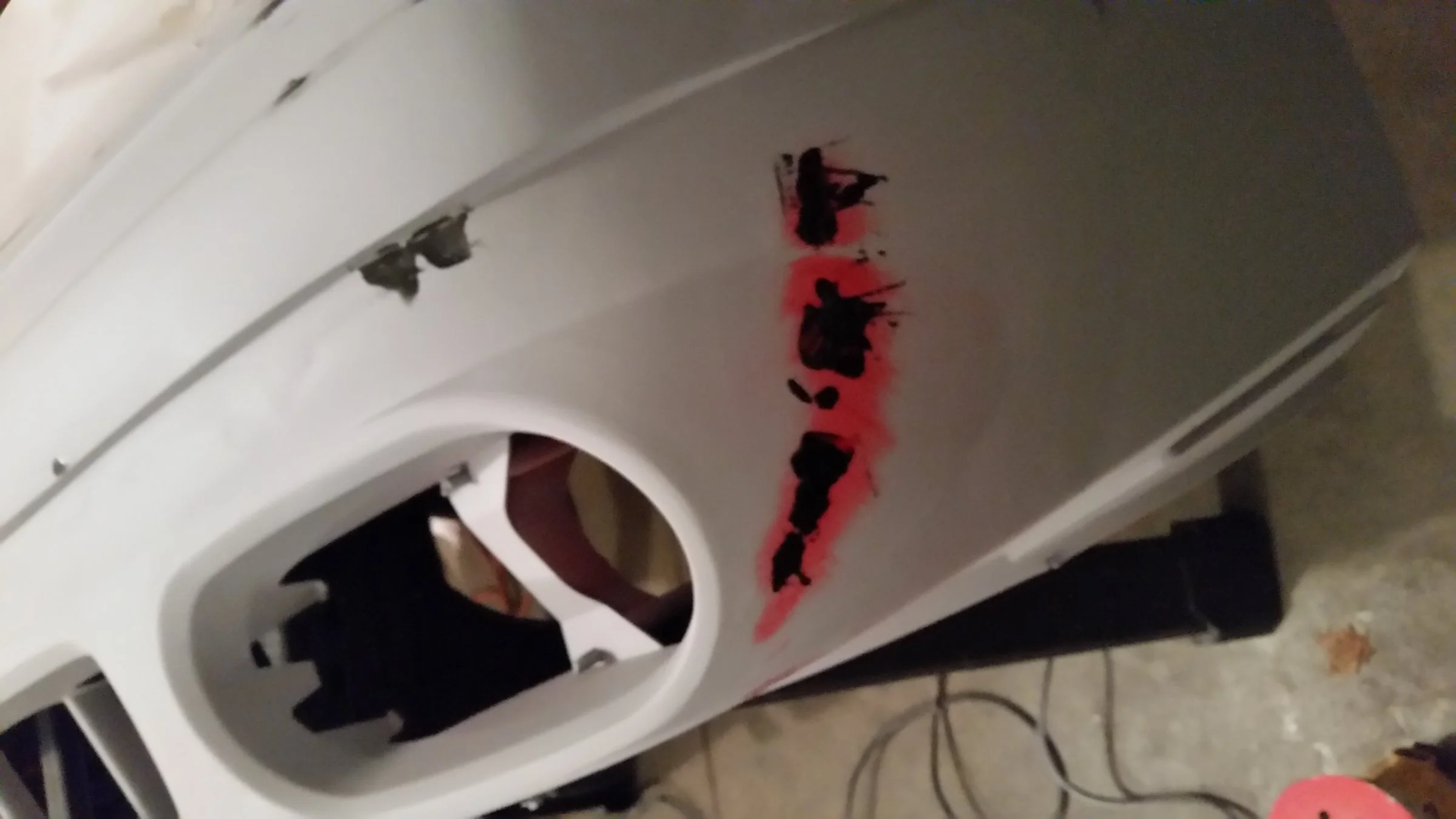

95BlueStallion said:
Got to spend a little time sanding tonight. Have I ever mentioned how much I dislike body work? I managed to get the bumper sanded to the point that its ready for primer. Since I was covered in dust and ready for a shower, I decided to stick it out in the rain to wash its dust off. I would post a picture, but it keeps doing it sideways again. Hopefully tomorrow evening I can scrub it down properly, and maybe even shoot some adhesion promoter and primer.
Aw hell, why not give you a sideways pic of a sanded bumper in the rain.
It's not sideways,..It's upside down, and it's dark.
Im trying to make it rusty so I can bolt it back on and take pictures just for you.

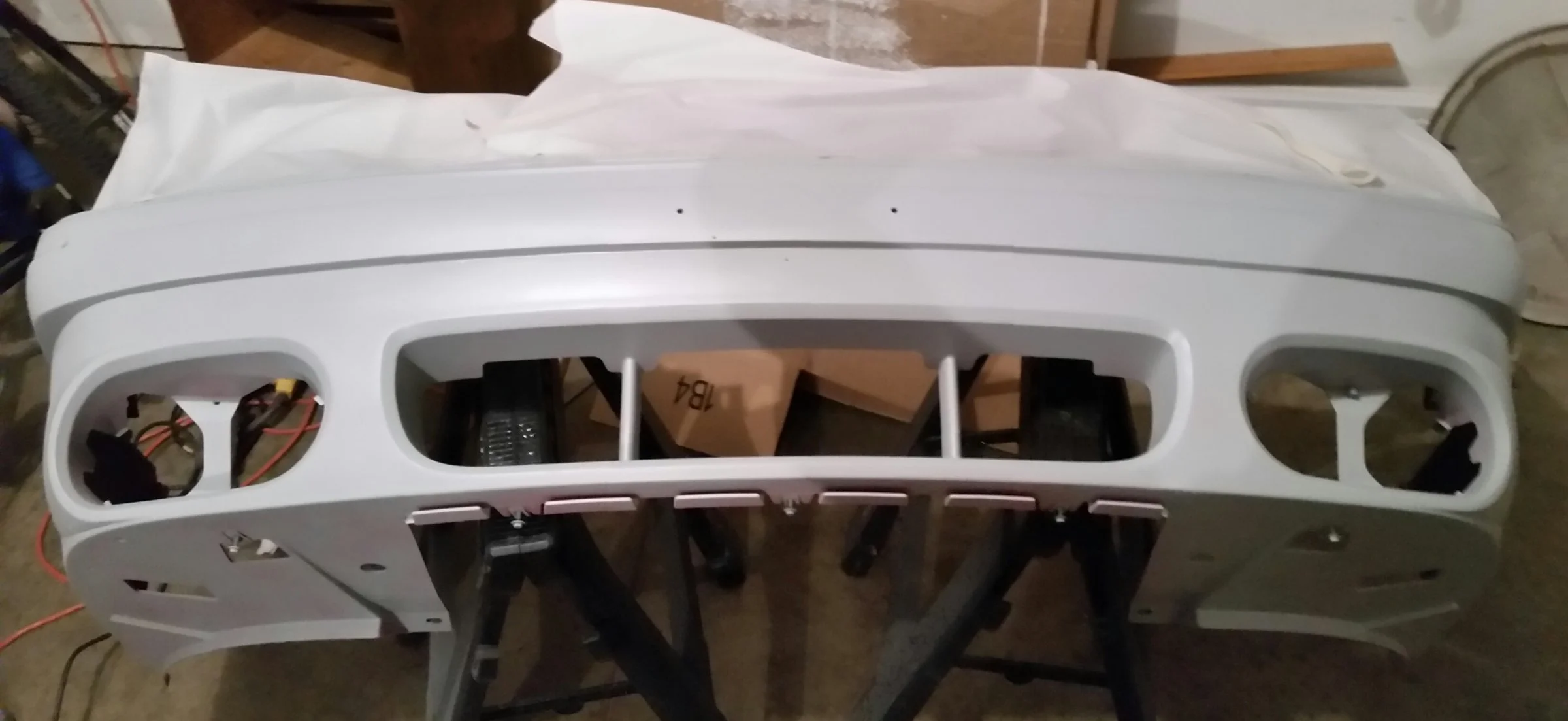

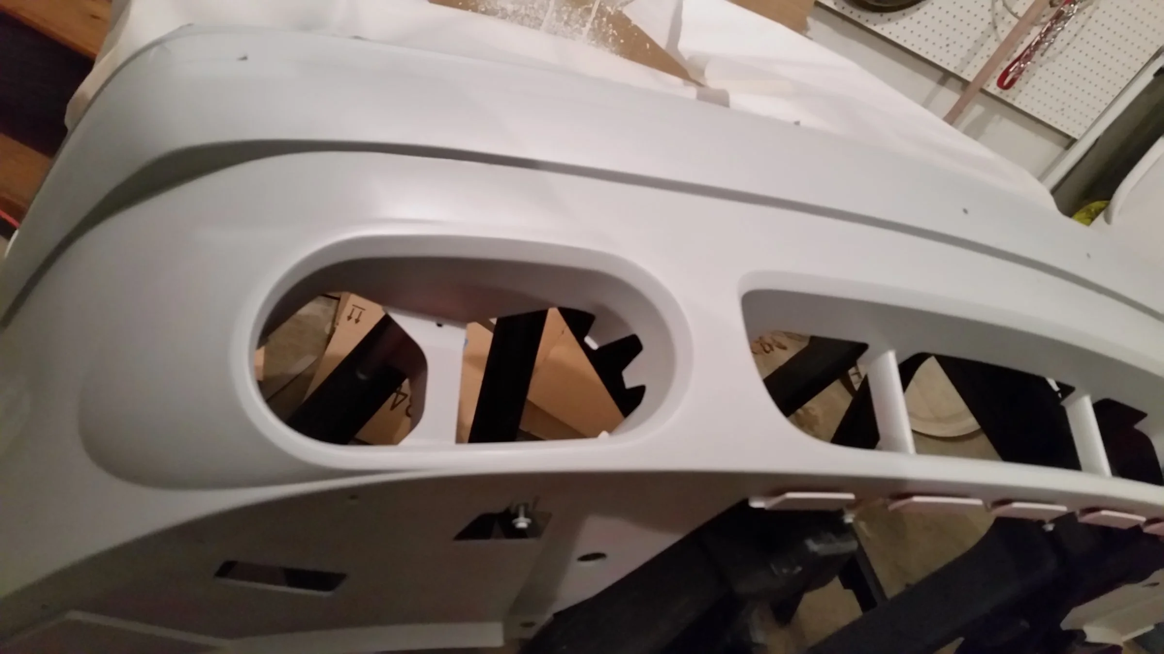

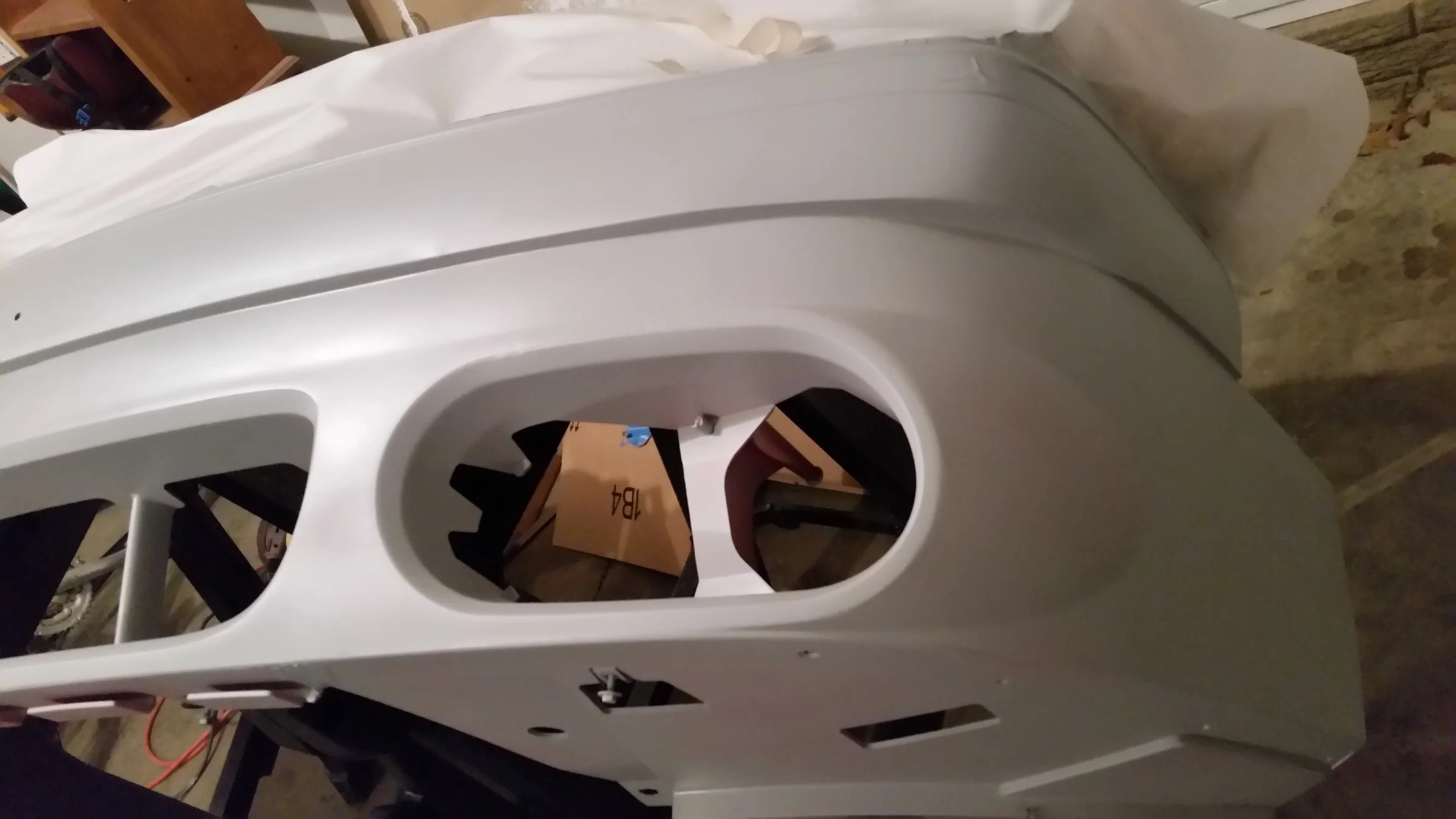

Well, the lower section of the bumper is in its first coat of primer. @Davedacarpainter , I used two coats of adhesion promoter first. I found a few imperfections in my sanding of the PBA, so I need to fill and sand a little more. Then another coat, then sand, then another coat, then sand. Body work, I tell ya. Anyway. Few pics of the progress, and it shows how not exact the bumpers fit together. Notice the outside corners. The gap is filled with very thick PBA with screws through it from the back side. When its fitted on the car, you dont notice the different shapes much.
Notice I kept my trim standing tall over the face of the Cobra lower. That was important to me to prevent it from being one big flat face.

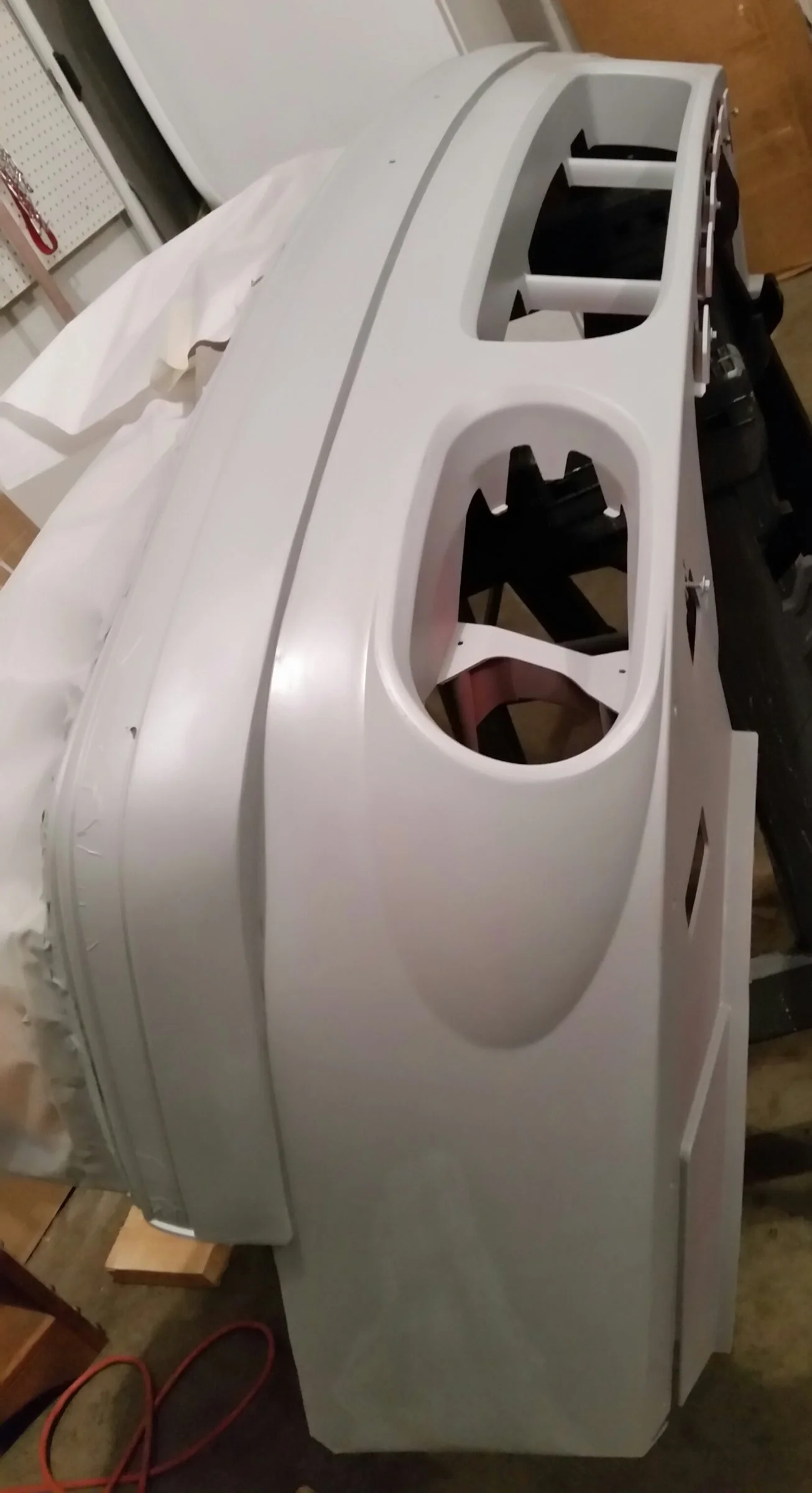

Couple more of the corners.

I think it looks hot as sht Nick, very good job.
What do you want for those corners? Mixing different generations will cause that. If you wanted to go nuts you could have split the corner of the new bumper about three times on each side and stretched it out to the fox contours and filled in the gaps with a couple tubes of PBA with some fiberglass mesh.
You made it the same on both sides, symmetry is vital in making something you think stands out look like it was planned. People will even comment on how much they like that feature, I bet.
Truthfully, the bumper "overhang" looks right for a fox. It's going to look great when it's all finished up.

Thanks Dave. I considered doing a couple different things with the corners, but I feel that the protruding fog lights actually complete the look, and leaving it as is looks A-OK. The fog surrounds stick out just about perfectly flush with the front face of the fox trim. All in all, I am really excited with how it is coming along.
I think it'll look like it was supposed to be that way too,....especially when it's painted (painting will "tone down" obvious details)
I also would like to give you the official 3 pats on the head for your decision to keep the parting line defined between the fox and Cobra bumper. I agree that w/o it it would be one big assed smooth face.

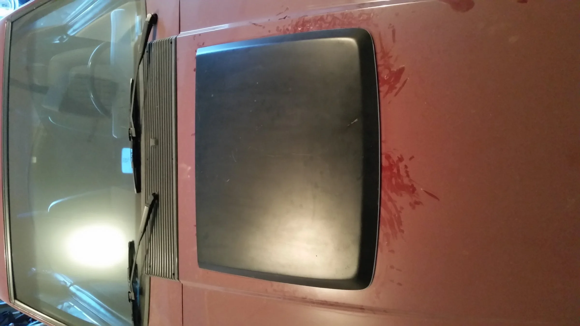

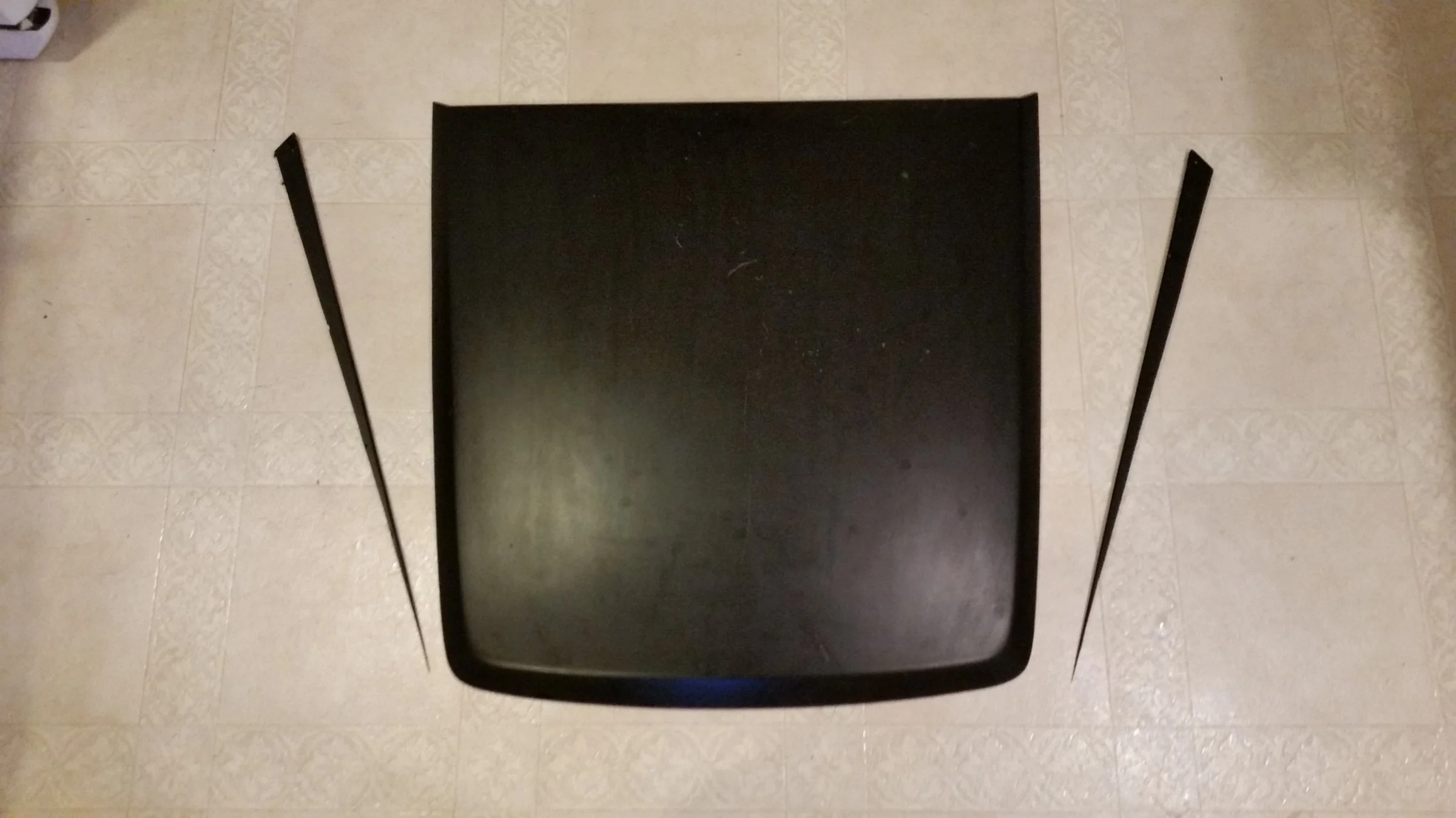

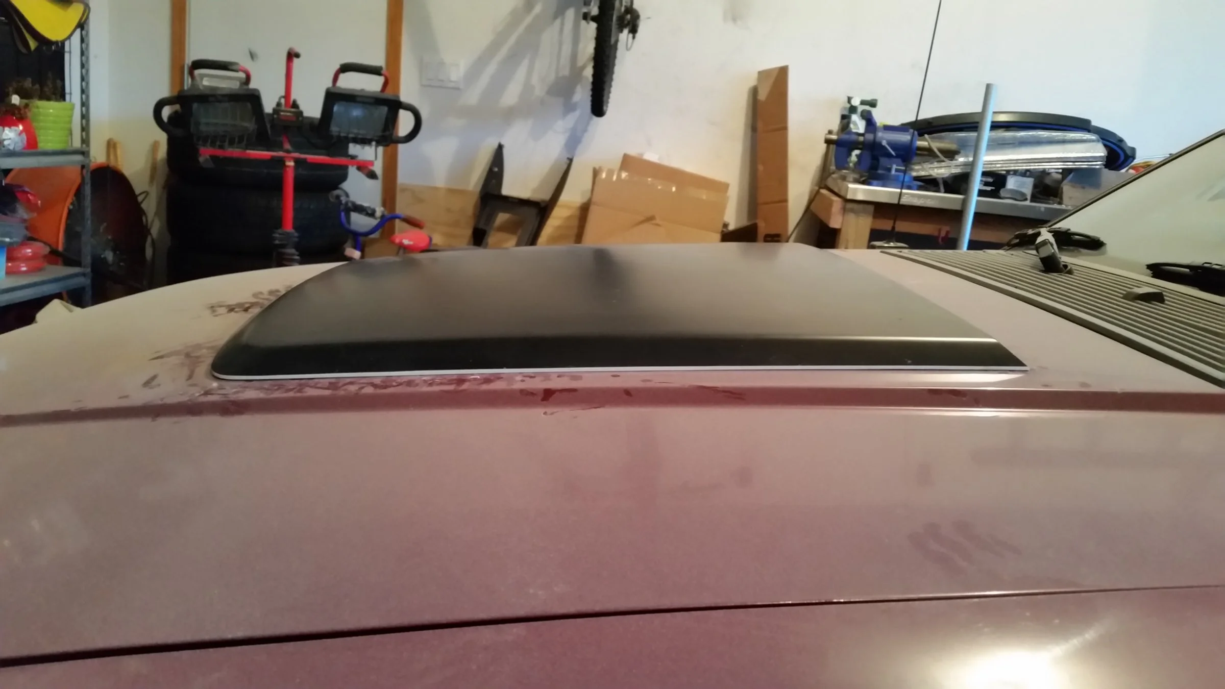

And now Dave has my attention turned to my '83 hood bulge scoop thing. Not happy with how it sits on the hood in stock form, so its going under the knife tonight.

Tonight's shenanigans.
After shaving it to my desired shape, I sanded the edges to give it back its factory edge (light colored bare fiberglass).
Maybe Noobz can rotate this pic so you can actually see how it somewhat follows the hood lines now.

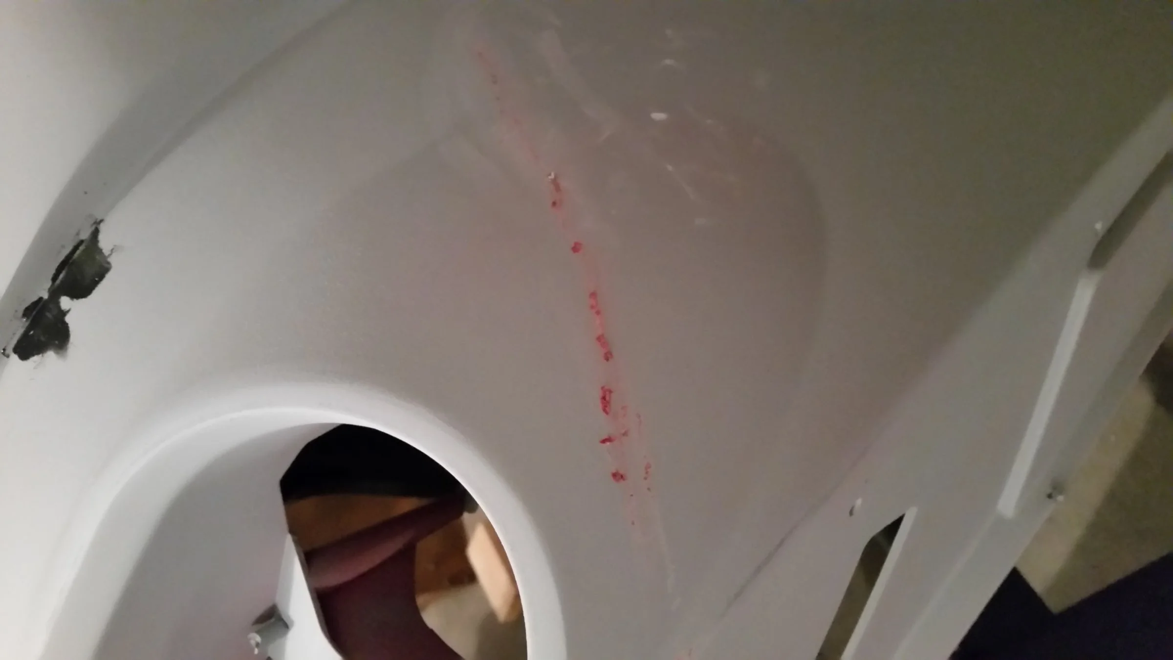

While using my @madmike1157 work bench, I managed to vibrate it into my freshly primered bumper. So, I went a little backwards on that front. No biggie, just more PBA smearing just like I had already done in a few spots tonight.
PS, really starting to get annoyed with my pics uploading sideways.

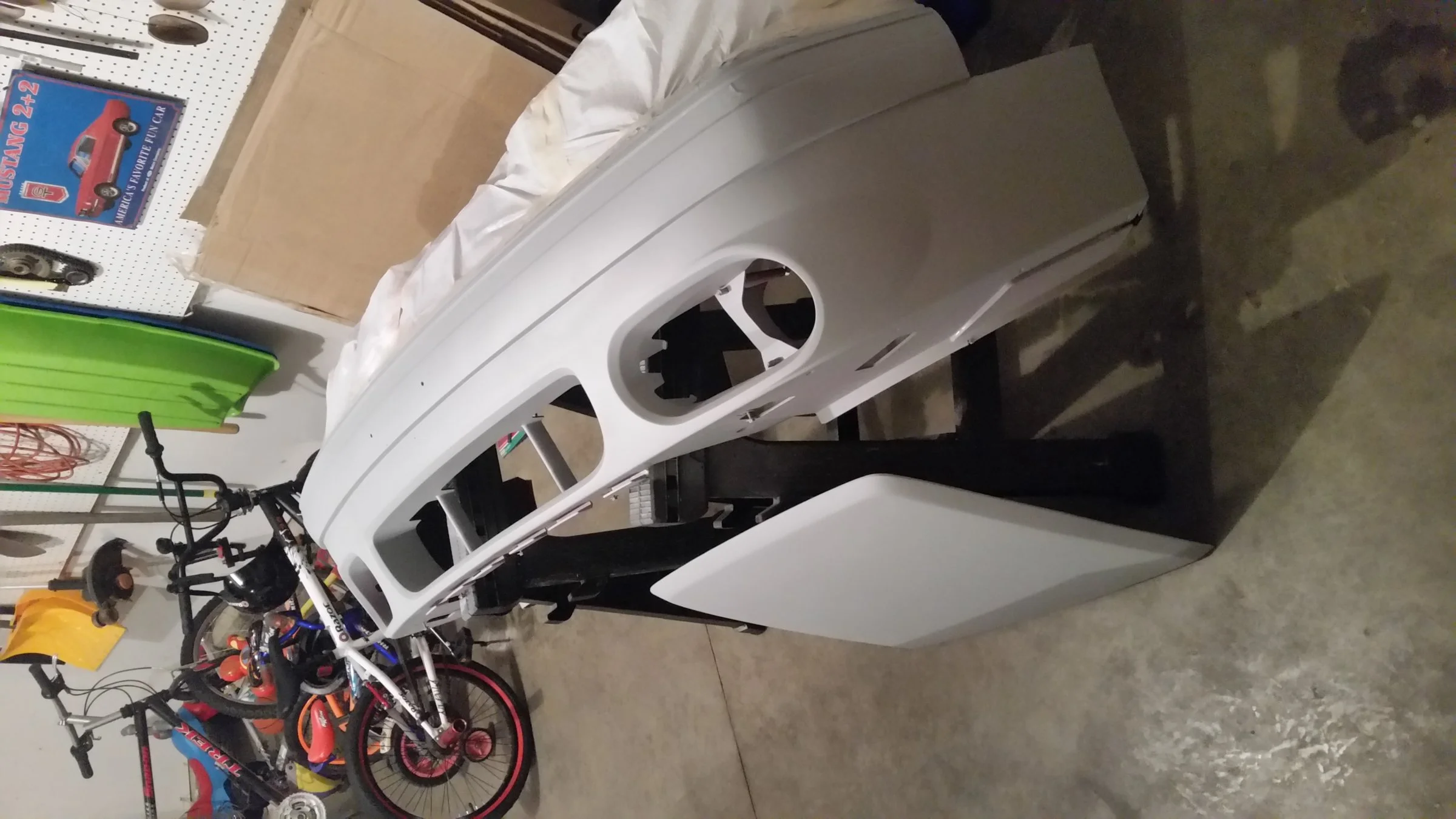

At least you are still in the fill prime fill prime faze. That corner looks like it was designed that way. Can't wait to see it painted and on the car.

Balancing baby life with two active little boys and a healing wife is a tough chore for one guy! But alas, I made a little progress tonight. I sanded and put another coat of primer on the bumper, as well as the first coat on my '83 hood scoop. Hopefully tomorrow I can get time to give them a good sanding and another coat of primer.
Here is your now regular sideways uploading pic for this evening.
