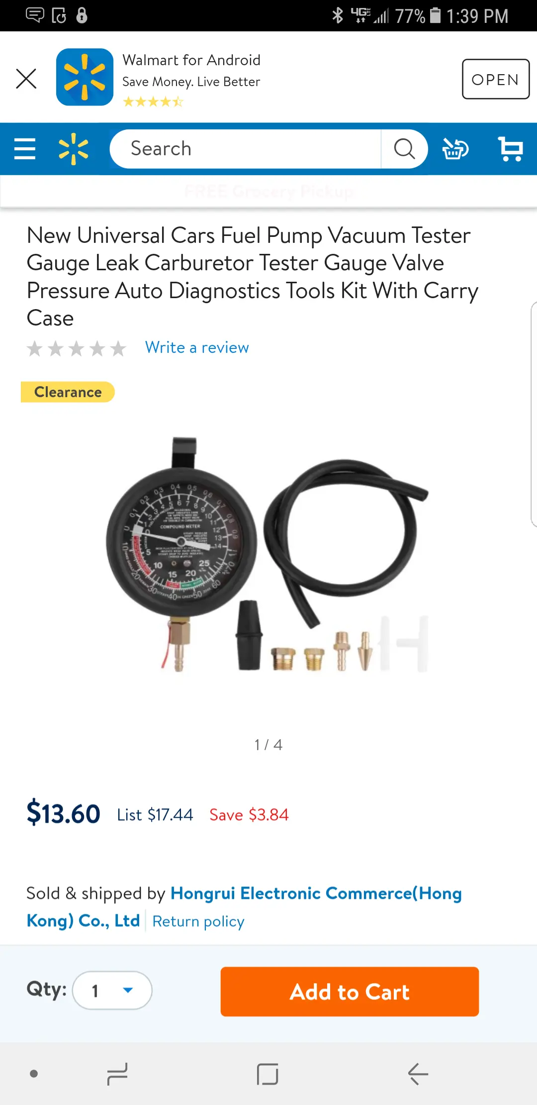

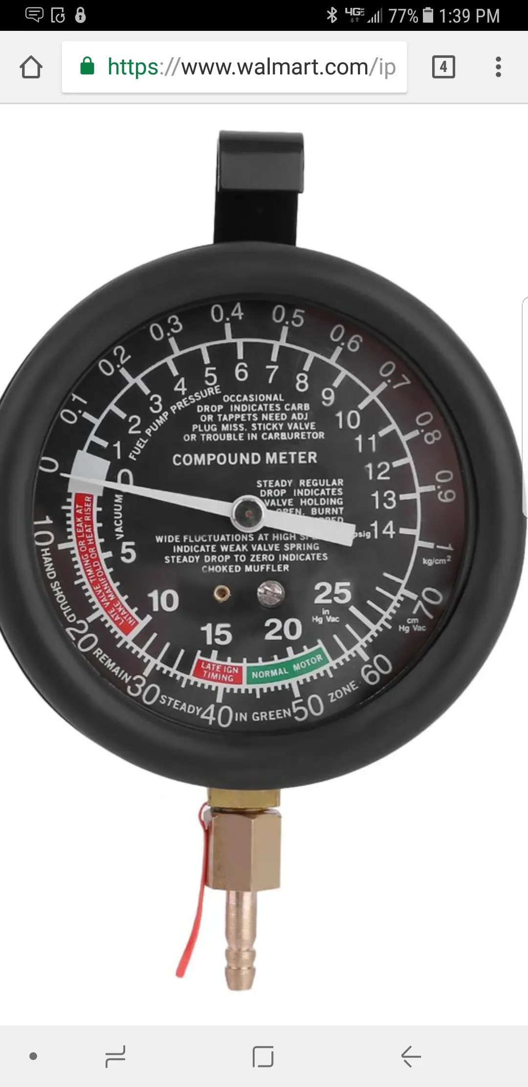

A vacuum gauge is one of the most important tools in the tool box. It'll tell you if your timing is correct, if there's an exhaust restriction, if the valves are working correctly, and so much more.
This is the one over used for years.... everything is on the gauge...
Walmart. com has it cheap...

Thanks man. O2 sensors are new motorcraft units, and the harnesses looked good. I do have a Pro M MAF, but stock air box and intake tubing. I'll grab one of those vac gauges and read up on some testing procedures. Im on the lookout for a used Accufab TB to get my PCV hooked up like stock as well. I have an old converted Explorer unit at the moment, without the integrated vac elbow.

Definitely get a vacuum guage, even a cheap harbor freight one or rent one from AutoZone. I fought idle issues when I first got my current combo together. It ended up being a large vacuum leak at the pcv valve. Another thing, I believe pro-m sells mafs calibrated specifically for cold air intake and stock air boxes, might be worth making sure you have the right one.

Thanks Joe. I definitely need to pick up one of those gauges, just been busy this week. My pcv valve easily pops out the back of the block, so that may be a contribution to the problem. I should buy a new block grommet for it. I appreciate the suggestions guys, just need to time to check them out!

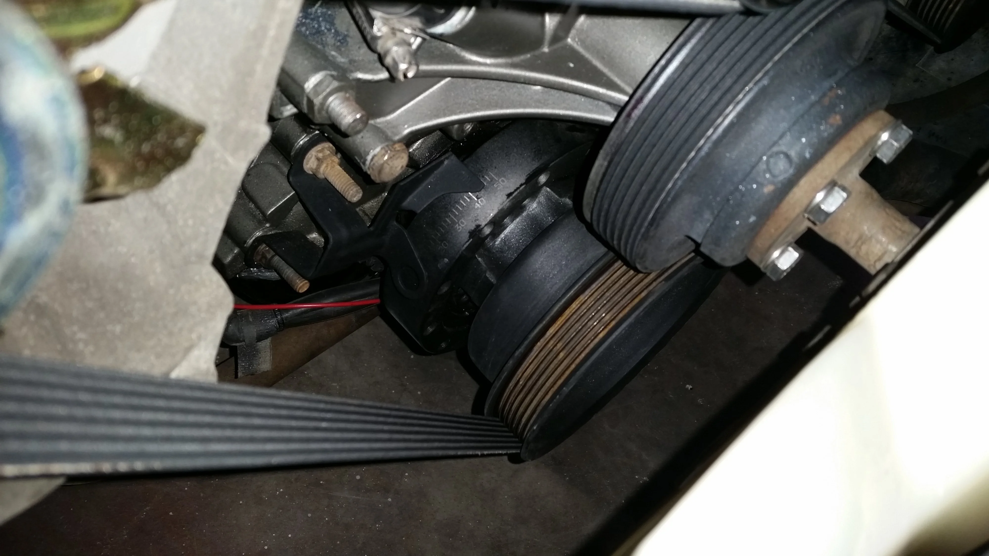

@CarMichael Angelo
Help a noob out here. Here is where my timing sits when the car runs... If I go one tooth in either direction, it doesnt want to stay running. Am I supposed to be setting the timing from the little circle on the pointer, or the tip just past 40 degrees in this pic? This is spout out, engine warmed up.
