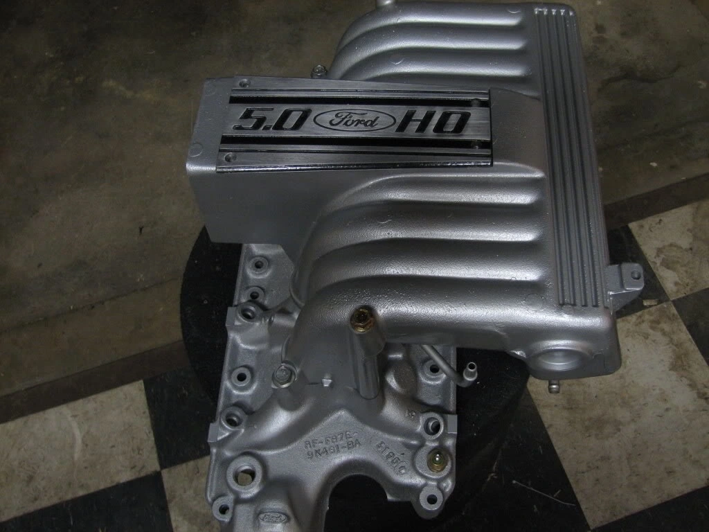

If you use an explorer intake, it still looks "stockish" and you can have it ported just the same. Not to mention you can buy the intake, have it ported, and still be cheaper than a GT-40.

I also vote explorer. Put the effort into finding and early one with the internal EGR. They come with 65mm TBs that can be converted for Mustang use and 19# injectors with a better, wider spray pattern. You can pick them up for $75-100 locally and have Tmoss port the lower.
A little elbow grease, a 70mm EGR spacer and convert the TB and you get a decent performance upgrade that can look bone stock with a stock intake plaque
I picked one up myself for $75 just for the lower to send out to port, but if I didn't already have a Ford 1993 cobra intake, I'd totally run the explorer upper

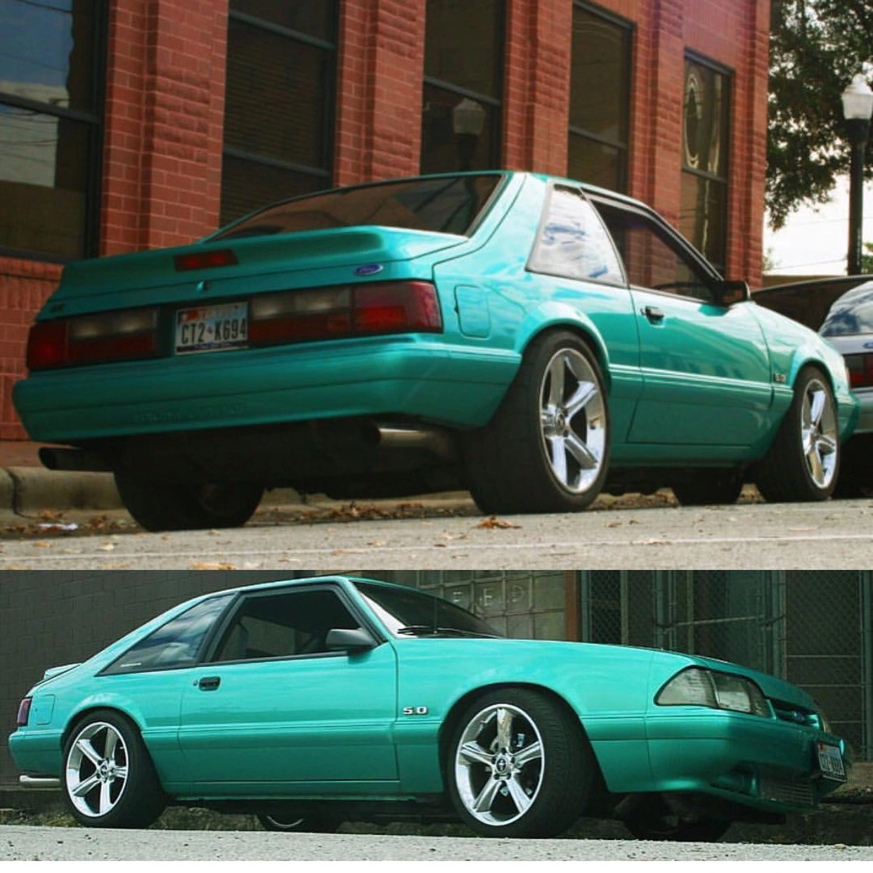

Is that your intake?
Hey man, those wheels look great! Where have I seen those before?
It will look way better once I get my stance in check.
And I really wanted silver actually, but couldnt find them. Chrome was on sale for super cheap, and looks good with my color combo. If I keep them long term, I may have them painted silver to match the lower portion of the body. You can see the detail of the spokes a lot better in silver than with the chrome.
I'm partial to the chrome.
