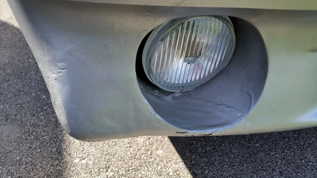

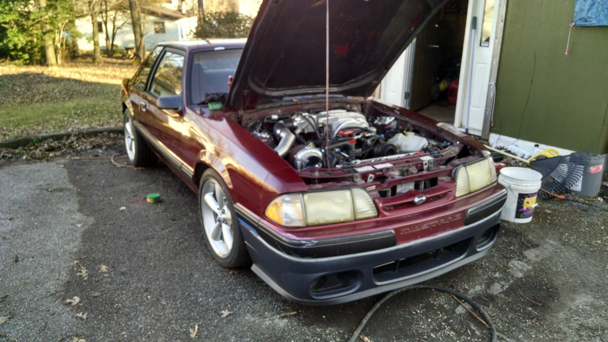

I have been doing a lot of thinking about dumb visual stuff lately. It all spawns from the fact the right front corner of my front bumper is a hack job by guy that owned this car before me. Never really exposed that to you guys, but here it is.

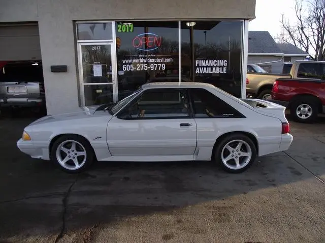

A trimmed GT rear bumper to mimic a Saleen. (Dont even talk about the front LX bumper / GT fender extension. Lets pretend that isnt even there, put your hand over the front end and look at the rest)
That ^ I think I can easily mimic, along with a set of Cobra tails, and pull it off. It looks very similar to a Saleen rear from the side, and is just smooth across the back like an LX bumper... The best part about all of this? I would start with the Cobra front bumper hack job, and if it doesnt turn out, I need a new front bumper anyway. If I do like how it turns out, then I would buy some Cobra extensions, and go town on the rear bumper.

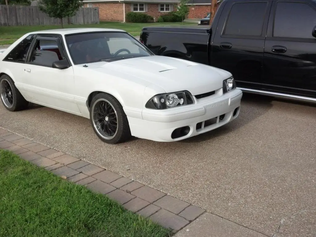

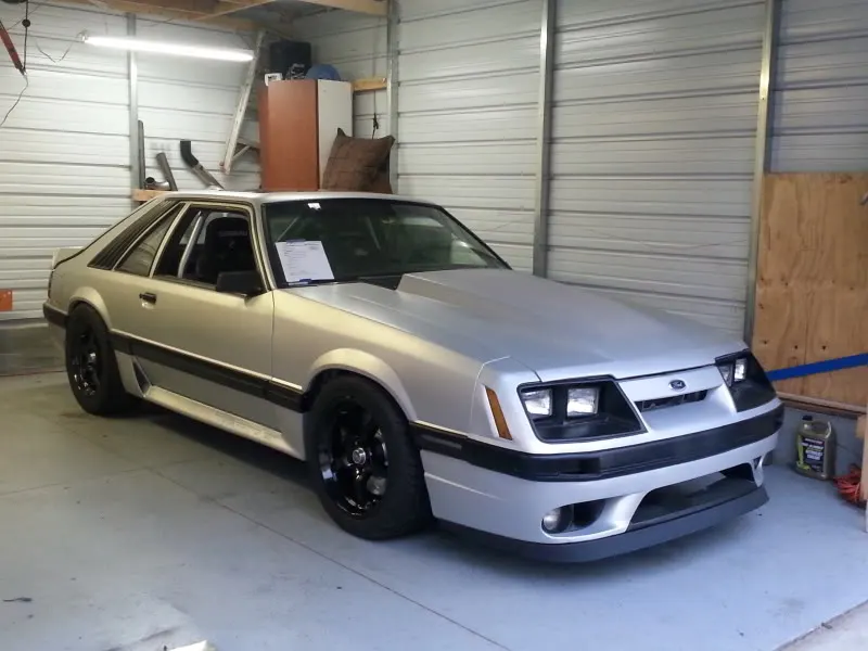

WAIT, I found a guy who did it, kinda. Save for the ricer headlights, wonky new edge grill delete area, the fact he made it flush with the front trim of the bumper, (I would attach under and set back an inch, more like the stock bumper), and there is no body kit on the rest of the car, I like it.

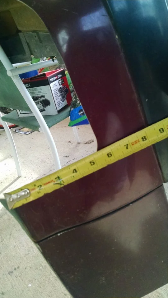

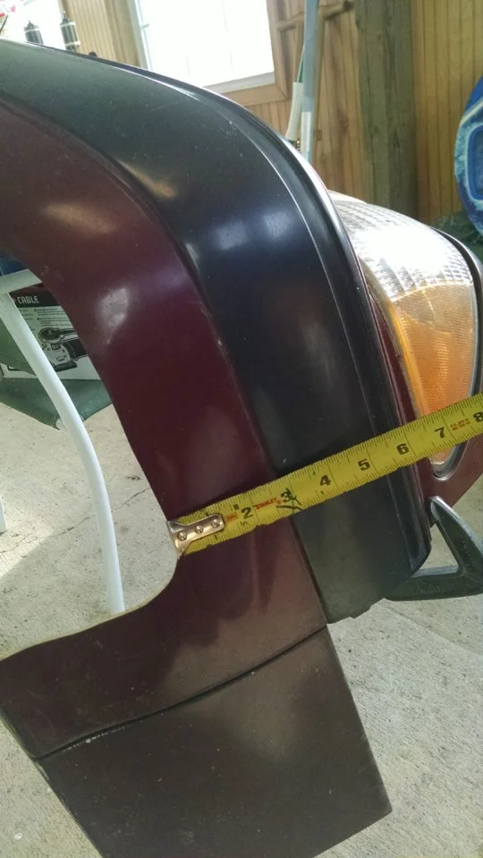

I'm still in the process of blending my 04 front bumper. The cold weather caught me. When it warms up it'll get finished. Its in my build thread....even the measurements for the cuts to the cobra bumper.

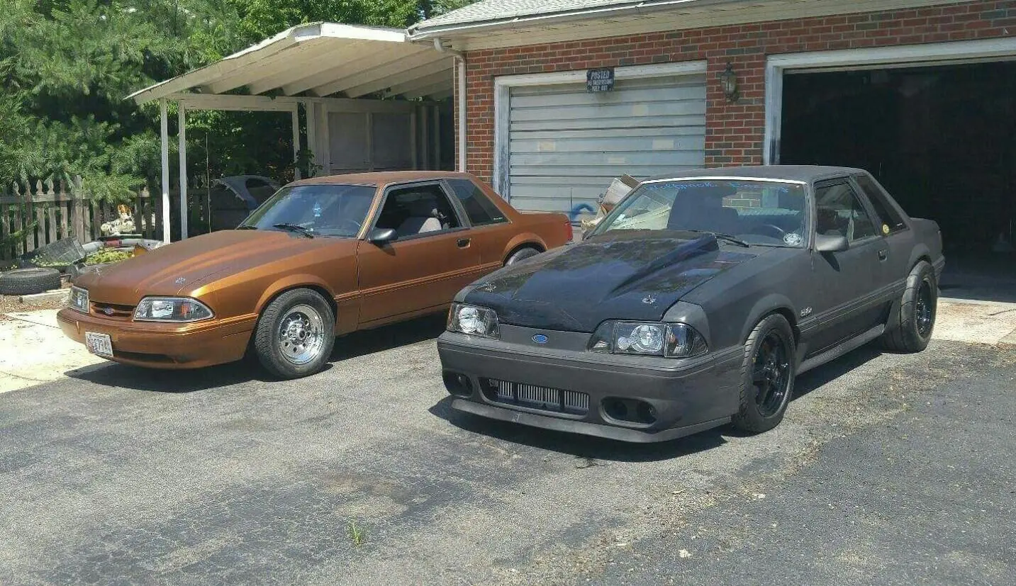

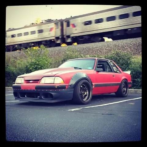

This is another car a friend of mine snuck a pic of.

So,....keeping in line w/ that,..I'll just say that I like the Cobra lower on a Fox. It gives it kinda the 4 toed Chucky Fuller look that I thought the red car had. In other words,...It makes it look like a little bad ass.

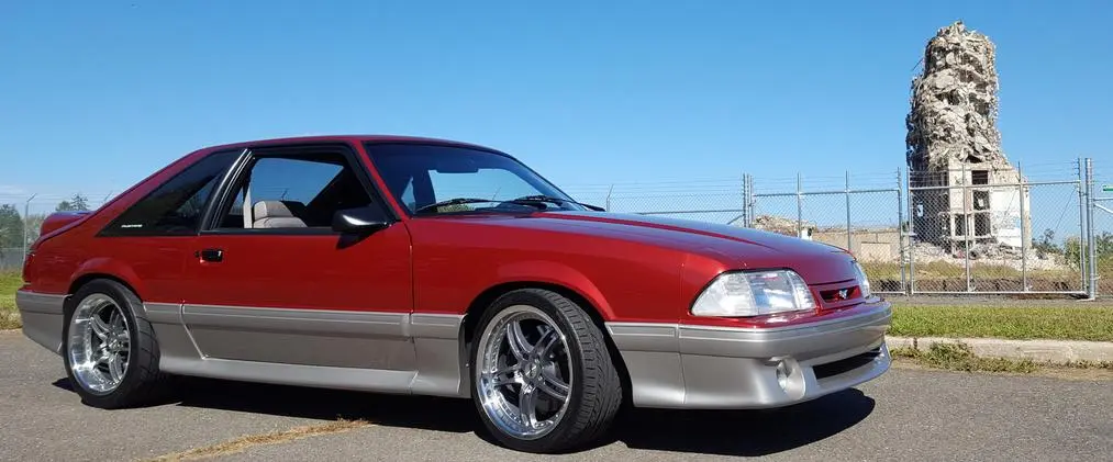

The car needs the rest of the GT lower side skirts to carry the lower front. The top example looks way better than the bottom.

Only thing I wish I would've done different is drilled 3 small holes about an inch up from the corner of the bumper and cut slits to them to relieve the stress of the molded bumper corner bulge. I think it would've helped with epoxying the bumper on. It would've allowed the curved edge to straighten out behind the cobra bumper- giving more contact area to adhere to.
