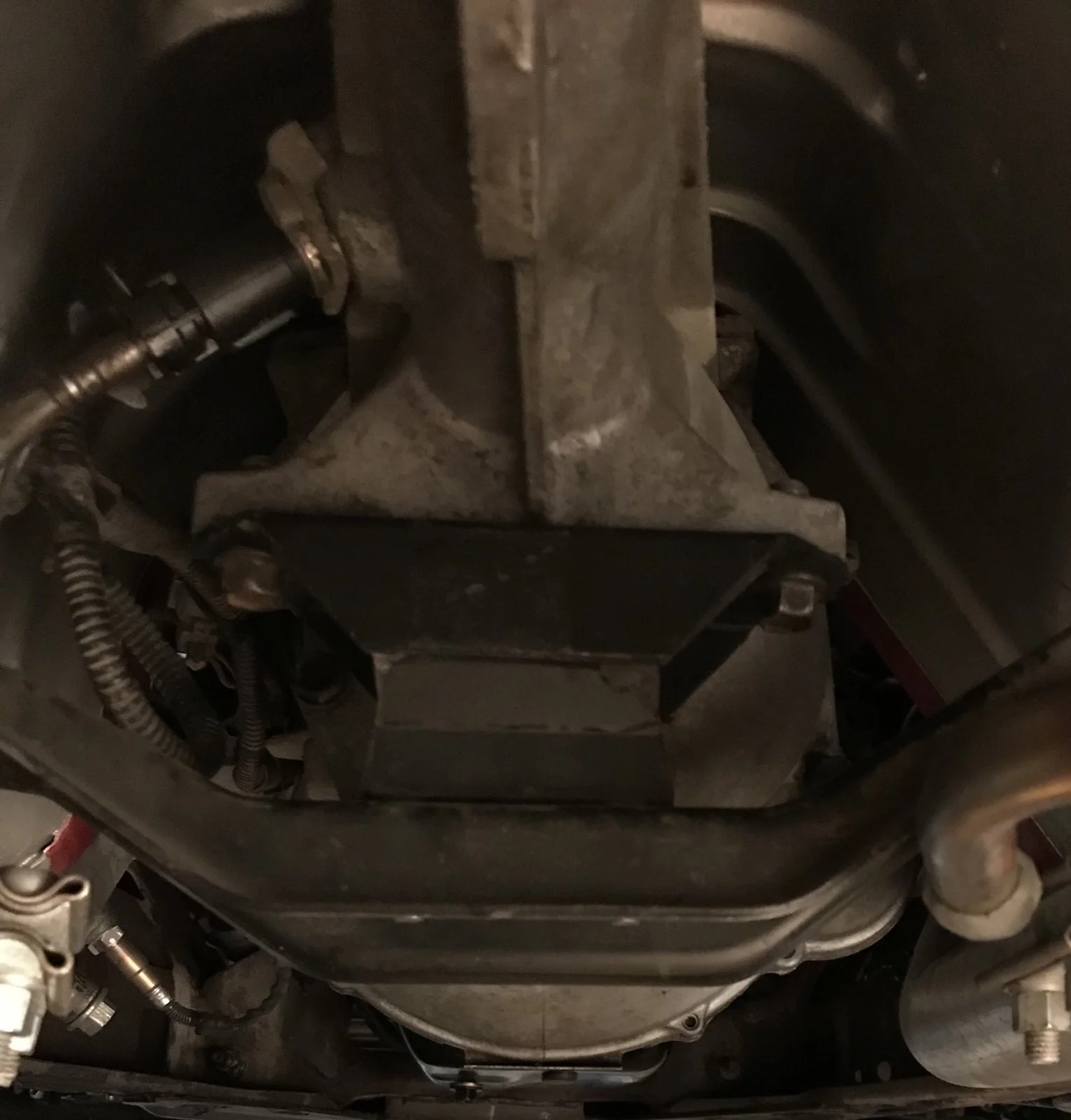

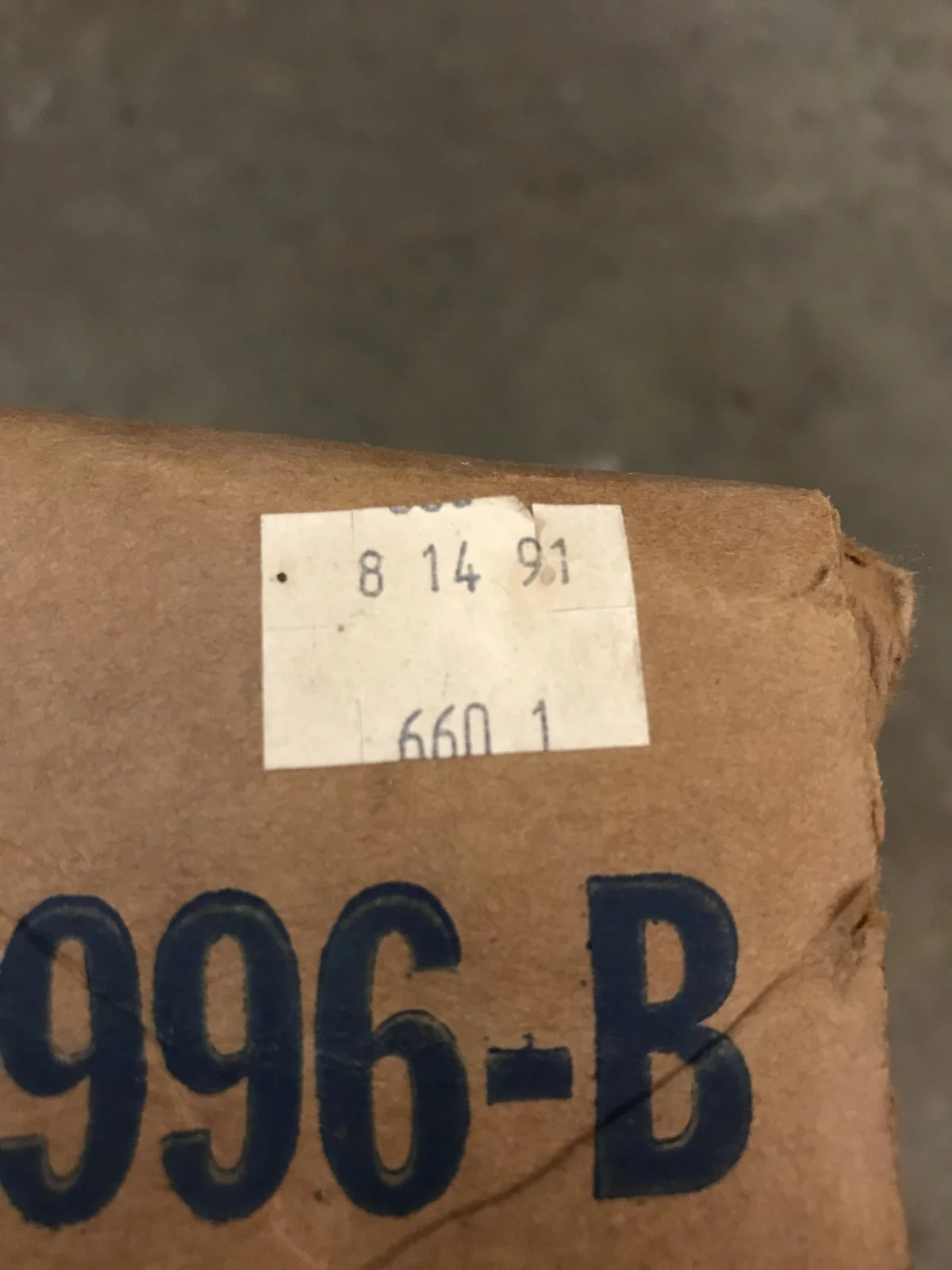

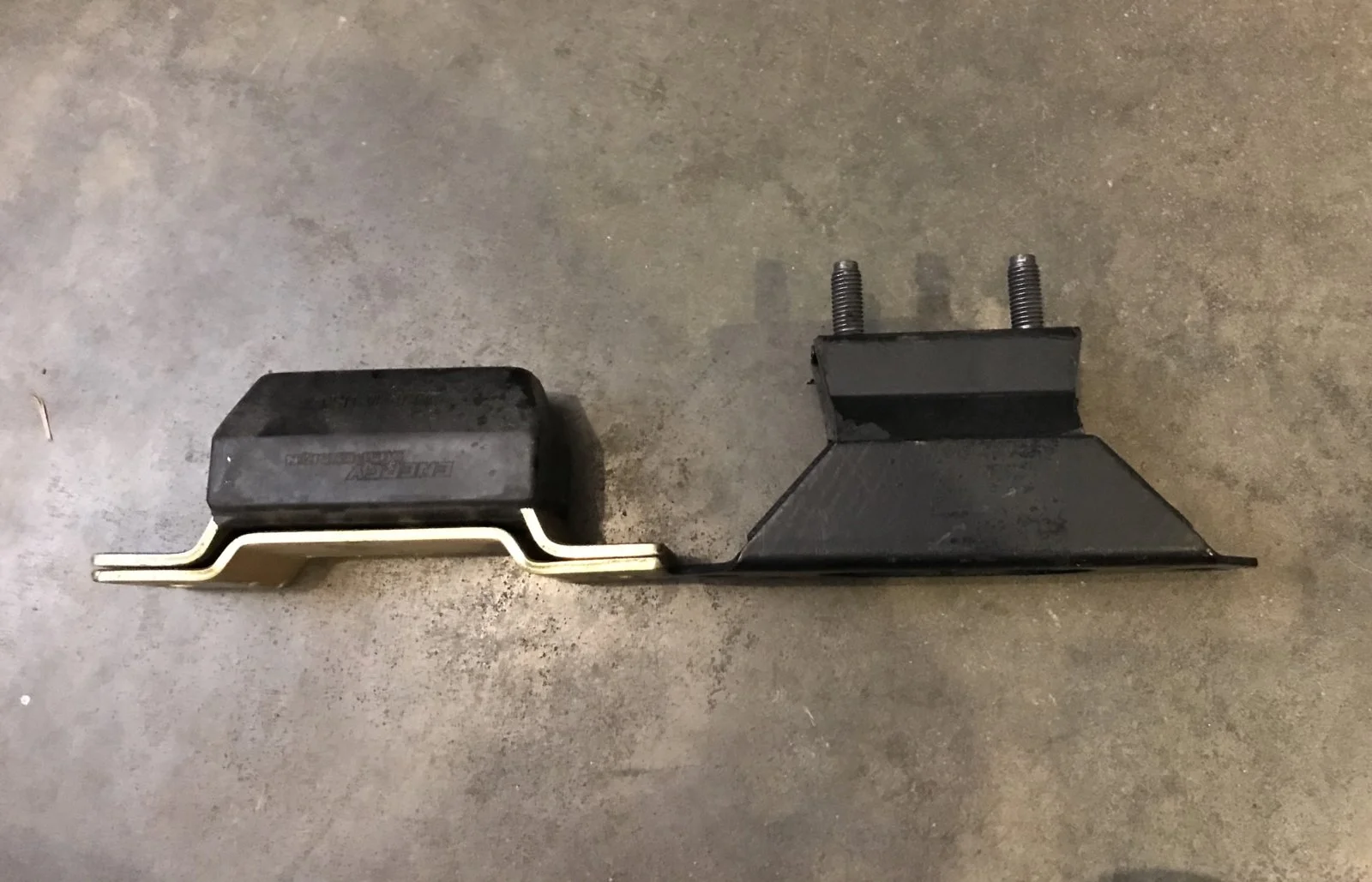

Rubber transmission mount is in. I had to ditch the exhaust hanger to fit it without loosening the engine mounts or dropping the exhaust and trans cross member though. Oh well, this is the first car I’ve attempted to keep that hanger and the rest were fine without it. I’m going to call it weight savings.

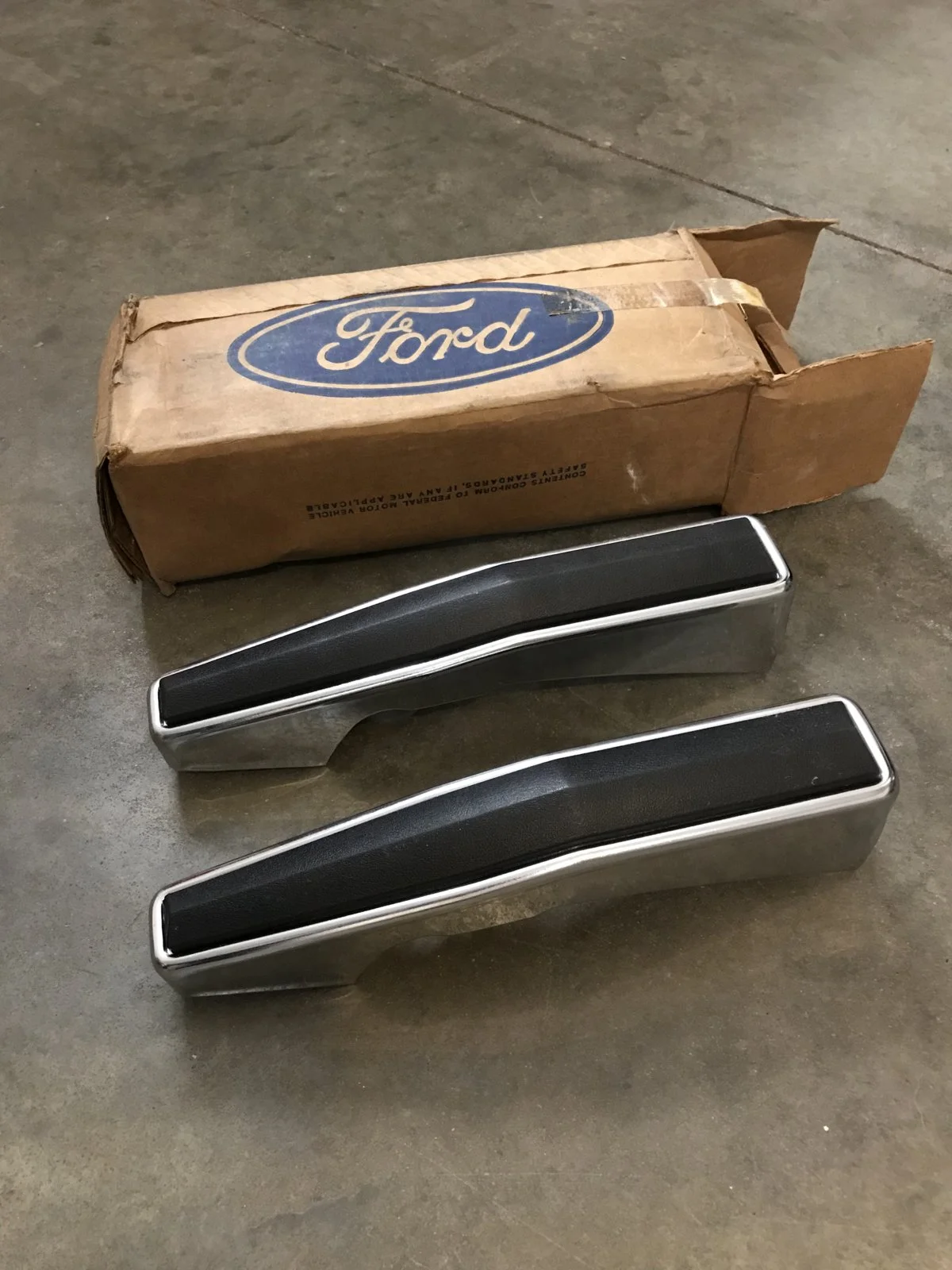

Another fun topic. I love NOS parts. Especially when they come in the original box. I found NOS bumper guards for my F250. The front end is pretty flat and plain, so these will give it a touch of character. The box has a dated sticker on it. I was 8 years old on that date.

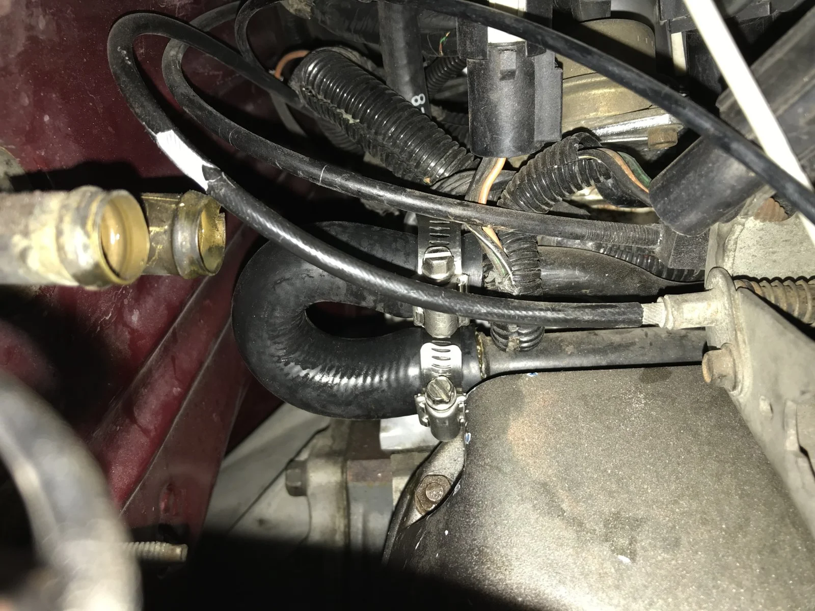

Lastly, today I had to do the inevitable heater core bypass. When I went to install the passenger SFC, I noticed antifreeze dripping. Luckily the carpet is dry, it was just dripping from the evaporator box drain. Not pulling the dash out right now, so for the time being it’s:
That little U hose is from an LS application, and has the correct 3/4 size on one end, 5/8 on the other. Got it from Mike’s BFFs at Summit for cheap. It’ll do for now.

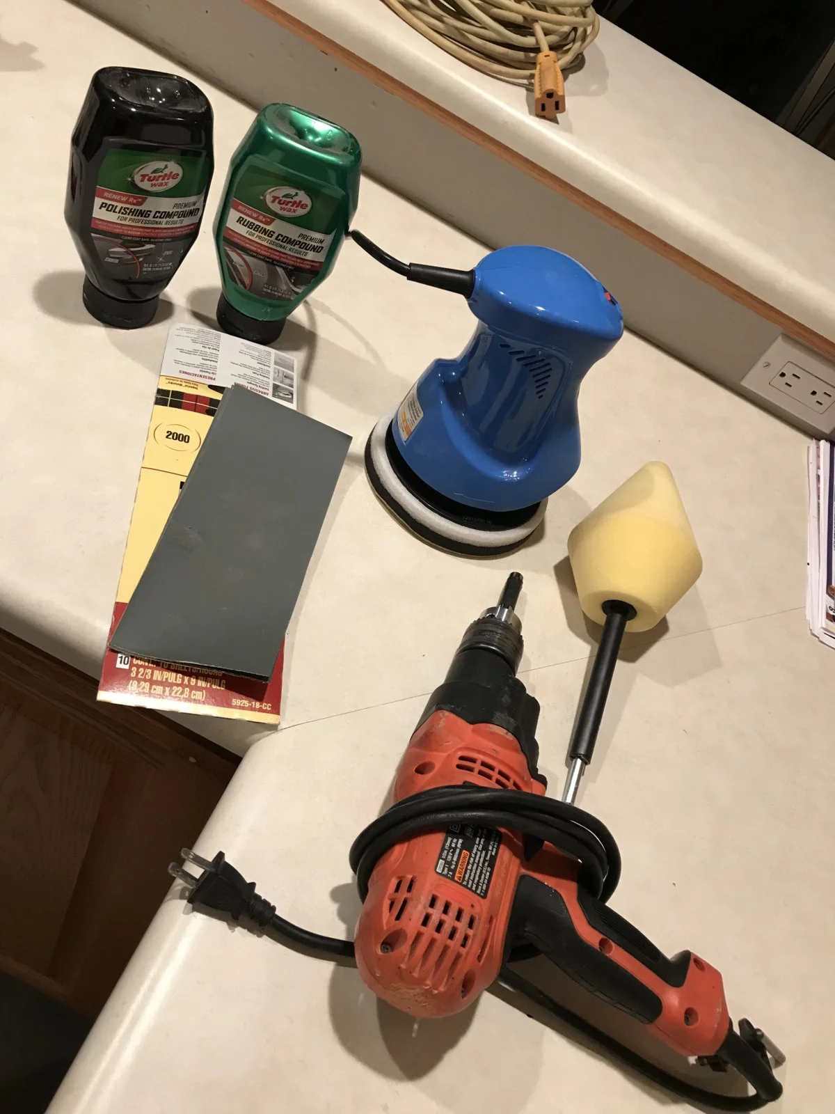

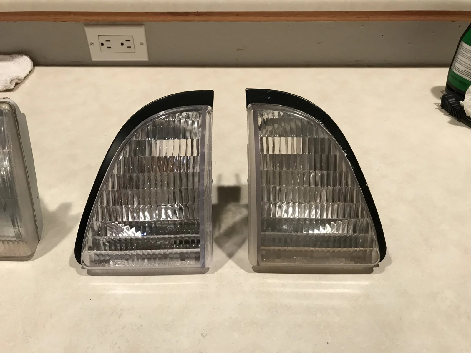

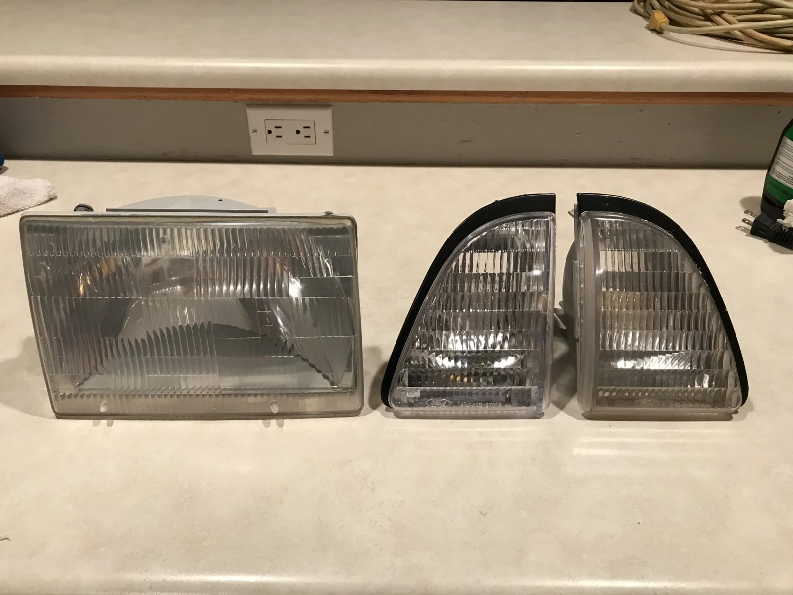

Well, try as I may with my wax on, wax off, I can’t get my old headlights/parking lights looking new. I sanded, rubbed and polished the headlight and parking light in the below pics. I can’t get the lenses separated from the housings, and there is a noticeable difference from the couple NOS lights I’ve obtained.
I tried sticking the parking light in the oven and warming it, and it won’t come apart. So again, for now (or maybe forever), I have repro’s coming from LMR. Lots of customer pics look like they fit just fine. One day when money falls from the sky, I will send my OEM lights to Kevin to get the royal treatment. For now I have too many other higher priorities.

For christs sake.
He puts a buffer on the lens.
Whether it's a kit from Mothers using a drill motor, or a sho-nuff pad on a buffer. Put a machine spinning a pad at 1500 rpm against that lens, and add a mild abrasive between the pad and lense, and that bitch will look like new.
You cannot generate enough heat by hand rubbing the lens to soften the substrate enough to allow the compound to do the job, without spending countless hours of mindless rubbing. The machine does that. That is what the guy in tenessee is gonna do, and that is what will cost you a buttload to get done.

That’s exactly what I did to the outside. 2000 grit, then rubbing compound with the drill, then polishing compound with the buffer. The outsides are great. It’s the insides that have the remaining yellow.
Oh,...and what makes you think it's better to spend the money on sending them off and paying for a recon instead of just buying Chinee replacements?
