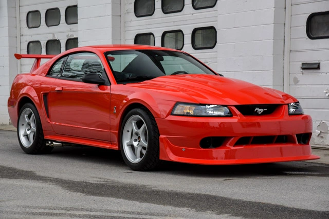

‘94-‘98 Cobra front (what I suggest grafted onto an LX)
‘99 and ‘01 Cobra front (scowl or frown look):
And finally the ‘03-‘04 Cobra front (what I used, and someone once suggested a squirrel with its cheeks full look):
And one cannot forget the ‘00 Cobra R, which is a ‘99, ‘01 with a molded on lip:

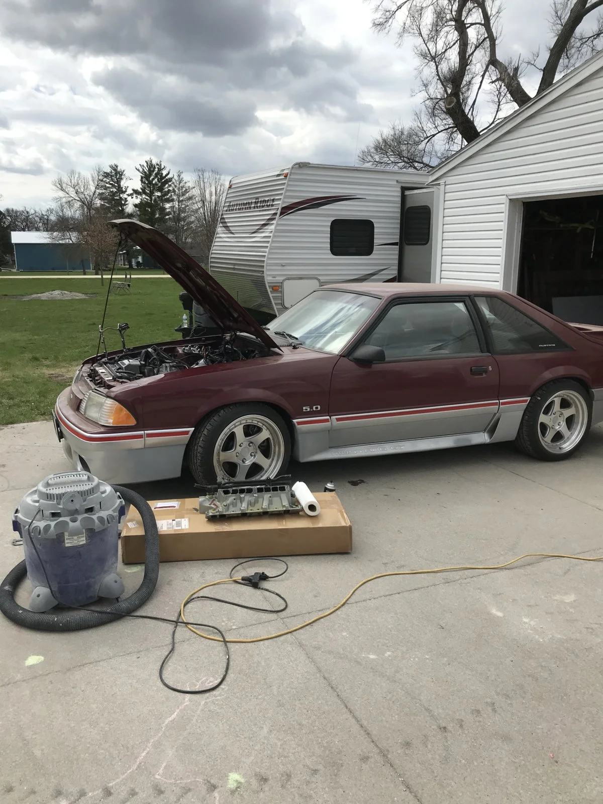

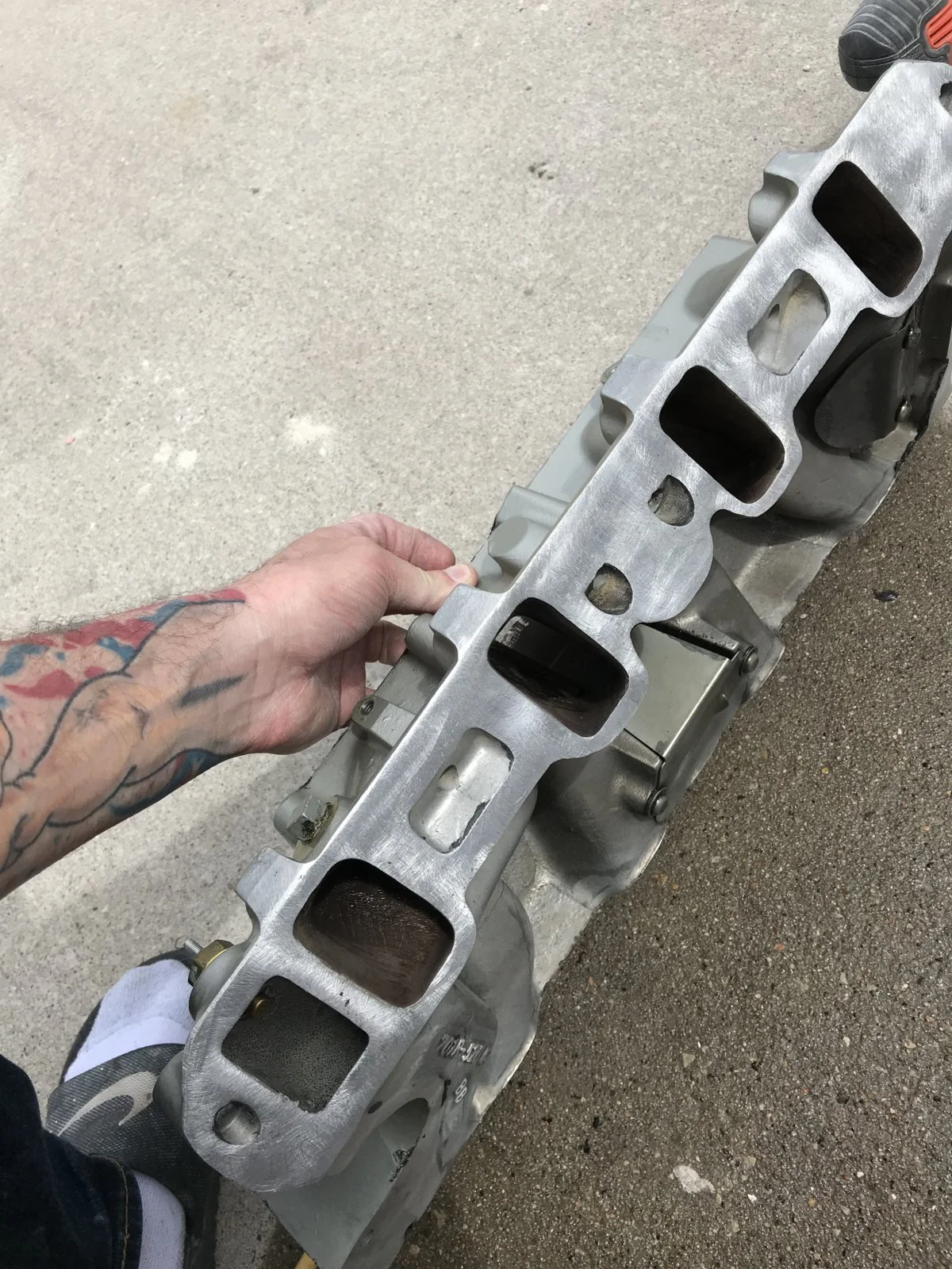

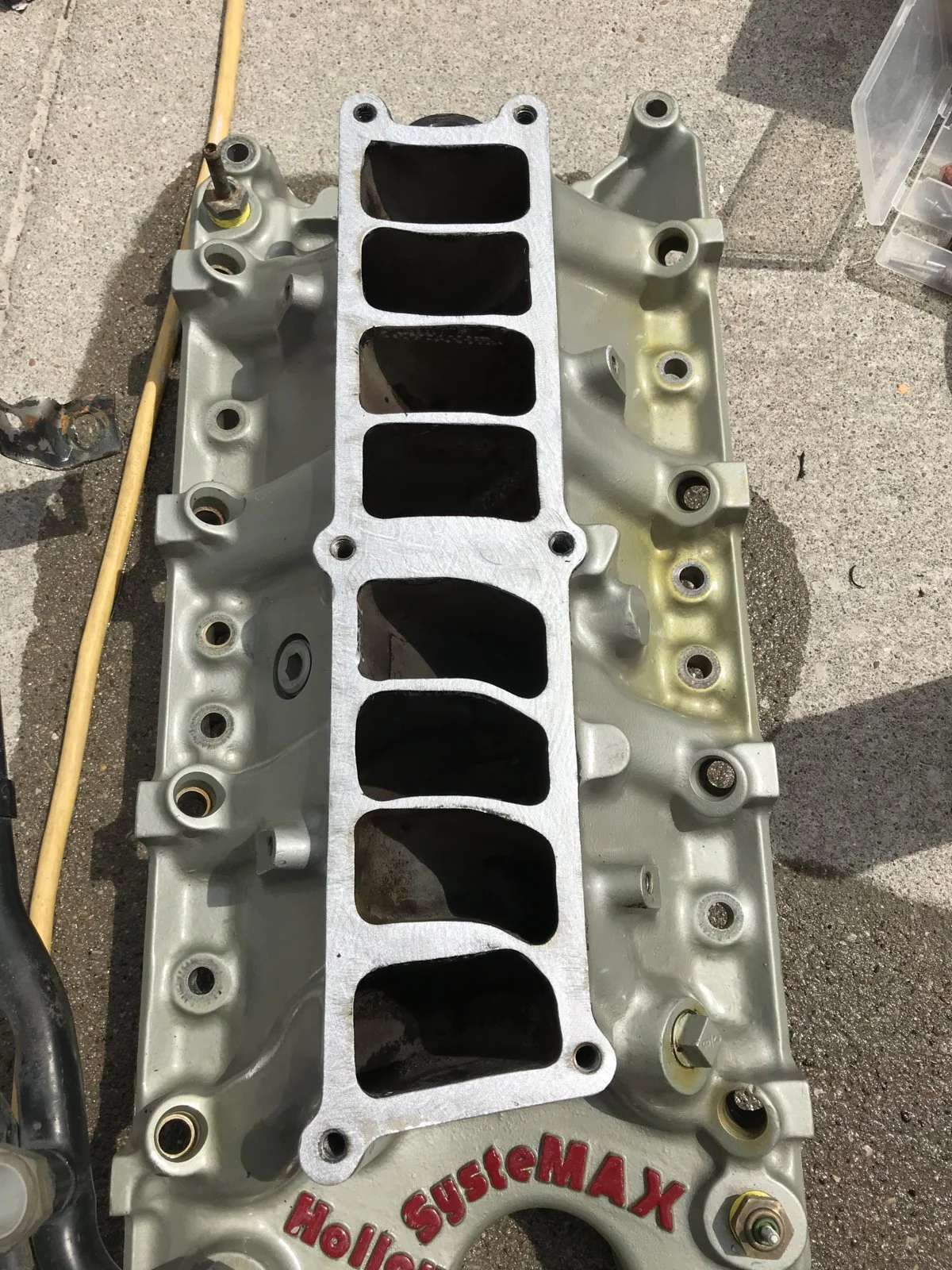

The ol’ girl was woke from the dead today. I pulled her out of the barn with the 4 wheeler and a strap, and commenced the Systemax install after selling my GT40 tubular a few months ago.
Upon cleaning up the Systemax I bought, it seems to have been ported. Not sure how well, or by whom, but hopefully it doesn’t actually hinder flow.
I used new ARP bolts, and gel pro gaskets to mount the lower. Threw new O rings on each end of each fuel injector and lubed them prior to install.

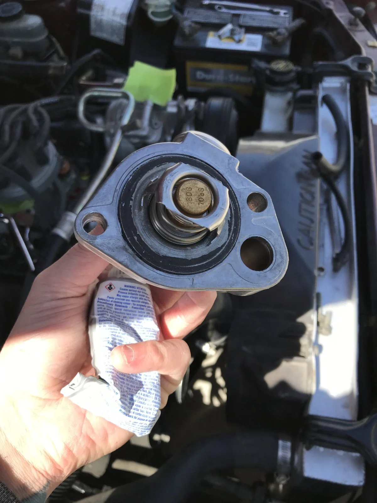

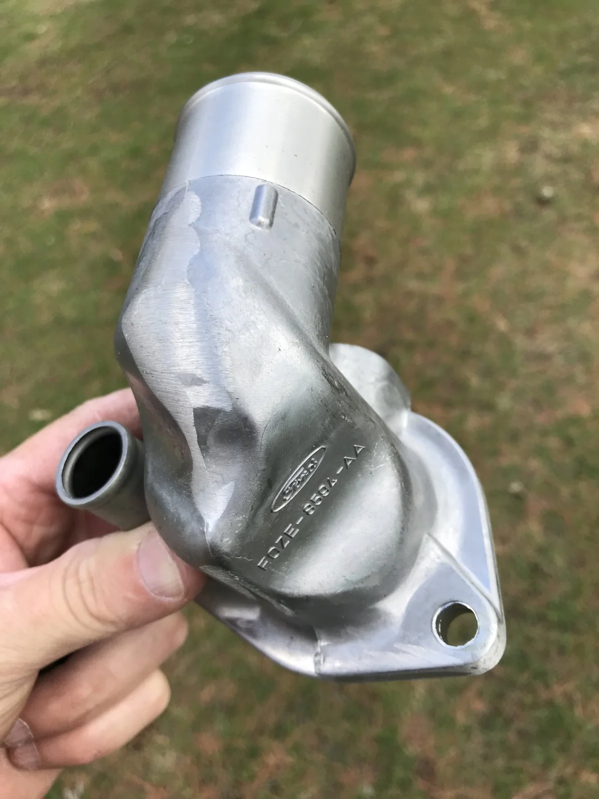

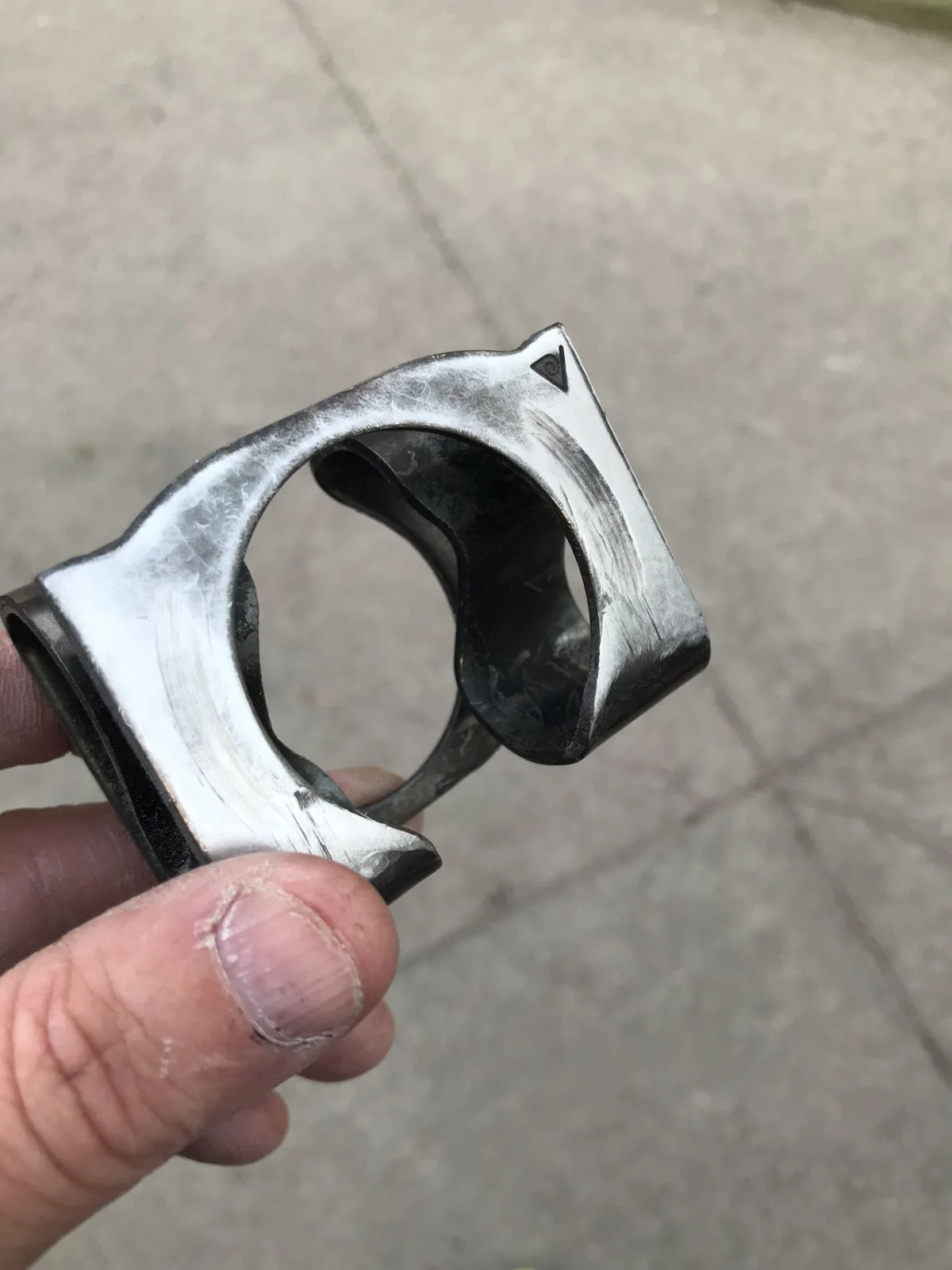

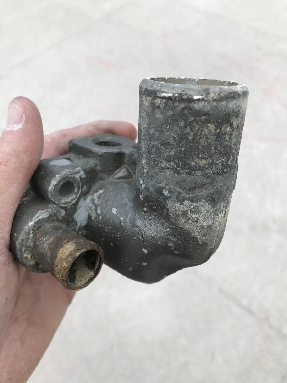

Next up was installing my new thermostat housing. I’ve had a coolant leak at the front of my engine, and I’m thinking it’s either the old hoses or the pitted t-stat housing.
But I couldn’t find my old thermostat anywhere, so I had to stop and order one. I shifted over to installing my new oil sending unit I ordered long ago because my oil gauge was intermittent. That took 5 minutes.

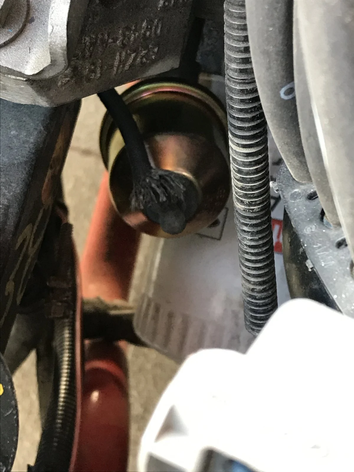

After that I was looking over things and realized my fuel pressure regular was original. Figured now was a good time to replace it while the upper intake is off. So in the mail is my new motorcraft FPR and thermostat. I don’t want or need an adjustable regulator. The stock one has lasted 31 years, so that’s good enough for me.

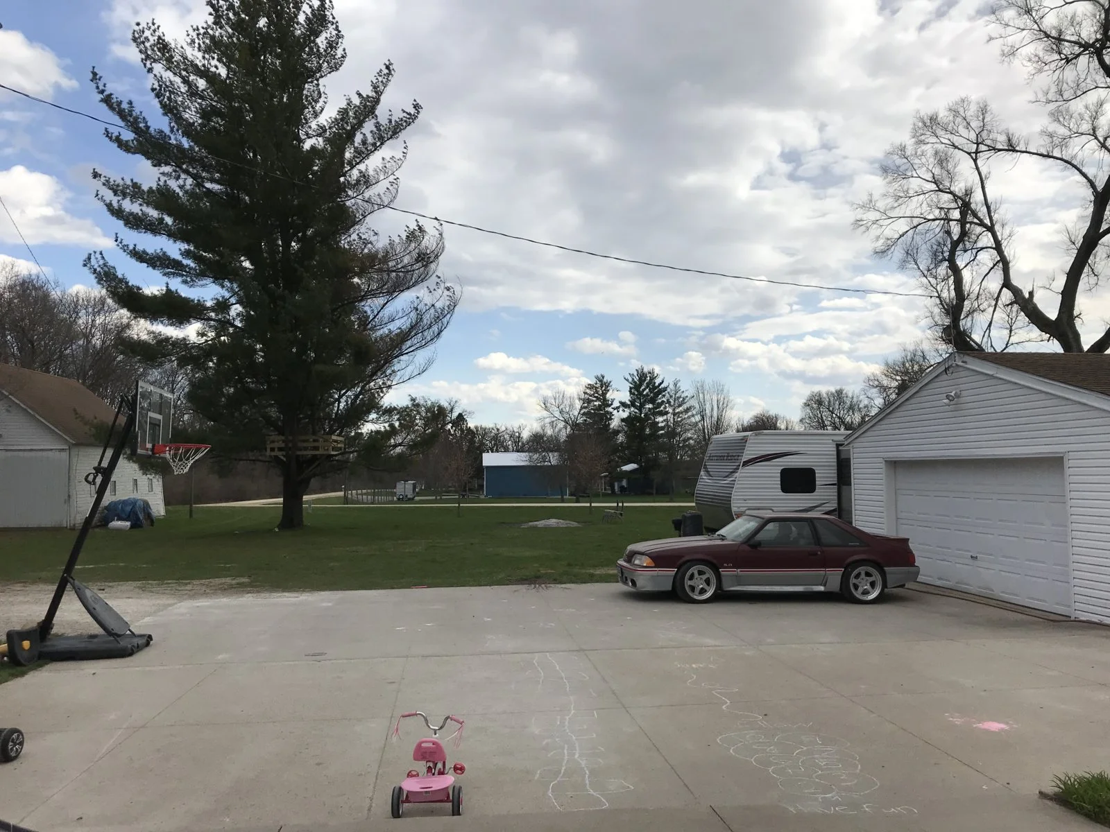

Lastly, I think my paved parking area looks to be just the right size for donuts after I replace my 8.8 clutches.
waiting for the video!!!

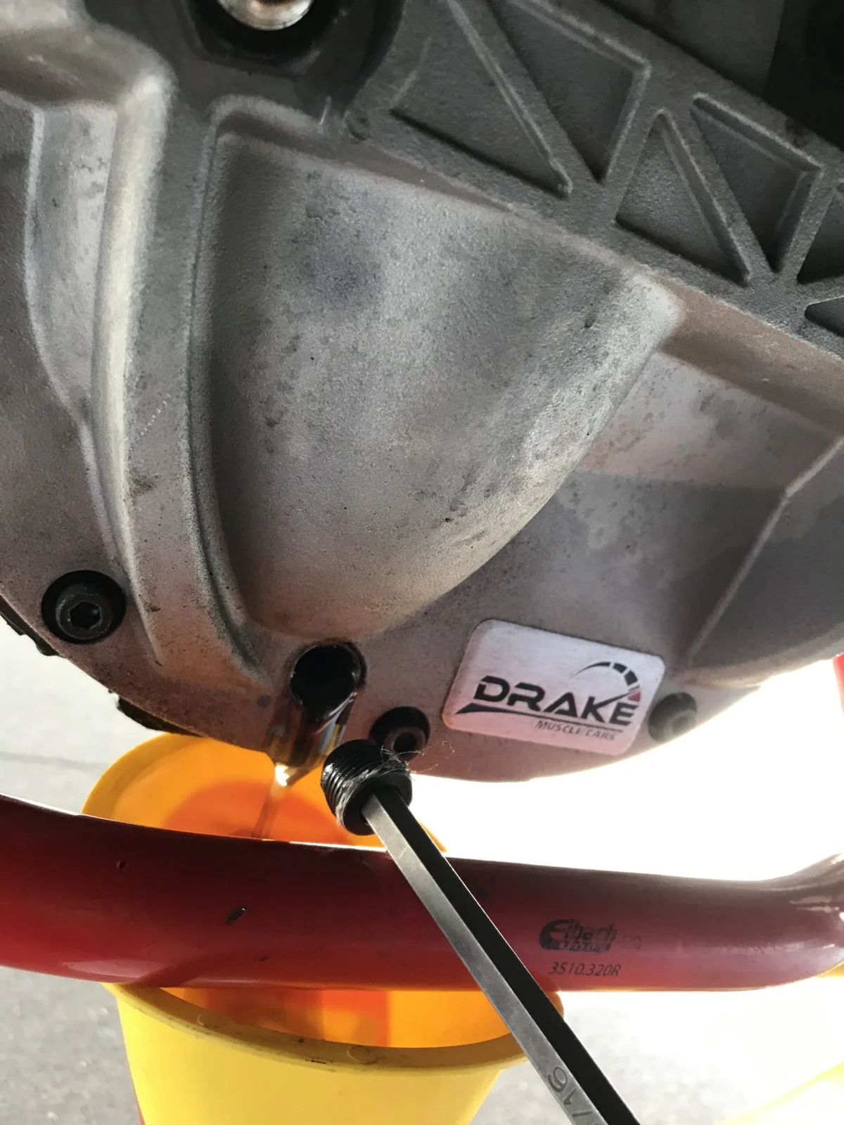

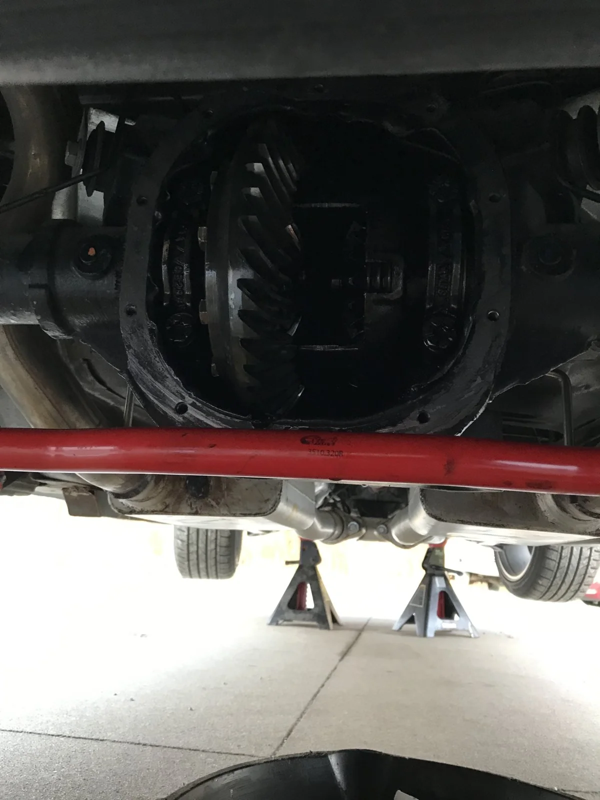

Whether it be working on my house or car, baby steps is the name of the game with my kids being home.
Found my thermostat after I stopped looking for it. Decided to throw it in.
Drained the rear end (the plug option is handy), with a little help from my #1 fan.

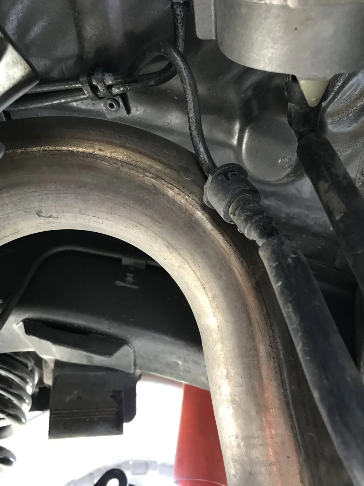

While under there I realized my exhaust is within a fraction of an inch of my fuel line.
This is because I pulled the pipes together a touch when doing my center exit tips. I already bought some LX tips to install because I’m not going to get around to finishing that rear diffuser/center exit exhaust idea. I just don’t have time and want to drive the car.

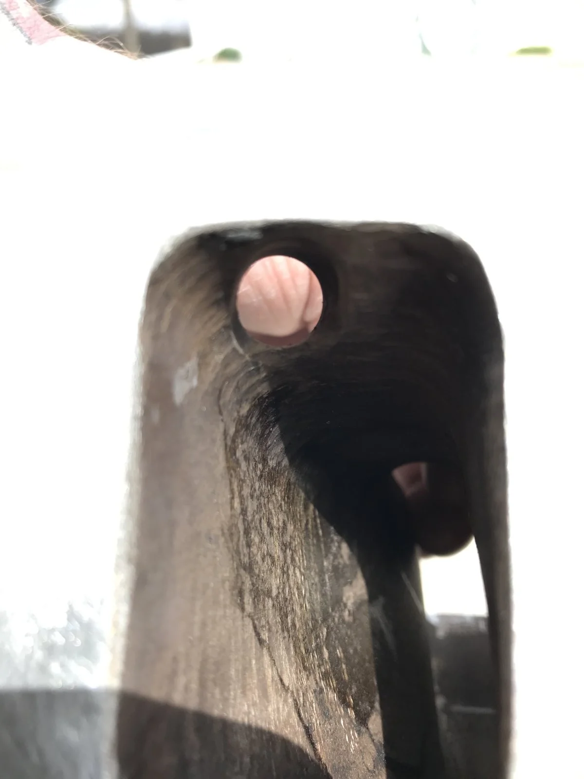

This leads me to another point. I have a MM pan hard bar setup sitting in the box in my garage, and the way I see it, it’s not going to fit with my current exhaust. I really don’t feel like redoing my exhaust again (except for the LX tips), so I’m going to sell it off. If anyone here wants it, PM me. I’ll match the out the door price from MM minus $25 (shipping included). I will never road race the car, and was getting carried away when I bought it. It’ll do burnouts and donuts well enough without it.

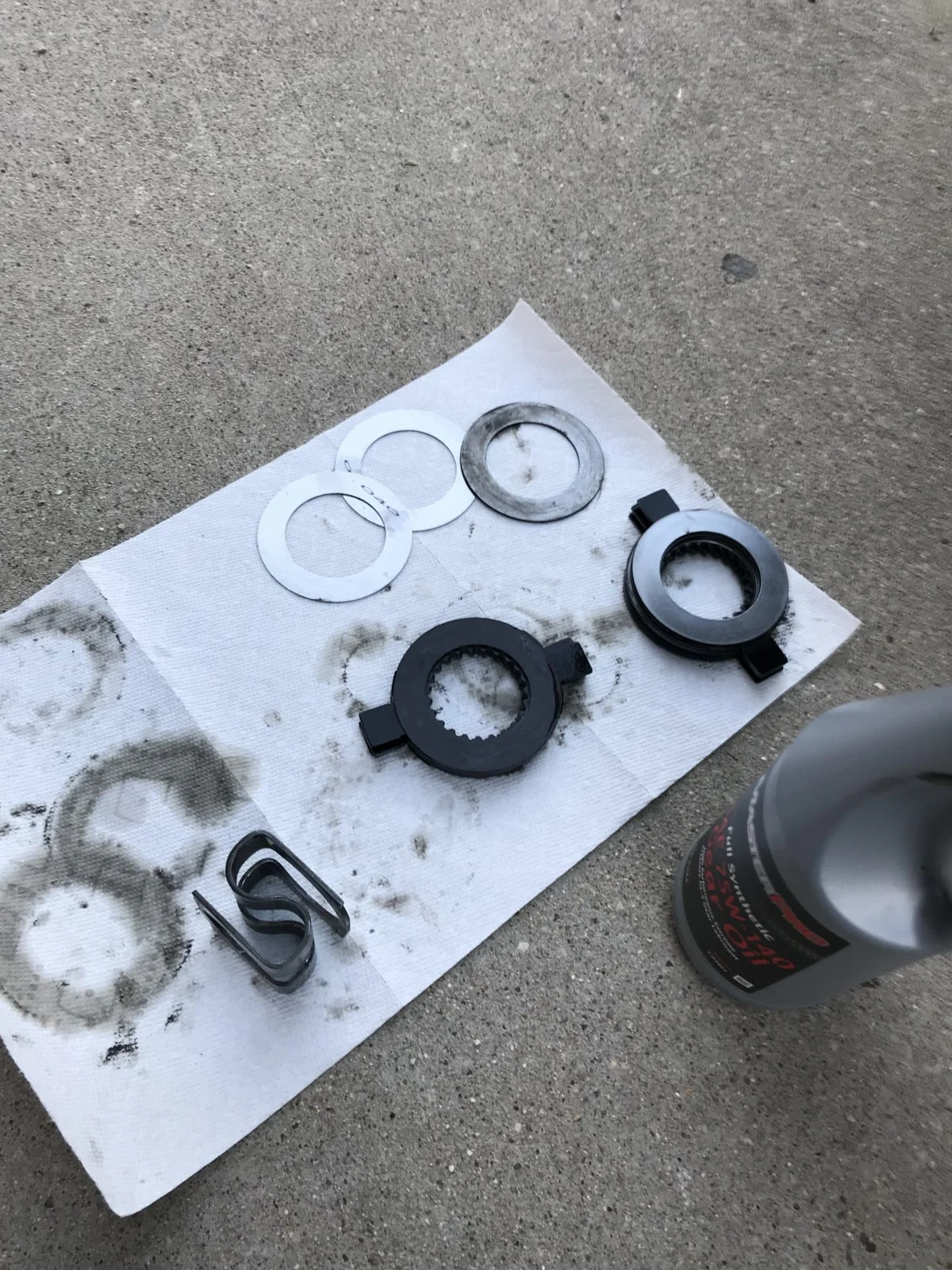

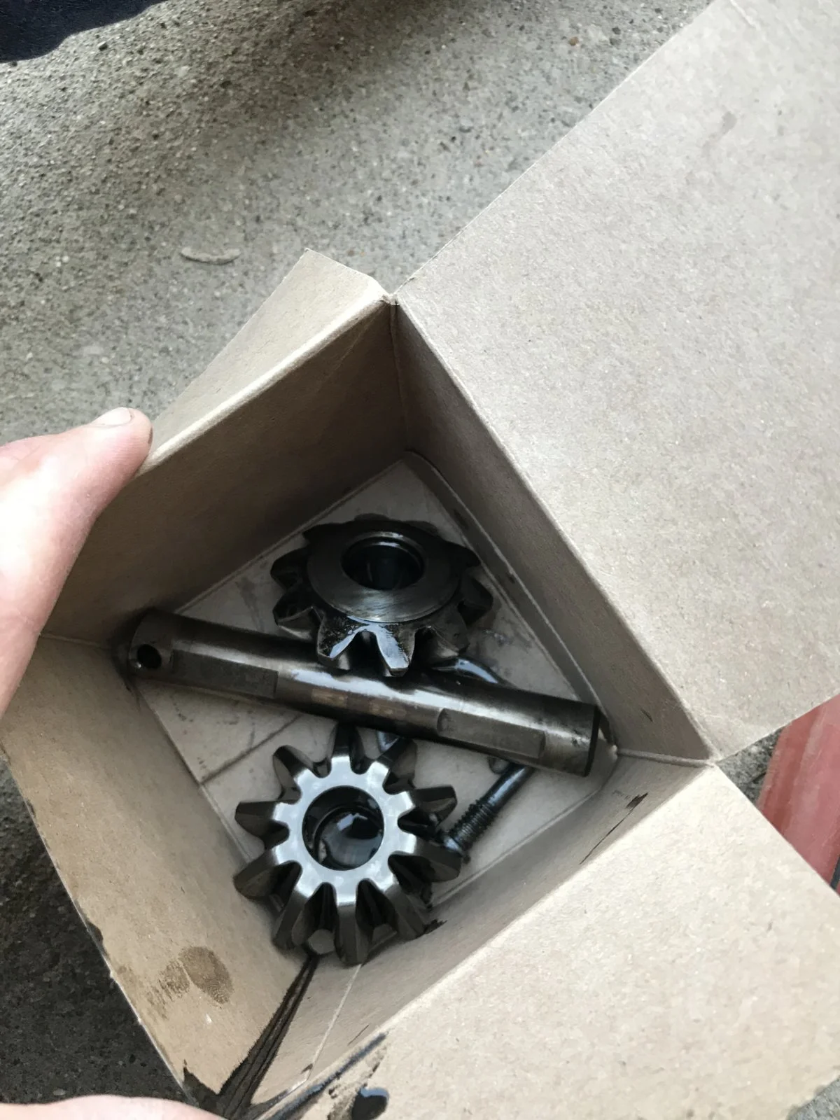

Ok, we’ll I got started on the 8.8 clutch work. It never goes as smooth as it should, nothing new there. Didn’t take many pics because it’s a messy job.
But after installing the new clutches and discs, and using the same shim thickness as stock, I can’t get the spider gears back in. My stock clutches were worn smooth, and the new ones are thicker being full of friction material. I’m going to youtube it and see what tricks are out there. My S clip is marred up, so I need to get a replacement.
Regular auto parts stores don’t carry them, so I need to hit up my one and only drivetrain shop in town tomorrow and cross my fingers so I can get the job finished tomorrow.
