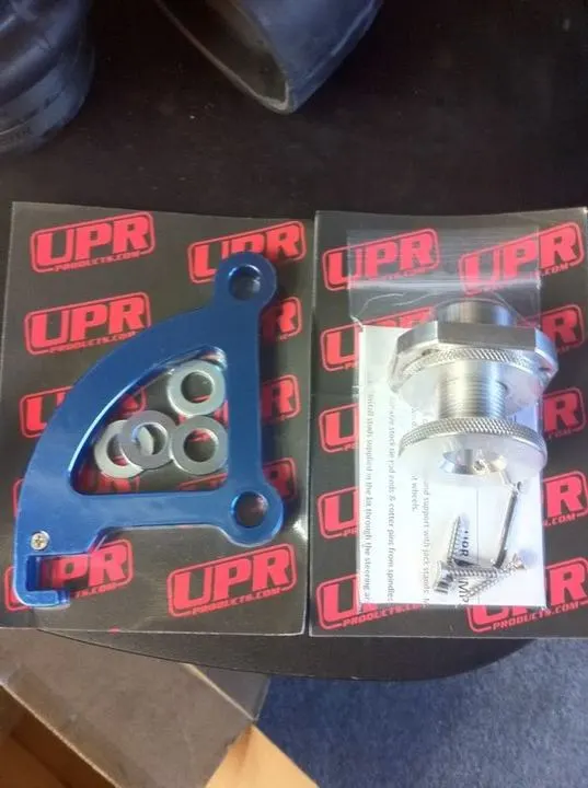

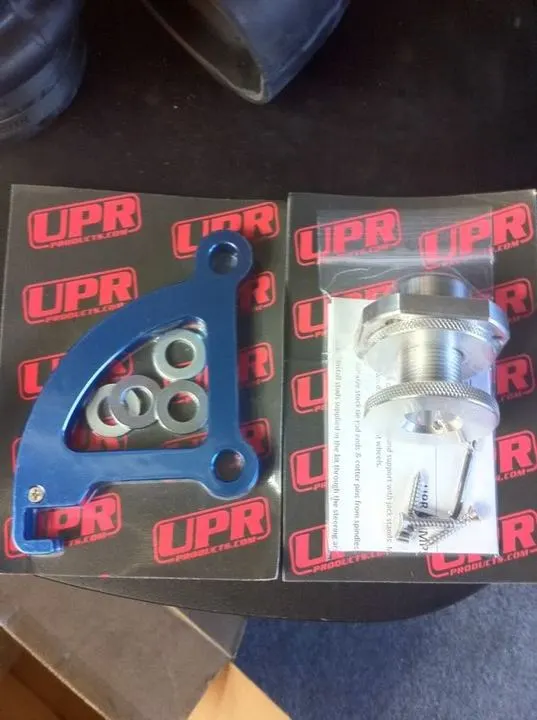

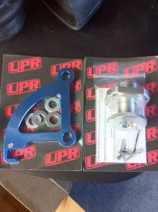

Got the new clutch parts in. Wanted to show you guys a couple pics.

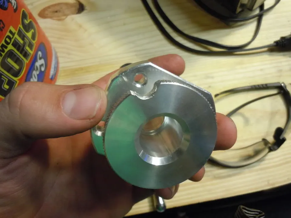

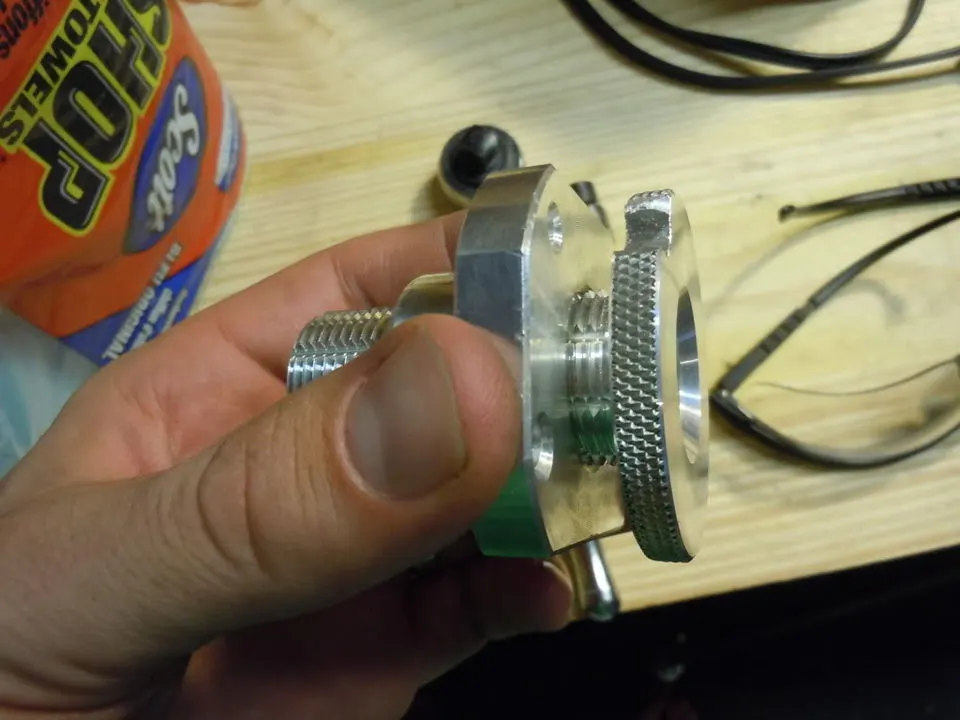

First off, this seems like a bonehead move on UPR's part. There seems to be no good way to install their firewall adjuster as-is. The rotating part with the knurl on it is too big to get a screwdriver past it to the mounting screw, but you can't install it without the rotating part in, because it has this tiny little spring plunger ball that will fall out if you try to remove it. So it's kind of a mess. I ended up grinding a chunk out of the knurl so I could get a screwdriver in there. Other than that, it seems like a decent piece.

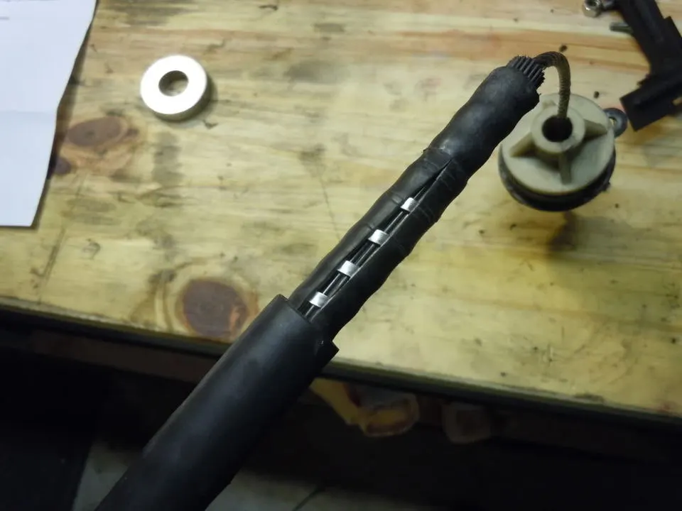

Check out my old clutch cable. Think this could be why I was having problems? :p

Yep. You can see in the pictures how the knurled section covers up the mounting screw holes, or at least interferes with any attempt to get a screwdriver in there straight-on. I think the ball plunger design is relatively new. It's a nice design because it (supposedly) doesn't require any sort of a set screw or a lock nut to hold it in place once you have it set where you want it to be. The ball plunger just pops down into the groove every 45 degrees around the thread, and provides resistance against turning.

Actually, I think that one there is the standard design. It has the "lock nut" that you spin against the base to lock it into place so that it doesn't want to thread in/out and screw up your pedal setting. That design will be easier to install, since you can remove the thumb screw/threaded section and just attach the base to the firewall without it, then spin in the thumb screw afterwords.
The problem with mine is that you can't fully remove the thumb screw without losing the ball plunger, so you have to install the whole thing together, which makes it impossible to get a screwdriver to the screw(s).
