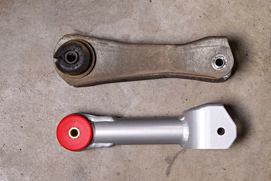

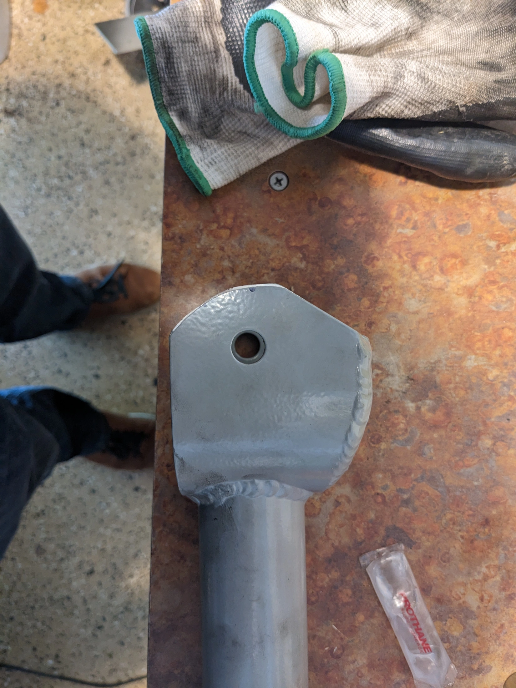

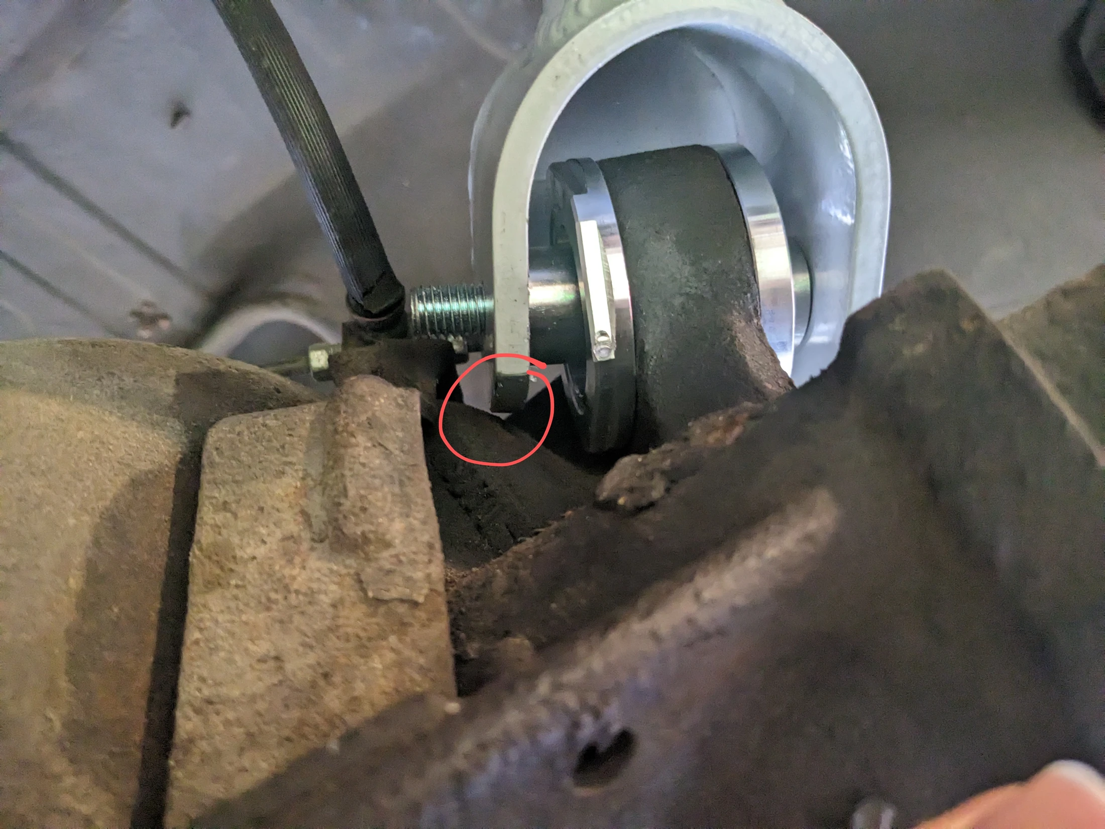

FastDriver said:
Nice upgrades. 8.8" rears can be out of alignment from the factory, and racers will often have them straightened and then the tubes welded & braced. I wonder if there's an issue with yours. I wouldn't overthink it, unless you're getting inexplicably strange tire wear patterns.
This was brought up in my discussions with Steeda. The car has never been in an accident and has never showed any symptoms of having something wrong with the rear end geometry, but I suppose it's possible. I lean toward it being more of an issue with Steeda's bulky and squared-off flange geometry, though. Their aluminum arms are larger in this area than any of their other arms.
This photo from Motor Trend (NOT mine) kind of perfectly shows the half-octagonal shape of the Steeda flange, VS the factory arm that is rounded in that area. The Steeda arm ends of being about 3/16" larger radially about the bolt CL, on top of not being rounded.
Here you can see where the interference was on my car (yes, the axle is crusty, no the rust isn't causing the interference Also, yes, I replaced that brake line.
Here's what the arm looked like after I "reshaped" it.

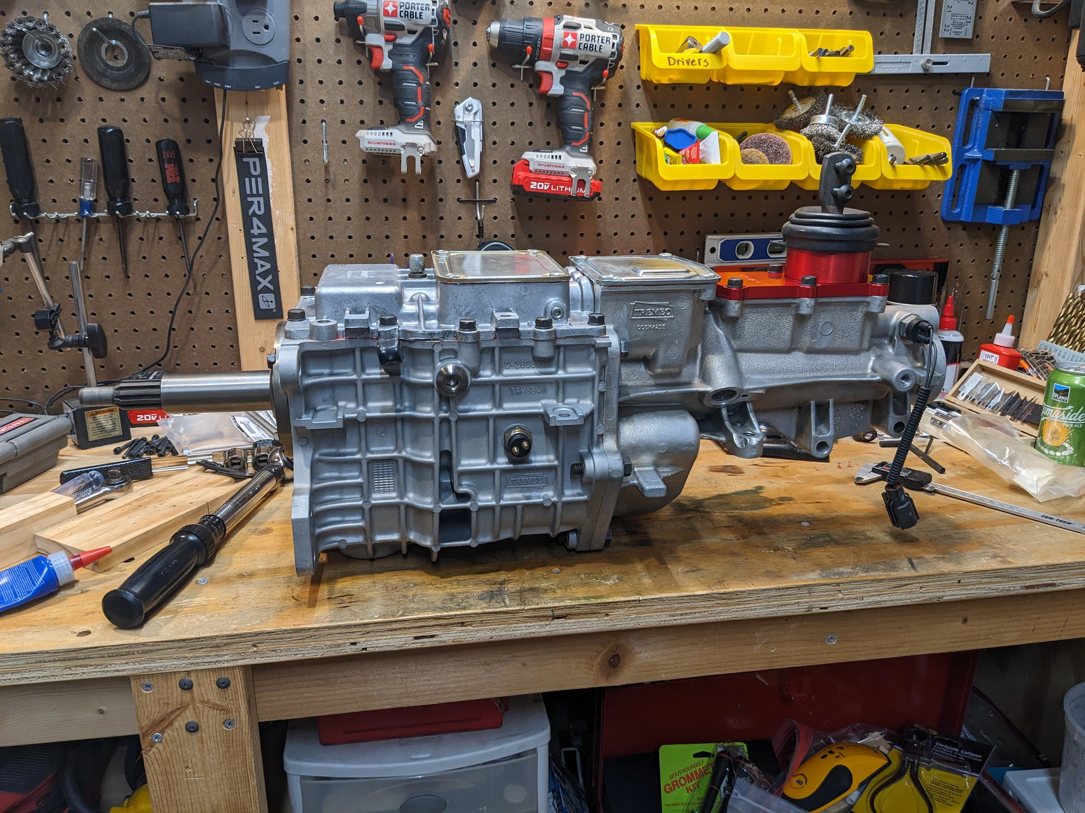

Anyway, this brings me to where I am today. As you guys can see from this thread, I built this engine 14 years and about 35K miles of hard use ago. It has held up (surprisingly) very well, but at this point the timing cover gasket and rear main seal have started leaving so much coolant and oil on the garage floor that I can't take it any more. Also, the leaky rear main (and my driving habits) has basically completely trashed the clutch.
It's kind of unfortunate, because I was planning on finally doing the 351 swap next year, but the I wasn't going to get another season out of this engine without changing these seals.
Also, my T5 died. For the 4th time. So, I'm going to use this opportunity to swap in the TKO that I built something like 5-6 years ago. It's a 500 that I bought used, probably around 2015, and fully rebuilt with carbon fiber blocker rings and a modified selector finger. That was back when I did all my transmission business with Astro Performance, which, as I understand it, has since closed their doors. I'm pretty sure I have photos of the full rebuild process around somewhere, but until I find them please enjoy this after photo of the TKO on my workbench.

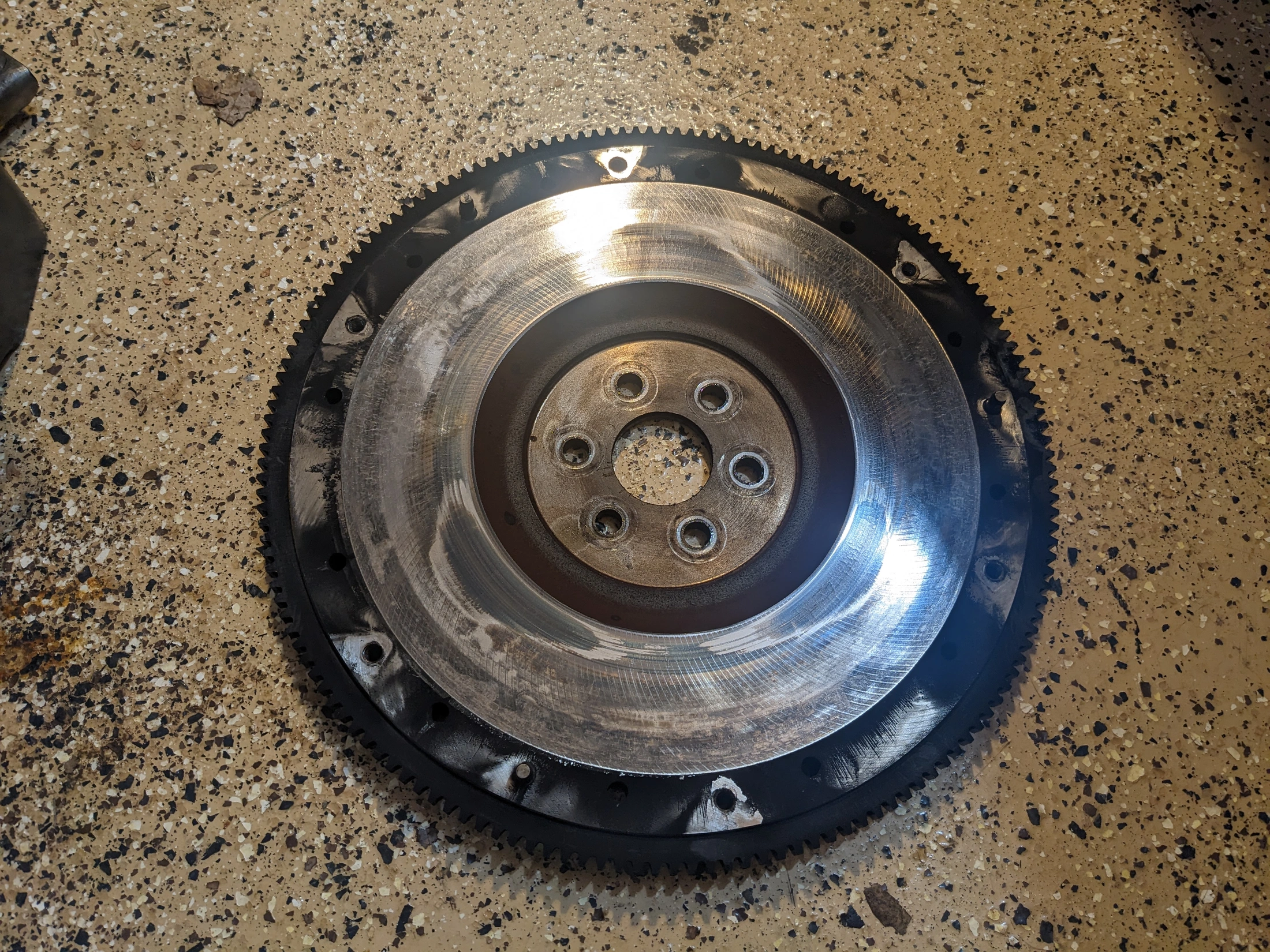

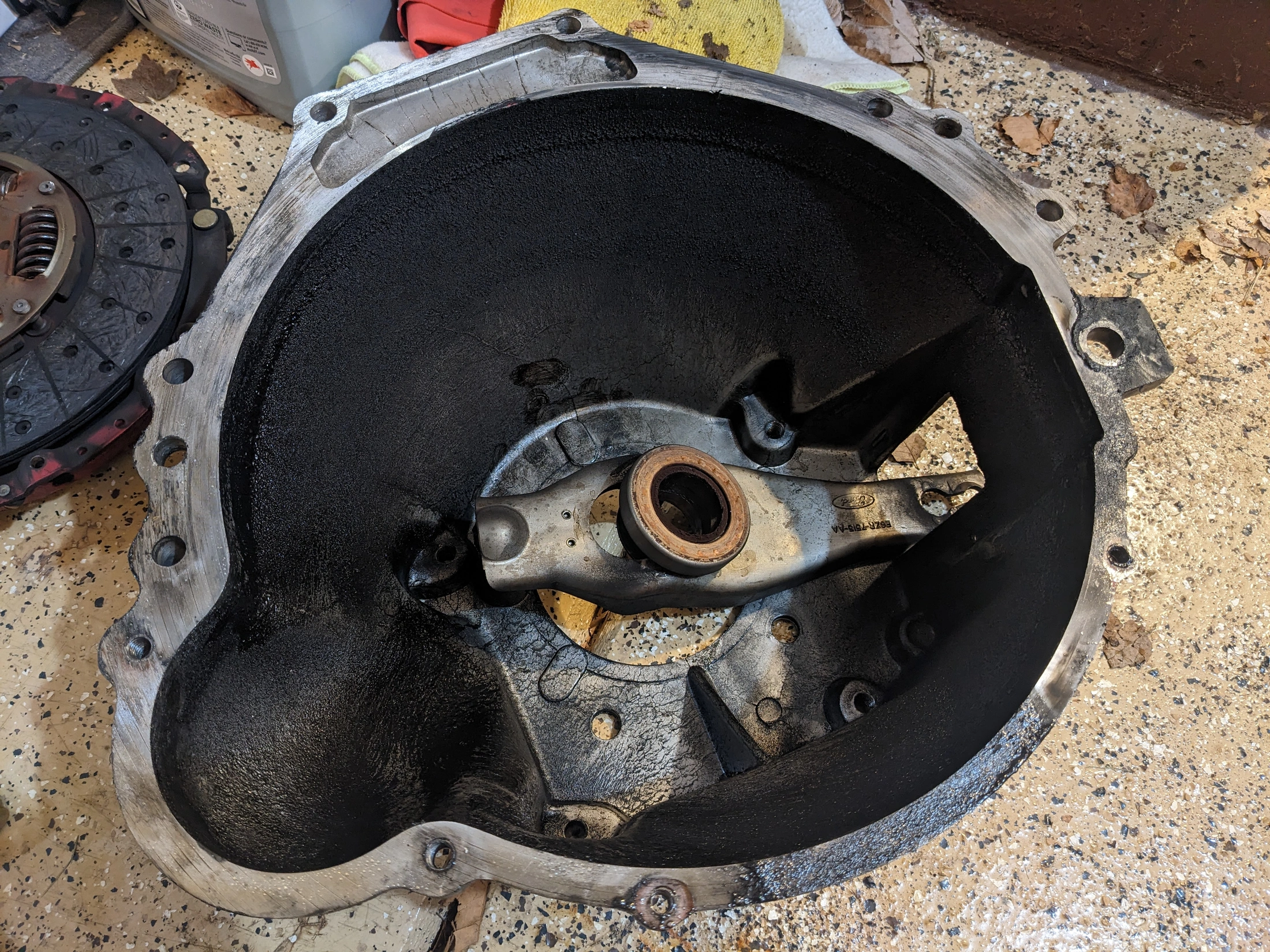

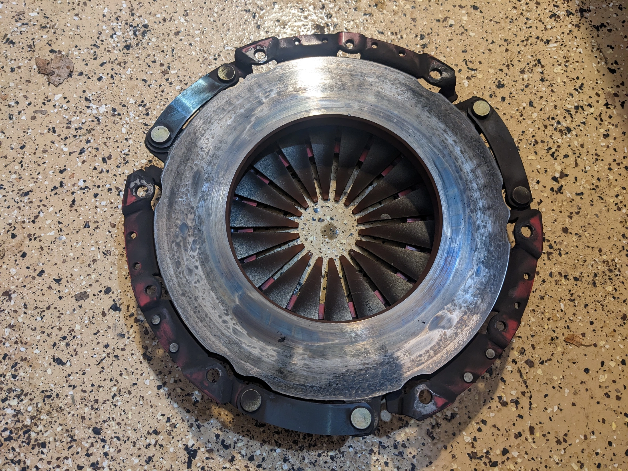

Here are some shots of the teardown.
Oil soaked bellhousing.
Roasted flywheel.
The pressure plate looks pretty rough too. I'm going to have the flywheel resurfaced and just try to clean up the pressure plate and squeeze another season or two out of it, with a new friction disc. The old friction disc was almost down to the rivets. This is a Ram HDX, BTW.
