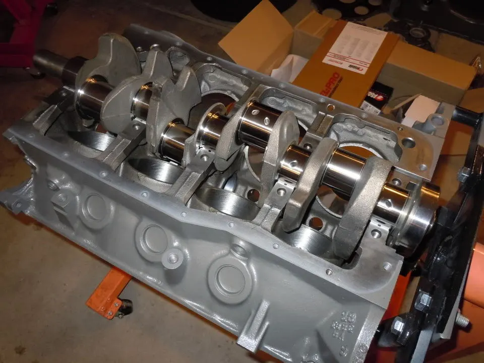

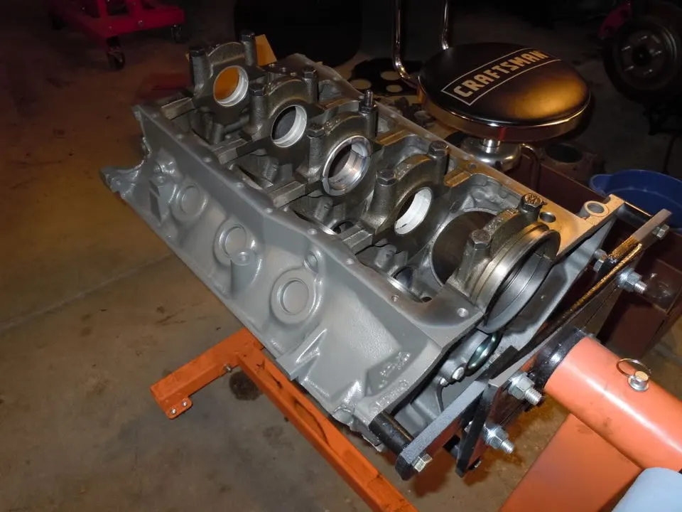

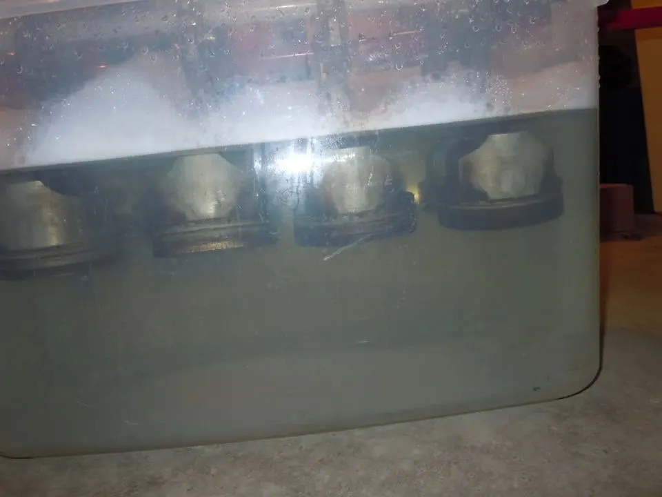

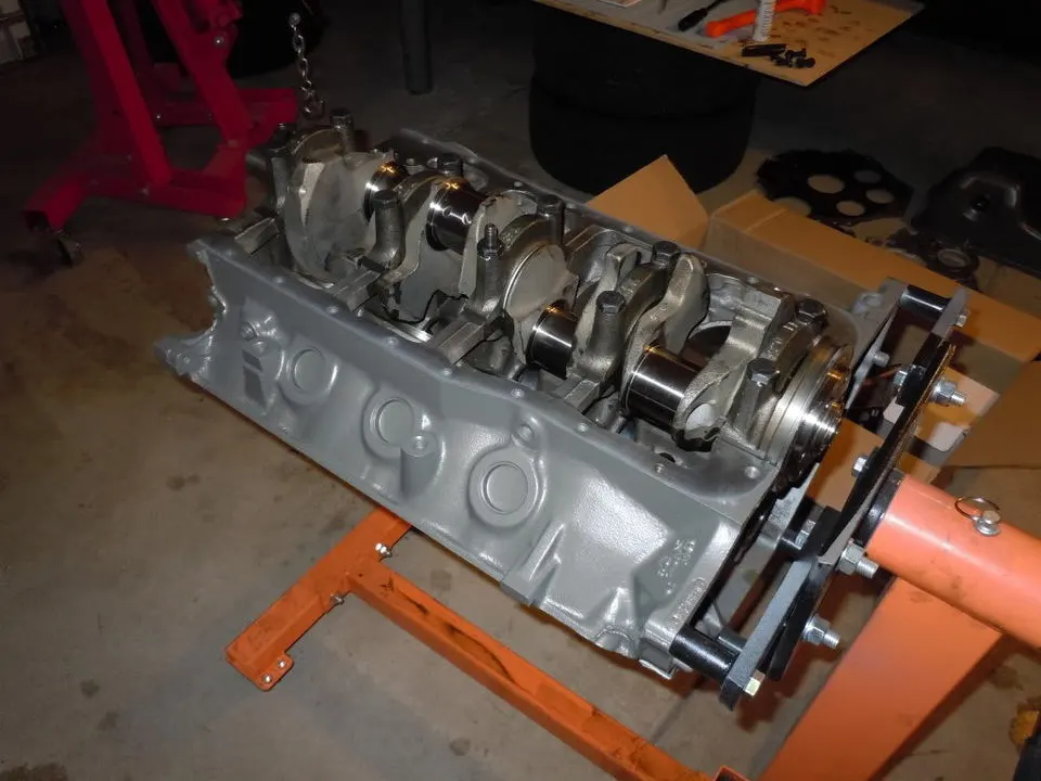

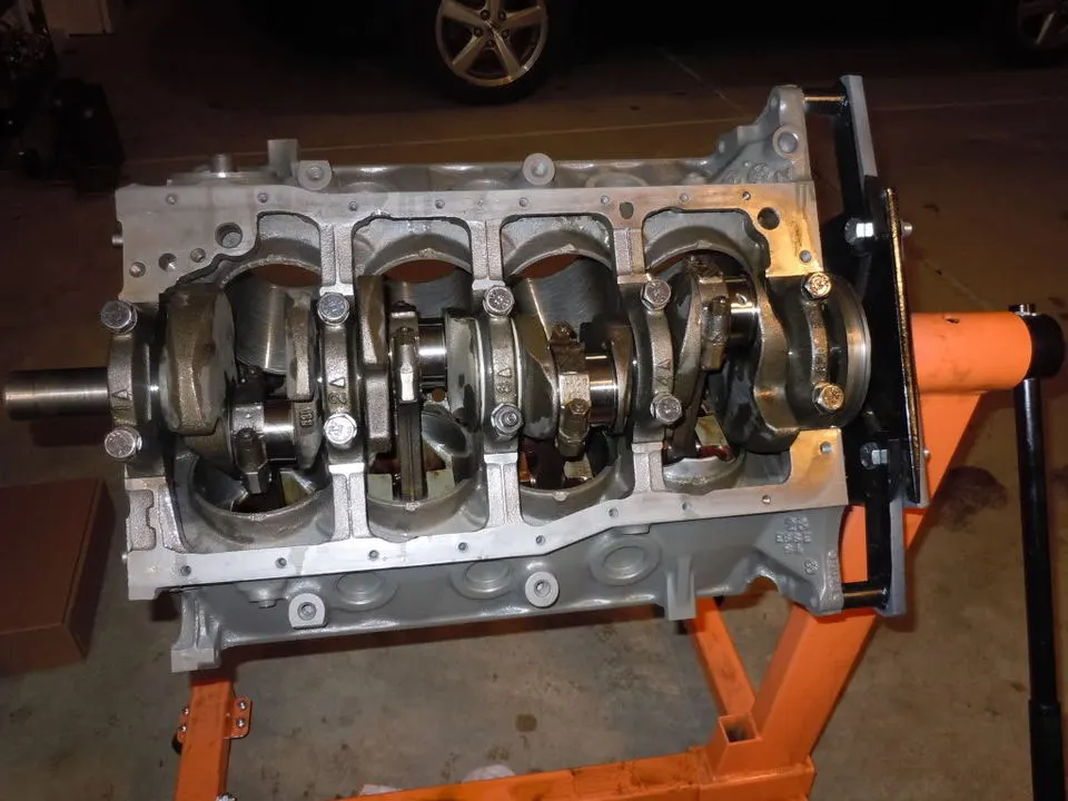

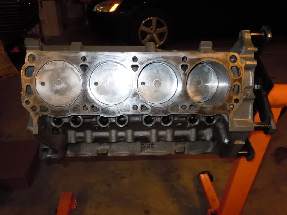

Couple updates for ya.
First off, I began assembly of the shortblock. Bearings in, crank in, plastigauge to check clearances, blah blah blah. Pickz:

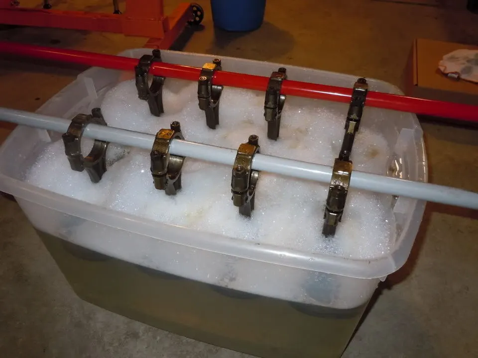

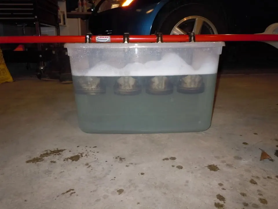

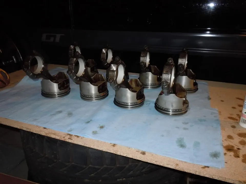

Up next, I needed a novel solution to cleaning the original pistons and rods. Did a lot of research on various degreasers, turns out most of them attack bare aluminum. Oddly enough, the best solution I came up with was a bath of hot... Soapy water. Some people were claiming that Dawn dish soap and hot water degrease well and at the same time it's safe for the metal and the environment. Well, ****. I'll try anything once. Pix:
It actually worked. Took a lot of elbow grease though, I'll tell you that.
Wish I had a pic of the aftermath, that pic of the bath was right after I put the pistons in. After I was done scrubbing all of them, it was BLACK.

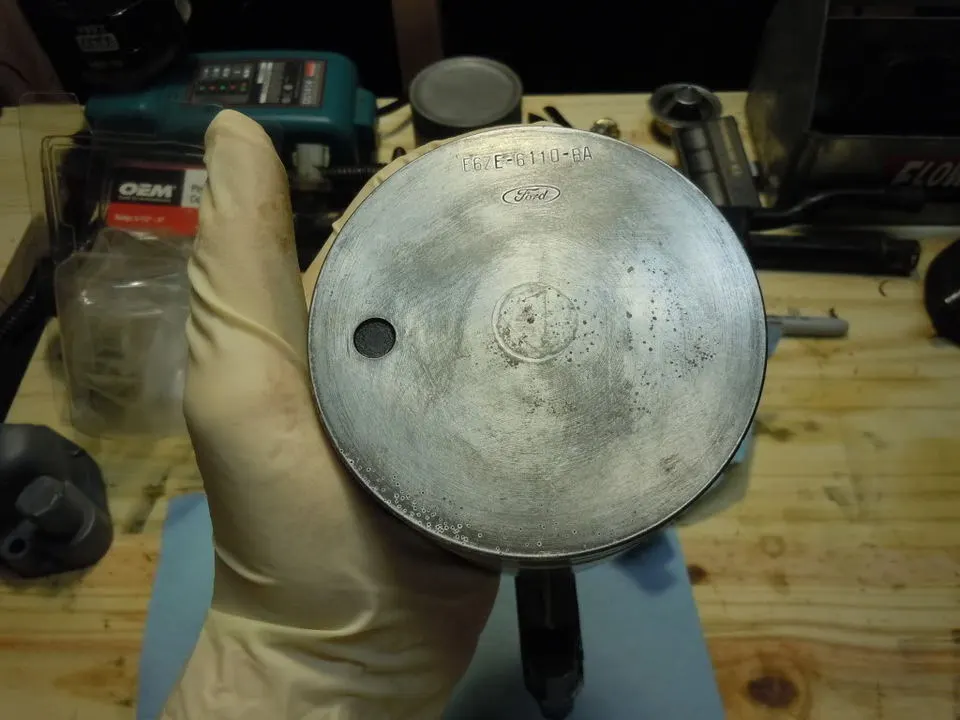

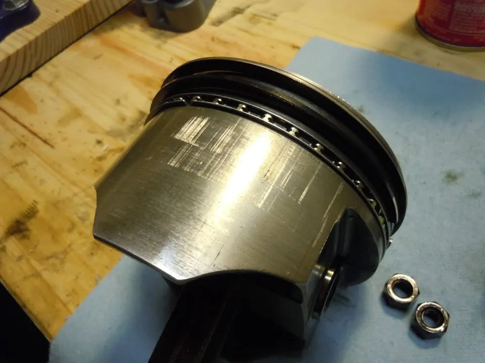

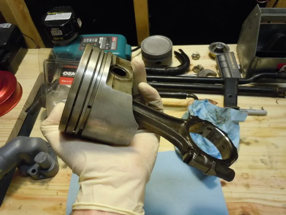

Now for the sucky part. Had my first mishap.
I picked up a cheap-o parts store piston ring compressor, and it's been nothing but trouble. The damn thing can't trap a ring to save its life, half the time I'm coaxing rings into the bore with my fingernails.
Well, of course on piston #1, I didn't yet realize how ****ty the compressor was. So I'm going along, sliding the piston into the bore, ASSUMING the compressor is doing it's job. I'm tapping the piston lightly with the butt of a dead-blow hammer, and the piston is sinking in a little with every tap. But then it stops. And I'm like, "WTF?" SO I go to slide off the compressor- but it's stuck. The ******* mother****ing piece of **** was trying to go into the bore with the piston. Of course, the piston-to-cylinder clearance doesn't quite allow that, so the thing was just wedging against the piston and scuffing the hell out of it.
AFTERMATH.
I'm irritated to say the least, but, live and learn. Thank God this wasn't a piston from a $2000 stroker kit. The damage is cosmetic at best, but I went over it carefully with some scotch-brite so make sure there were no burrs or sharp edges. Then I dropped that bitch in there along with all its brothers and sisters. If it blows up, it blows up. Fuggit. I'm ready to drive this thing.
Peeeektuuuuurs:

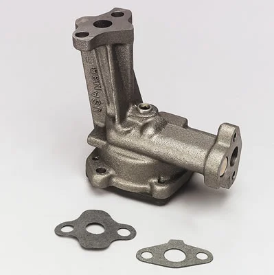

Well, another speed bump. Went to install the oil pump/pickup, and the LAST bolt I put in cracked the mounting ear on the oil pump in half.
Going to call Summit today and see if they'll exchange it for me. Kind of frustrating. It was a just a basic standard volume/pressure Sealed Power unit. I took pics, I'll upload them later today.

Hey guys, I was just checking out Summit's website, and noticed the pictures for the Sealed Power and the Melling pumps have the exact same casting identification on the side. This is also the same as the one I have. I have to assume that the same manufacturer makes both...? Anybody know anything about this? I'm looking at the Ford one, too, and I don't see the same casting ID on it, so I'm assuming Ford makes their own or at least uses a different manufacturer...?
Sealed Power:
Melling:
