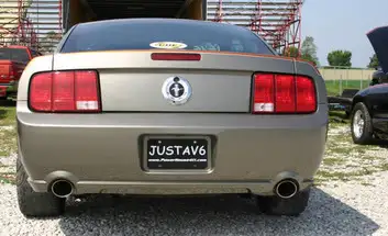

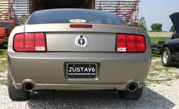

Our 05 V6 project car went 12.31 at 111MPH today at Norwalk. The DA was 3485' (by our weather station), and the weight on Norwalks scale was 3490lbs with the driver, right after the pass.
As you can see the car went a 1.81 60' on this pass, but the car typically goes 1.7. The downside is the spider gears in the T-Lok blew up on this pass, and due to the fact we have an 8.8" ready to go in we are done running the 7.5" for awhile. It is our feeling that with a stronger differential the 7.5" may still be sufficient. How long will the other drivertrain components last; we are unsure at this point; but I can say we will keep pushing the limits of this car. We will be at the NMRA event at National Trails Raceway with the car for anybody who lives close and would like to see the car. Here are a couple of pics from today, excuse the pole.
We can't went to start testing the turbo!

What turbo?
I have been hearing about a kit for the V6 but have not heard anything yet.

It should be under development right now.. Pwrhws is making it.. We're all anxious to see the numbers..
Keep in mind, the numbers you see with the Nitrous will be tough to beat.. A supercharger, or a turbo system would yield about the same type of power if not less with more strain on the engine..
The Nitrous setup while alot less expensive is going to be tough to compete with.. You have to figure the notrous system still is not maxed out.. To max it out would require some possible work to the internals.. So while we are all anxious for the Turbo system, how in the world can we overlook the nitro as a power-adder...?
