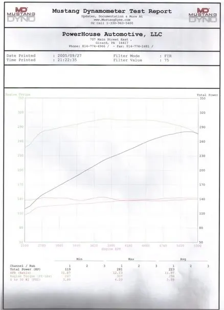

Single Turbo Initial Results
This is a graph from some of our intitial testing. Six pounds of boost seems to make very respectable power. There will be a lot more testing before final results will be released. Sorry for the poor quality, but a scanner and the shop don't go well together.

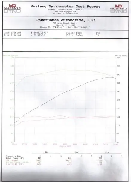

Is that 281rwhp? How about the torque? :hail2:
Yes Indeed it is Jimp!
If I am reading that right, it looks like 307 TQ hits around 3600 RPM. Looks like max A/F is 12.3.
Average on that Dynometer Test was 223HP/294TQ. With an average A/F through the bands staying nearly at 12. PERFECT! :hail2:
Mike, that is VERY impressive.... lol.... after one heck of a day, that is enough to make this lady smile!!!! :D
Very nice Mike.
Actually the a/f on that was a 12.13, but I understand, it's a pain to see.
We ran 9.5 PSI last night and with the same a/f power went to 320rwhp and nearly 360ftlbs. Off to Bowling Green for the weekend, we'll hope for the best. ANd i will post you some e.t. results when we return.
