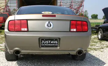

New Results
Our 05 V6 project car went 12.31 at 111MPH today at Norwalk. The DA was 3485' (by our weather station), and the weight on Norwalks scale was 3490lbs with the driver, right after the pass.
As you can see the car went a 1.81 60' on this pass, but the car typically goes 1.7. The downside is the spider gears in the T-Lok blew up on this pass, and due to the fact we have an 8.8" ready to go in we are done running the 7.5" for awhile. It is our feeling that with a stronger differential the 7.5" may still be sufficient. How long will the other drivertrain components last; we are unsure at this point; but I can say we will keep pushing the limits of this car. We will be at the NMRA event at National Trails Raceway with the car for anybody who lives close and would like to see the car. Here are a couple of pics from today, excuse the pole.
We can't went to start testing the turbo!
